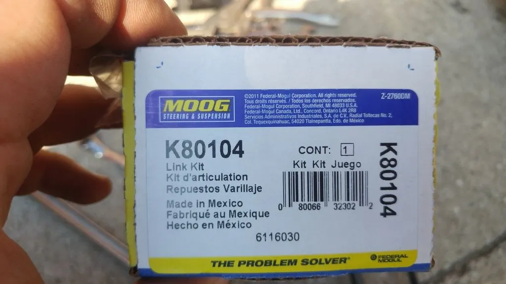

Maybe. Part number was one I found on here in multiple threads. K80104 for 01-04 Escapes.

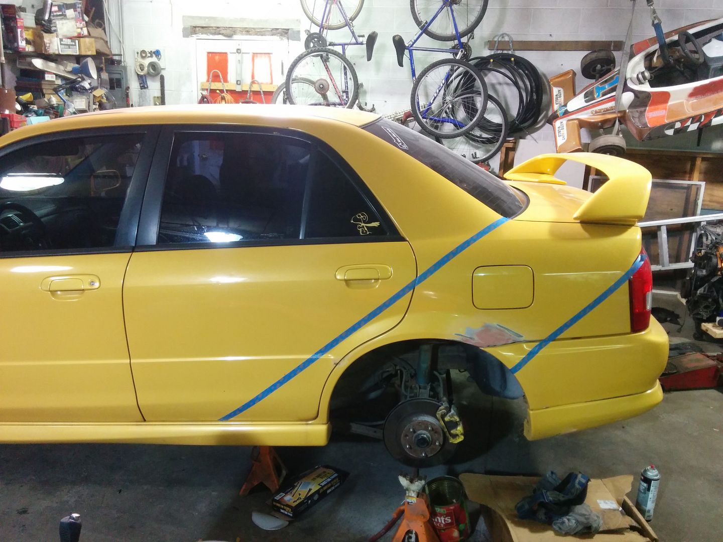

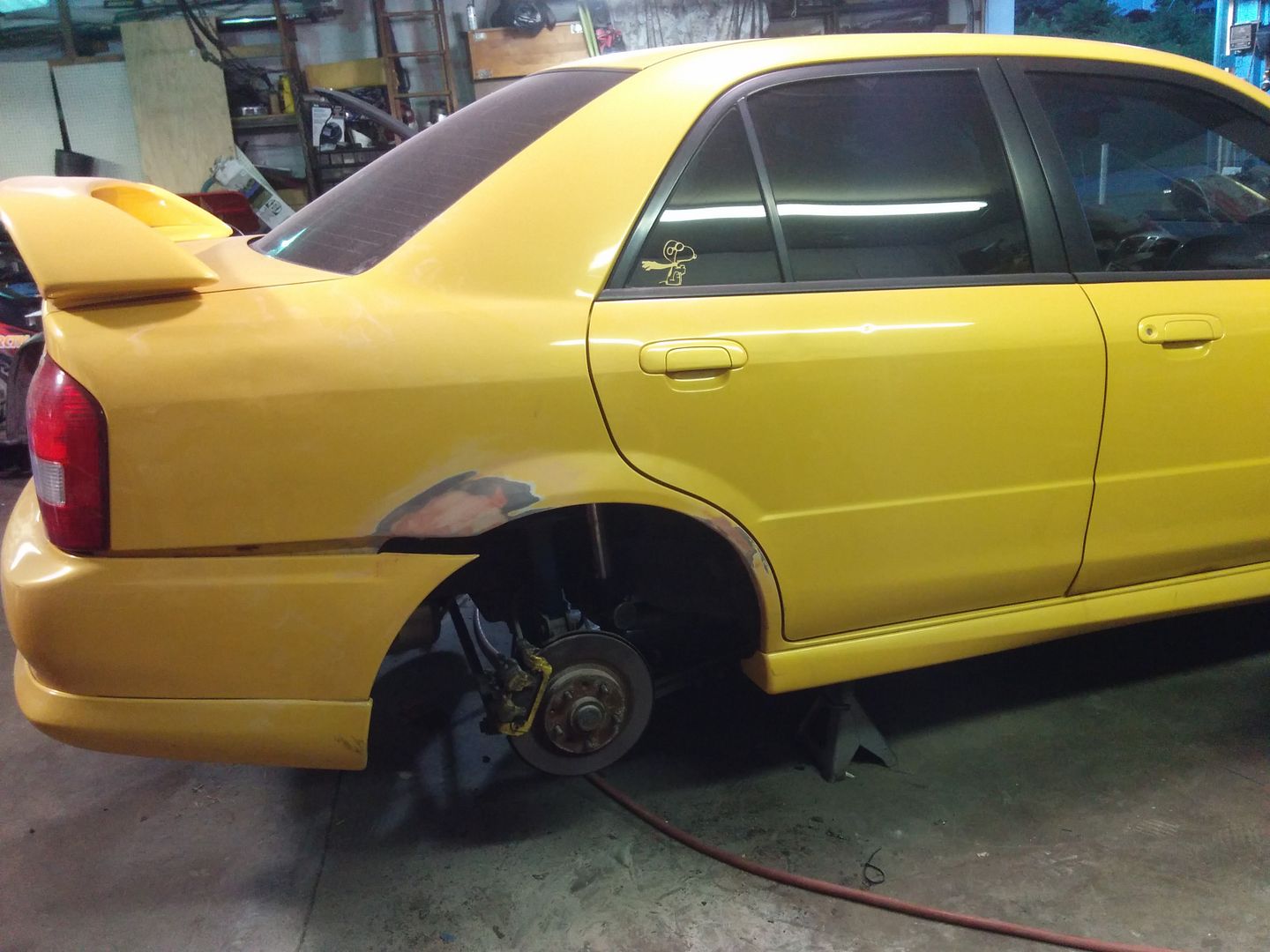

I've been quite busy restoring Blazing Yellow MSP #249 back to it's glory. I started by cutting out the rear wheel well rust and welding in fresh sheet metal:
