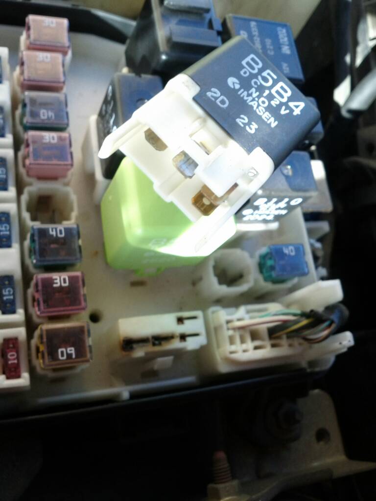

Figured this would be the best place to ask for help. Car sat unused for two weeks. Went to go start it and the battery was dead so I jumped it. The car started and ran for about 15-20 seconds and died. I disconnected the battery for ten minutes or so and went to go start it again. At this point I noticed the fuel pump didnt prime. The car started right up and ran for about a minute before it died. Now the car will crank but wont start. The fuel pump is still not priming and the fuel level is not moving. The car had half a tabk when I parked it. Any suggestions?
Check your fuses and fuel pump relay. You can bypass the harness and try to 'jump' the fuel pump with some wire to see if the pump is dead
I've checked the fuses already, but just to make sure I've gotten mixed answers regarding which relay is the Fuel Pump Relay. Some have said it's the green one others say is a black one. So which one is it? It's not labelled properly on the fuse box. Thanks for the help as well.
It's the one closest to the strut tower.

That means its not this one then right?

Yeah that's the one.

So replaced the fuel pump solenoid and the fuel pump still wont prime. I can hear the ecu click everytime I crank it. Already checked all other fuses and none is blown. Im starting to think the fuel pump went out.
