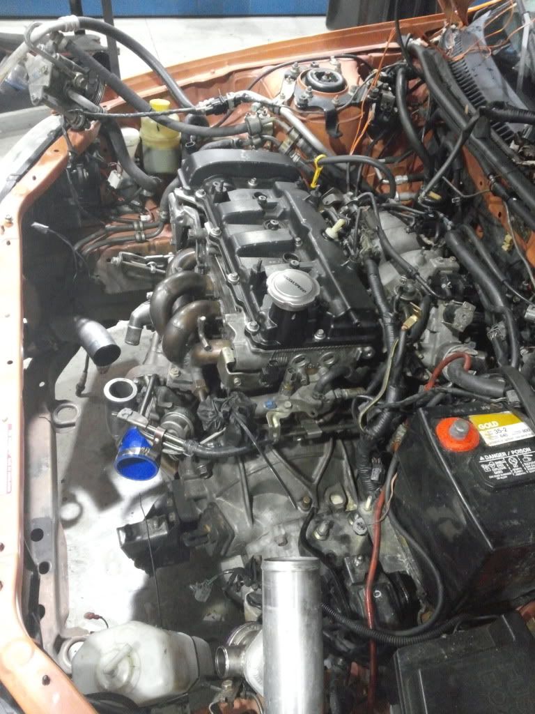

Engine is in. I've got another 2 hours or so before it's done. I'll be busy the next 3 days, but it WILL be drivable this weekend!

Today is the day that I will drive the MSP home from my shop. I hope. Not installing the 440s until after engine break-in so I don't have to worry about washing down the freshly rebuilt engines cylinder walls trying to tune for them. At this point it's just plug everything up, install the radiator, fill fluids.
