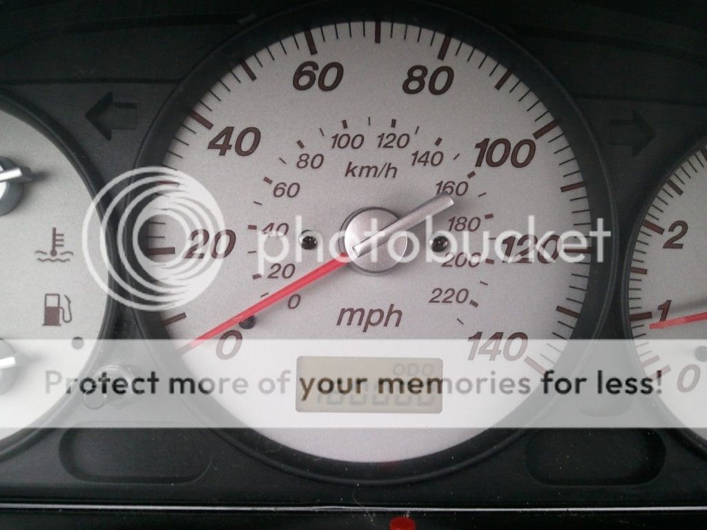

just hit 160,000 on the OD
OH and I forgot to mention, it's all still original drivetrain
