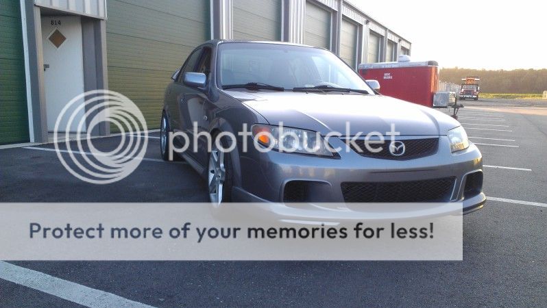

What did I do today to my bucket... well today I "fixed" my bumper. Its not the best but it sure does beat missing a complete mouting tab!
slap a Band-Aid sticker on it!
I thought about a sticker but not to sure if I want to do that or not. Im not to fond of the band-aid sticker myself but like the concept of covering up crap with it. lol
