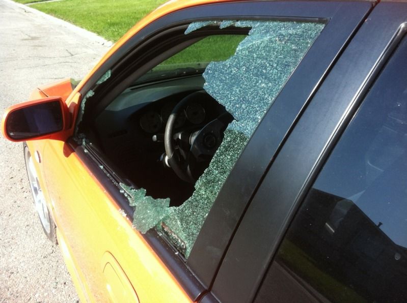

Sometime last night someone decided to help with weight reduction!
Brett.

Yep, good way to start the weekend! Ill have to head to the wrecker and find one tomorrow since were looking at big thunderstorms starting Sunday!

Didnt take a damn thing, door was still locked. Stereo is still there, Ipod sitting in the cupholder. Somebody just thought it would be funny I guess.. I can tell you I wasent laughing..
Brett.
Brett.
I don't blame you. I would of been pissed but at least the silver lining is you dont have to replace anything but the window. However cleaning up all that glass is going to suck.
