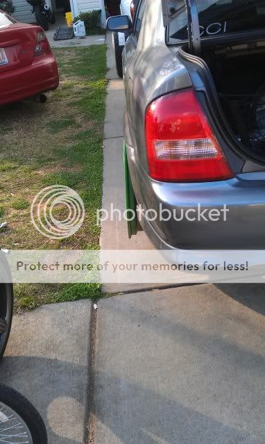

First off I'm running like 1.5 degrees camber in the rear(in spec) the bore size is just to small for the car so the wheel looks like it has more camber than it does. So it looks like it has more camber.
