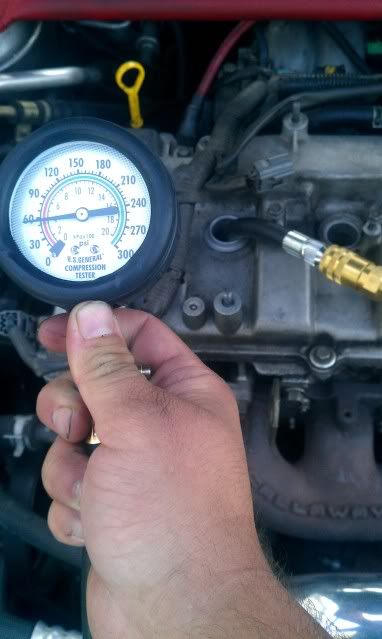

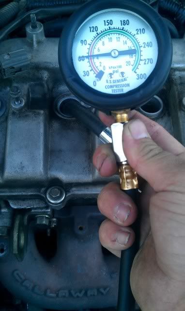

compression results.......
cyl 1
cyl 2
cyl 3
cyl 4
yeah.......kinda low lol
yeah it does suck
