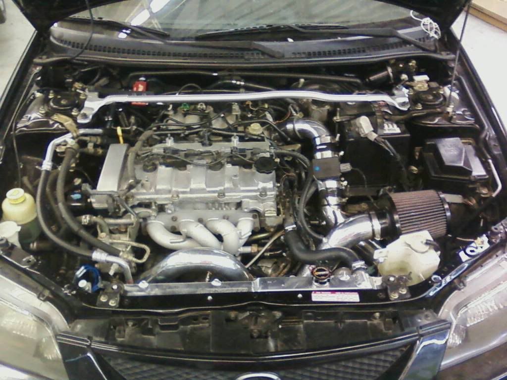

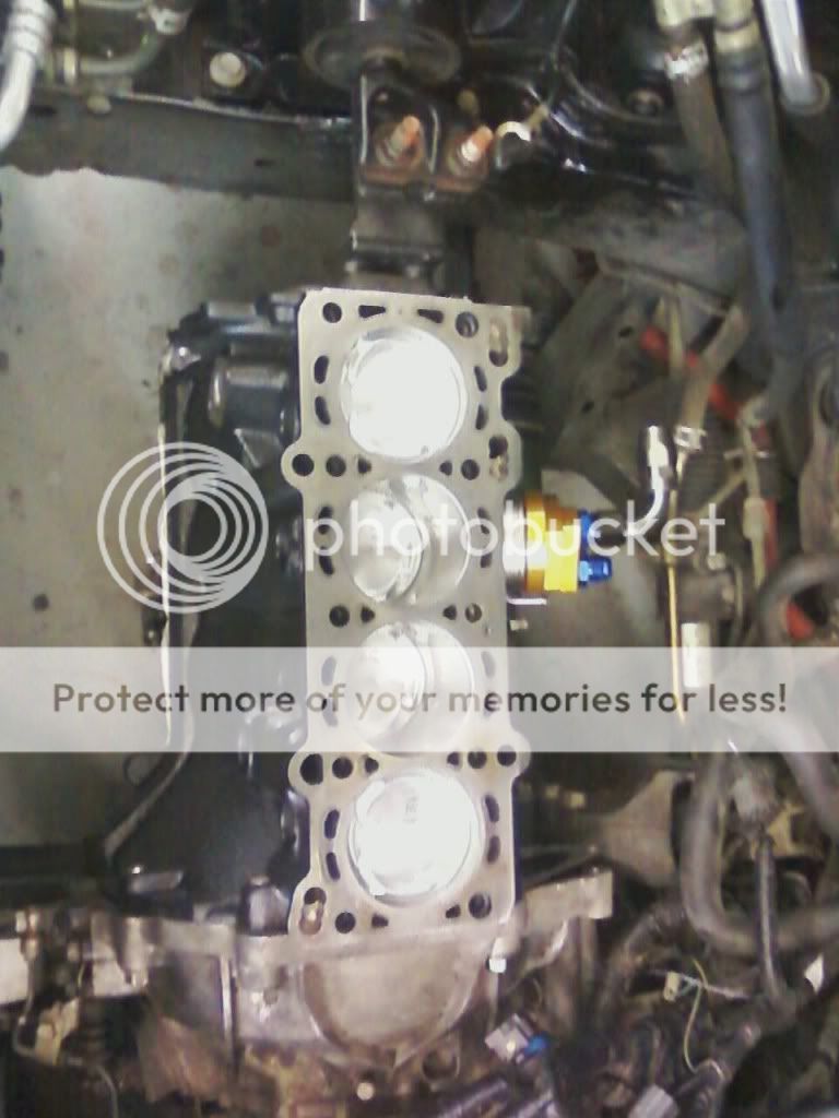

Well, after a long while... my MSP fired up! I spun a rod bearing earlier this year and it has been under the knife.
Went with Wiseco/k1 combo, acl bearings, all arp hardware, doc b oil pump with external valve, and all the small odds and ends.... here a few pics!
very nice. Overbore any? did you go with the stock crank or the long rods and stroker crank?
nice! any pics of the routing of the oil lines?
When i get the car back home i'll take pics of the whole system, you can see the red External PRV in the 2nd pic attached under the strut bar in the top left.
