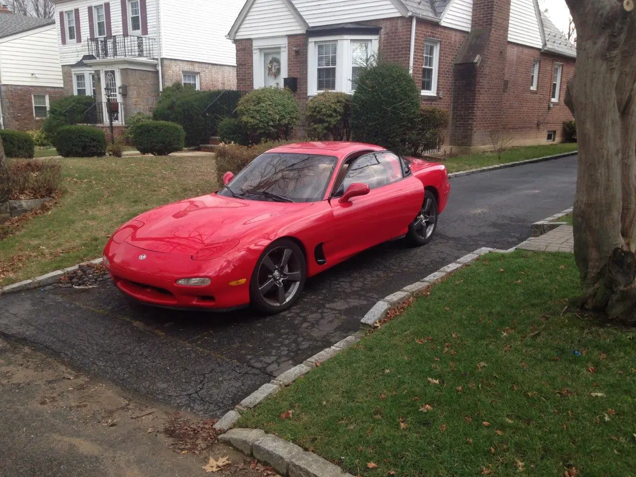

Yea actually. Many parts for sale. But it's a pain in the ass on this website. New whip has only 2 seats
new toy
attachment.php
Are the words " I hate you you filthy bastard" too much?
How about " I lust for your toy"
My bucket list. Your real life.
envious and delighted for you!!
that is what a Mazda go fast freak wants.
