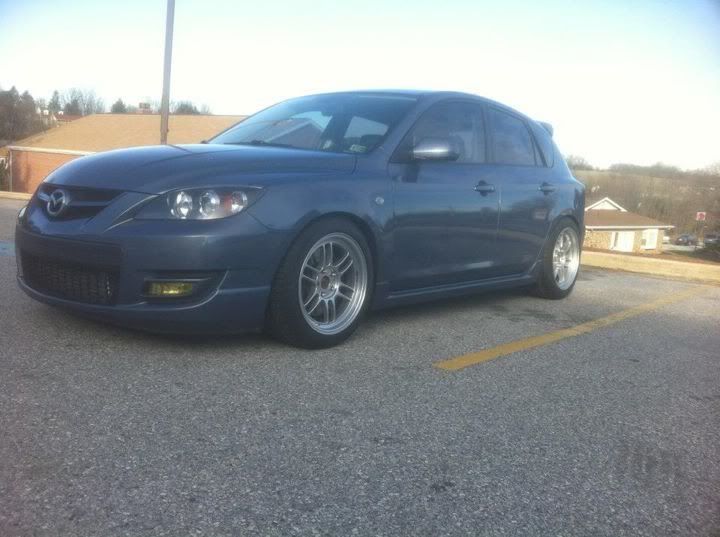

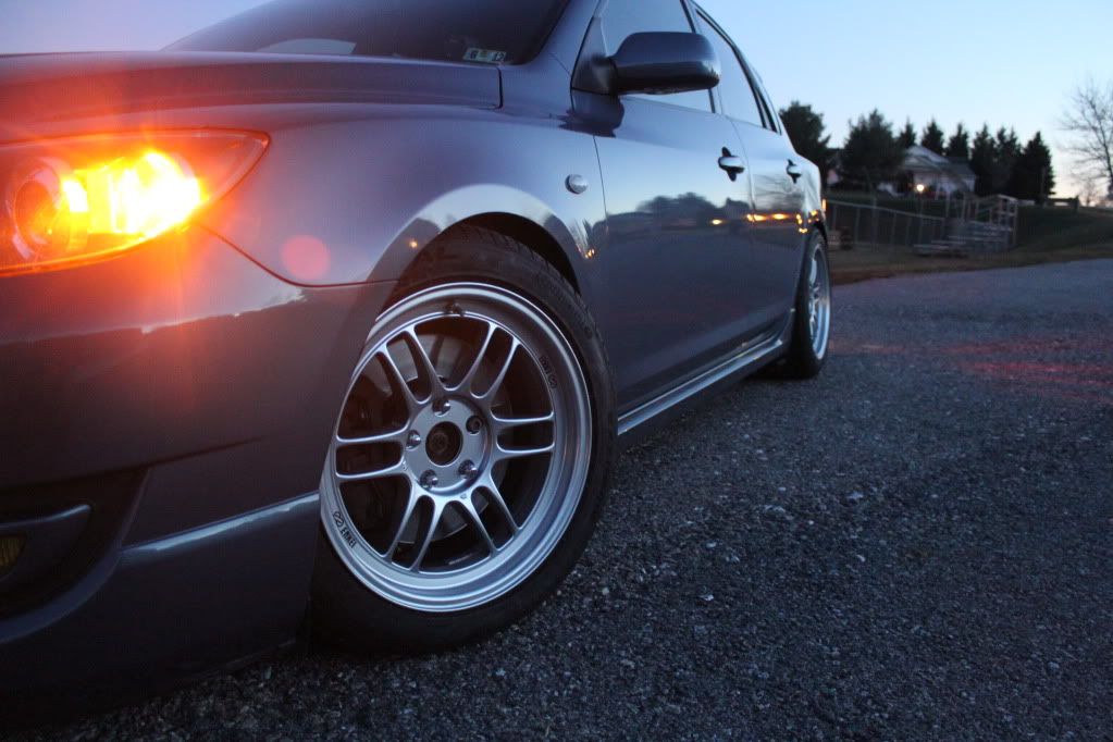

taf wheels look awesome!
taf0422... car looks great! What size tires did you go with?

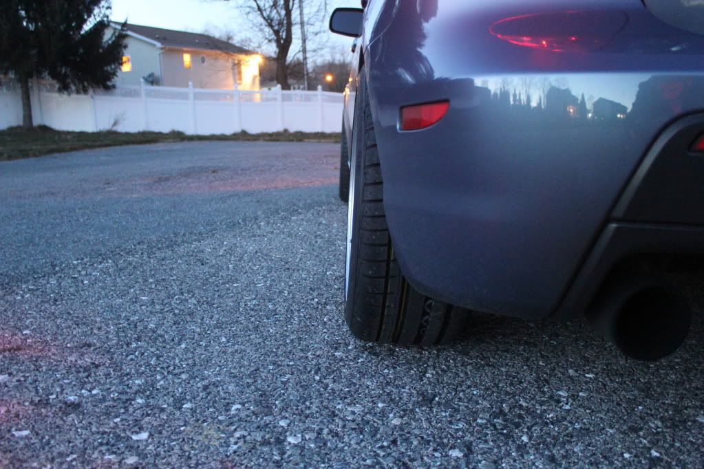

I decided to go with 235/45 r17. Extreme contact dw tires. They were a pain to put on with their thick sidewalls. Will be going with 245 next time. Rear fenders had to be rolled almost flat bc it rubs with people in back. Running koni yellows and h&r springs. Everything cleared the strut fine but I did buy 5mm spacers for the front and I bought the center caps as well just not a huge fan of them.
Thanks for the run down, I've been on the fence about putting mine on, they're 18x9 +35 that I had on my Subaru. Seems like it's going to take some work to fit them the way I'd like...
Depending on what year Subie, the center hub bore is different. Might want to check into it
lol. yep you are definitely going to have to check into that. The subaru depending on the year will have a smaller hub bore and would have to be machined out to make it work.
