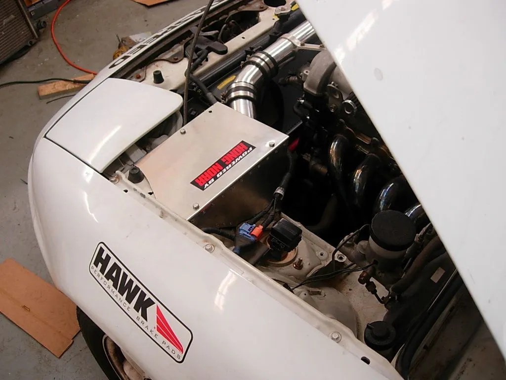

I completed the quickie airbox tonight. Previously, the filter was placed pretty close to the exhaust manifold inducing a bunch of heat soak, especially in the summer. This will suffice for now. I need to have the tubing tig welded and I'll be wrapping it in header wrap to further reduce heat soak. The box is double layered aluminum with an air gap in between. Air is drawin in from the headlight area. I was going to add matting, but couldn't find anything thin enough.
I completed the quickie airbox tonight. The filter was placed pretty close to the exhaust manifold inducing a bunch of heat soak, especially in the summer. This will suffice for now. I need to have the tubing tig welded and I'll be wrapping it in header wrap to further reduce heat soak. The box is double layered aluminum with an air gap in between. I was going to add matting, but couldn't find anything thin enough.
dude, that thing looks bad ass!
