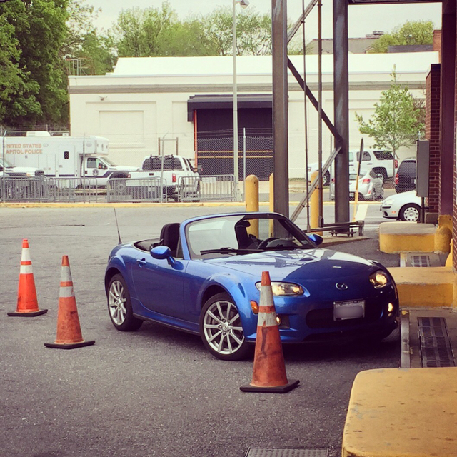

Took bae to her first autocross... Ok, actually it was the DC inspection station. No line on a Friday morning, nice!

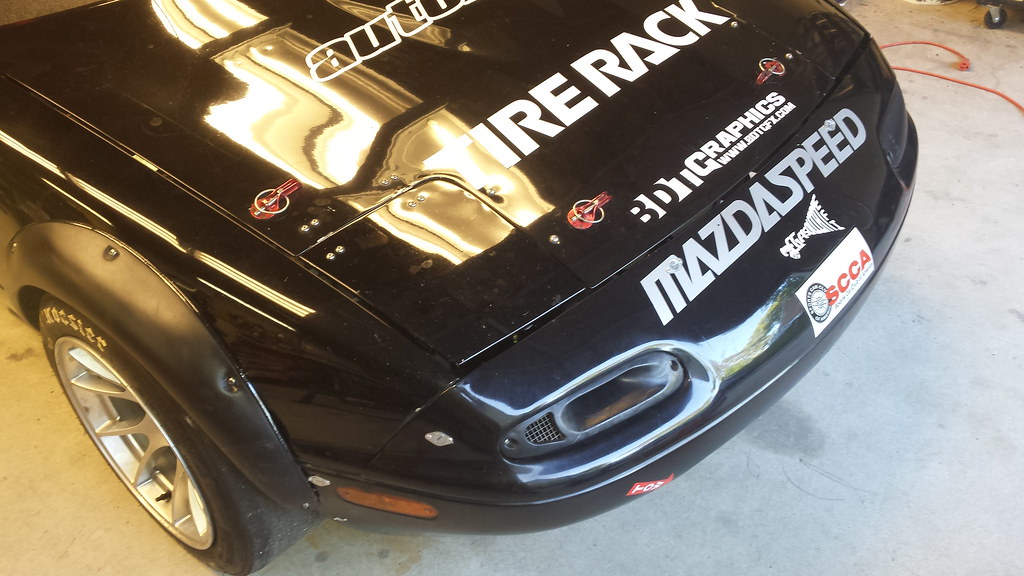

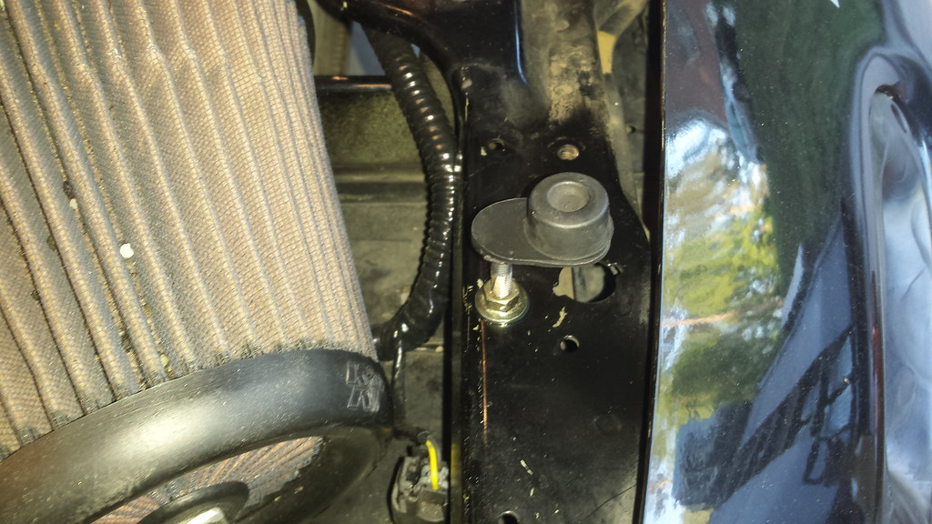

Whipped up a pair of 'bumpers' to support the steel barndoor covers, as their unsupported weight was creating quite a bit of droop at the corners, and causing the center of the hood to bow up about an inch under any aero loading. Used a pair of rubber hood (or maybe trunk?) bumpers I found in my bolt bucket and fabbed a couple brackets:
No more droopy (eye)balls!
thats awesome!!

hows the hinge/stopper thingy working???
It became clear that the clearance was too tight and it was locking out 3rd gear (which is the opposite of what it should do lol), so we flipped it open and ignored it the rest of the event (see me lose a full second shifting the 3rd in the video). So I took it off and shaved 1/8" off of it on the belt sander yesterday. Unfortunately there's no guide that says how close it should be, and no real good way to test except for bringing it to an autocross and seeing what it does at the top of 2nd.
