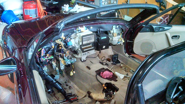

With all the rain we've been getting here I haven't been able to drive and tune, so decided I would accomplish something else today. I swapped out the dash (the lower, parchment colored part) for the one I bought a few months ago. As a reminder, this was to get rid of a hole a previous owner drilled to mount a cupholder that I no longer use. It wasn't horrible, I took the time while it was all out to tie up some of the wires under the dash. It appeared that the antenna wire orientation had been changed around (this always caused me problems when pulling the radio as the wire was too tight) so I moved that so it was routed better. Also vacuumed under the seats, if you haven't done that for yours I would recommend it. You would be surprised how much crap ends up underneath, even if you try vacuuming from the front and rear of the seats you can't get it all.
Couple of hints when removing a NB dash. Go ahead and pull the steering wheel, the shifter and the e-brake handle. This makes life a lot easier. You can leave the passenger airbag bolted in place, it will come out with the dash. Remove the screws holding the fuse panel in place and move it out of the way. There are two big square electrical connectors (one black, one white) that need to be disconnected on the driver's side, and three on the passenger side (including the one for that airbag). You also need to disconnect the antenna cable, there is a short piece that goes from the radio to the cable from the antenna where it comes up by the shifter.
