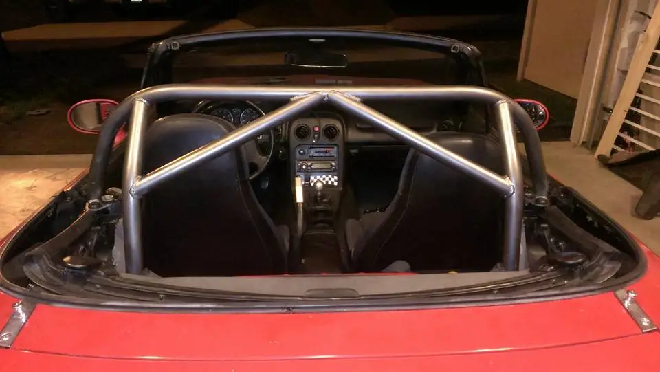

This week I:
painted my roll bar
took the soft top and frame off of the car
removed the cracked rain rail
installed an uncracked rainrail
installed the rollbar
reinstalled the soft top and frame
tested that for leaks
found two
realized I'd riveted the top to the rain rail in such a way that the back side of the rivets were probably causing the leaks
unbolted the top all around the rain rail
removed some of the rivets
reversed some of the rivets
reattached the top all around the rain rail
found one
added nylon washers to the studs, between the outside of the rain rail and the top
found none
did a happy dance
pulled the driver side carpet over to the door sill again, stuck it down with gaffer's tape (under the trim) in hopes that it won't come loose again
re-installed my seats, center console, etc.
padded the roll bar
drove it to work today!
Smiled a lot!
