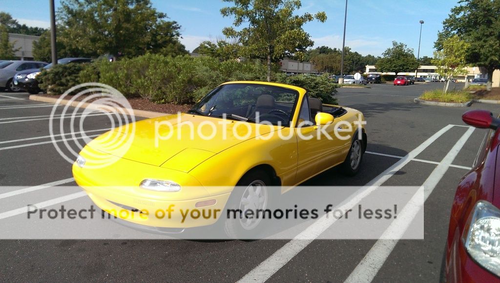

cleaned mine up saturday
Love your sunburst! If I got another Miata it'd pretty awesome to find a clean yellow NA!
