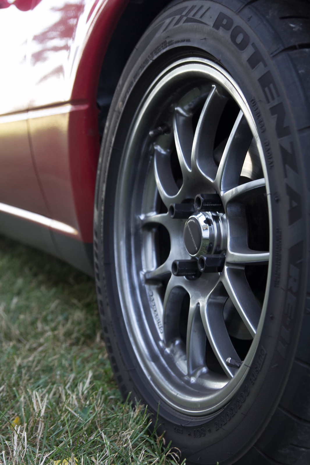

I has a set of A6s I got from Bill, I need to mount those and get hub center rings and lug nuts. I'll be set after that but I'm not using them right away (even though I really really want to), I did great yesterday but I'd like to get a couple more events with daily tires for better car control

They are used, you can see on the inside that tires have been mounted before.

What is the actual tread width of your 205's?
My 205 RE-11's would be great on an 8" wheel as the tread is 7.6" wide.
^^^This. Depends on the tire. Some are narrow as all hell, some fit just right on an 8".

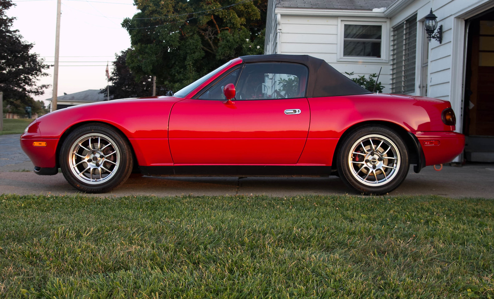

But I did get an install some fancy custom center caps for my new 6ULs from R2-Limited.com:
those wheels are awesome! and they look great on that nice looking car as well! i just might have to do this!
