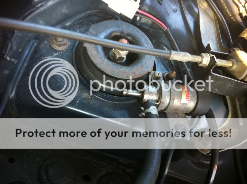

stupid question time, but shouldn't something be hooked to the third vac port?
it's the old Flyin Miata eletronic boost control solinoid
it's got 2 vac lines and the wiring going into it but i can't find anything online as to if or where a third line needs to run
this could be a reason i'm spiking at 14 eh?
and i don't see anywhere for another vac line to go to from the solinoid
http://i2.photobucket.com/albums/y13/cbrjeeper/73151e2f.jpg
No big deal, it's how my boost control solenoid was plumbed. When boost isn't being routed to the wastegate it is likely venting out of that port.
ok, just curious, because i can't find ANYTHING on this one
thanks!
Wastegate doesn't bleed boost, it routes exhaust around the compressor. I'd still check to make sure you've got a line going from that vac port to the wastegate. Or better yet, e-mail FM and ask 'em for the vacuum routing diagram for that boost controller.
ah, you so smart, i'll email Keith now
but the thicker of the two hoses is going to the waste gate

just got confirmation that the opening on the boost controller is a vent and supposed to be left open
I was referring to the boost control solenoid routing boost pressure to the wastegate actuator, or venting it. Not that the wastegate vents boost. Sorry for the confusion.
so i guess my boost issue could just be as simple as plugging in the keypad and seeing what the boost is set to. . . . . which i probably should have done from the start. . . .
