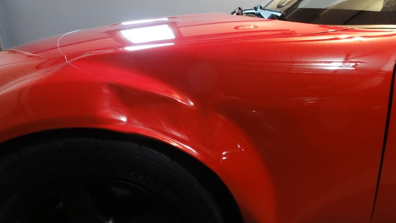

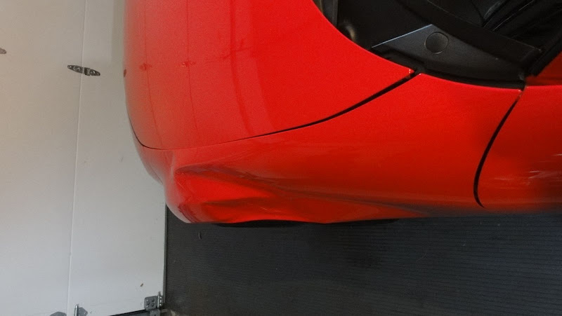

Aww. Mahk will miss his baby. I surely miss mine.
