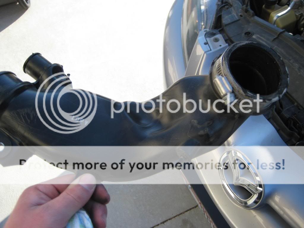

I would recommend a silicone reducer with t-bolt clamps instead of resusing that stock coupler. We are talking about the speedie6 inlet right?
Yes the speedie6. Does anyone sell a silicone reducer in black? It's still under warranty, and if I take it in I'd rather just have it look factory then have to put the stock one back on. I didn't see any t-bolts at the parts stores I went to. I need to check to make sure everything is still tight.*Pic courtesy of AWDRacer* The clamp on the right was stripped and completely loose when I checked it.
Ebay has them. I got a 2"-2.25" reducer...I believe that was the size. You have to cut about an inch and a half of the speedie6 pipe so your not hitting the battery.
Napa sells the t-bolt clamps. Just ask for 2 since you need one connected to the turbo and on for the pipe itself. 2" t-bolt clamps are hard to find though.

Awesome, Ill be checking ebay then. Thanks.
Thanks, I'm going to look into this. Do you have a pic of the one you got?

So I'll try Qwik's reducer trick, and look for some more solid T-bolt clamps while I'm at it.
