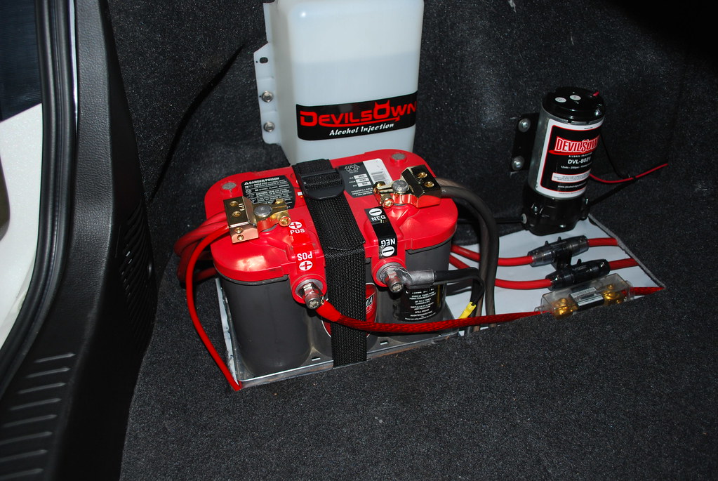

One thing I do notice with the battery in the trunk is the car takes slightly longer to crank. But no issues with it starting.

Also, what size(gauge) cable are you running from the trunk for the battery? Id recomend running 0/1 gauge if you aren't already. It make help that weaker cranking siince it will have less voltage drop with the bigger cable.
Also, I recommend running a ground (4ga is fine) from the battery straight back to the front as well. The 6 sometimes has ground troubles if its only grounding in the rear from the battery.

Pics of teh trunk.
Here you go. :) I should have painted the metal in the trunk black so that white sqaure doesnt stand out so bad. But I wasn't going to mount fuses to the carpet. Wanted something that I wouldn't have to move once I put it on.
