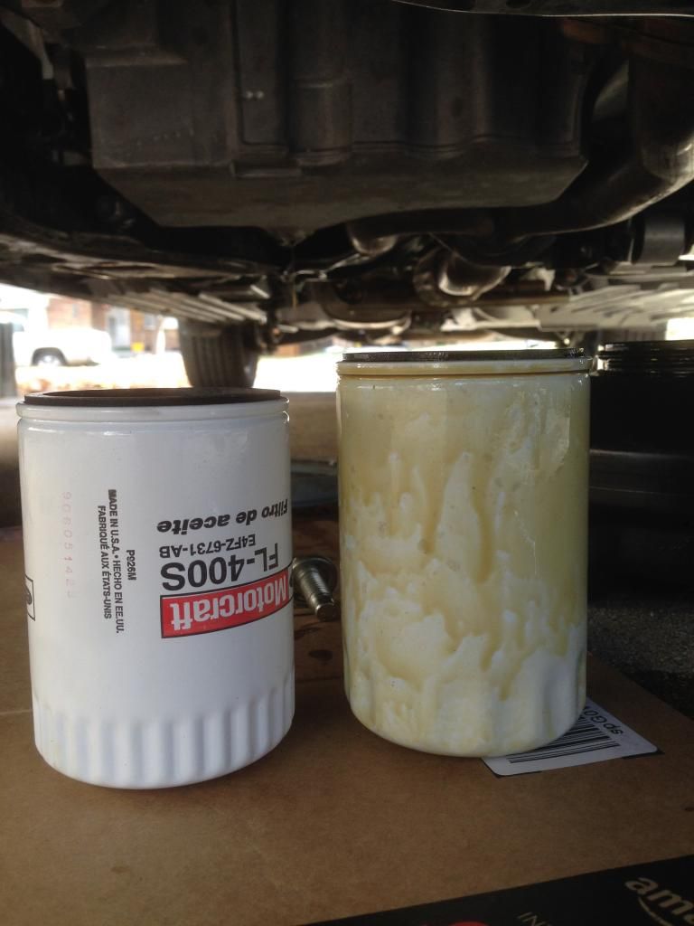

Did my first oil change (@600 miles): Castrol Edge 5W-20 full syn and a Motorcraft FL400S filter (figured I'd keep it FoMoco). Comparison with the dealer/factory filter. Interestingly, the factory filter had practically NO markings on it:

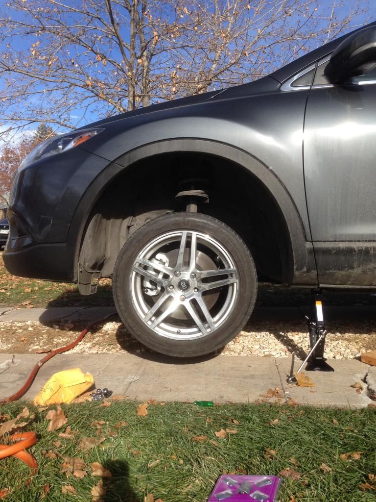

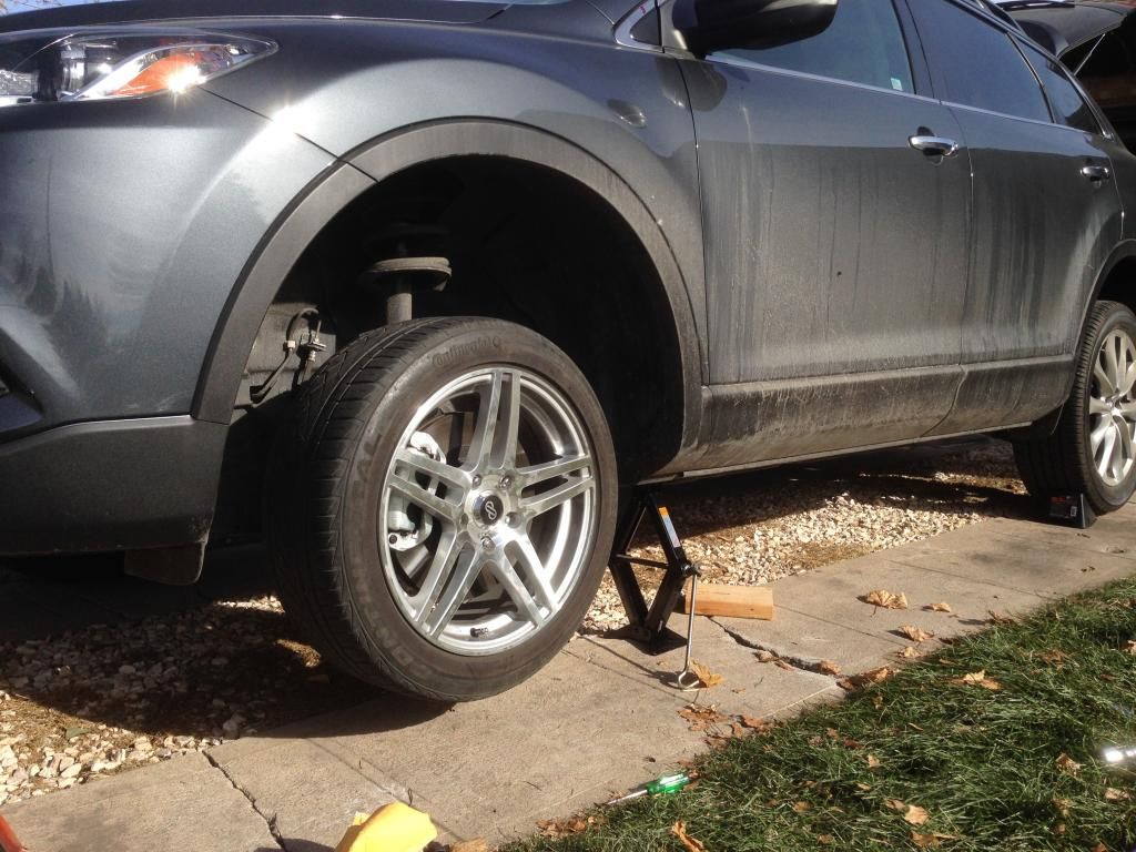

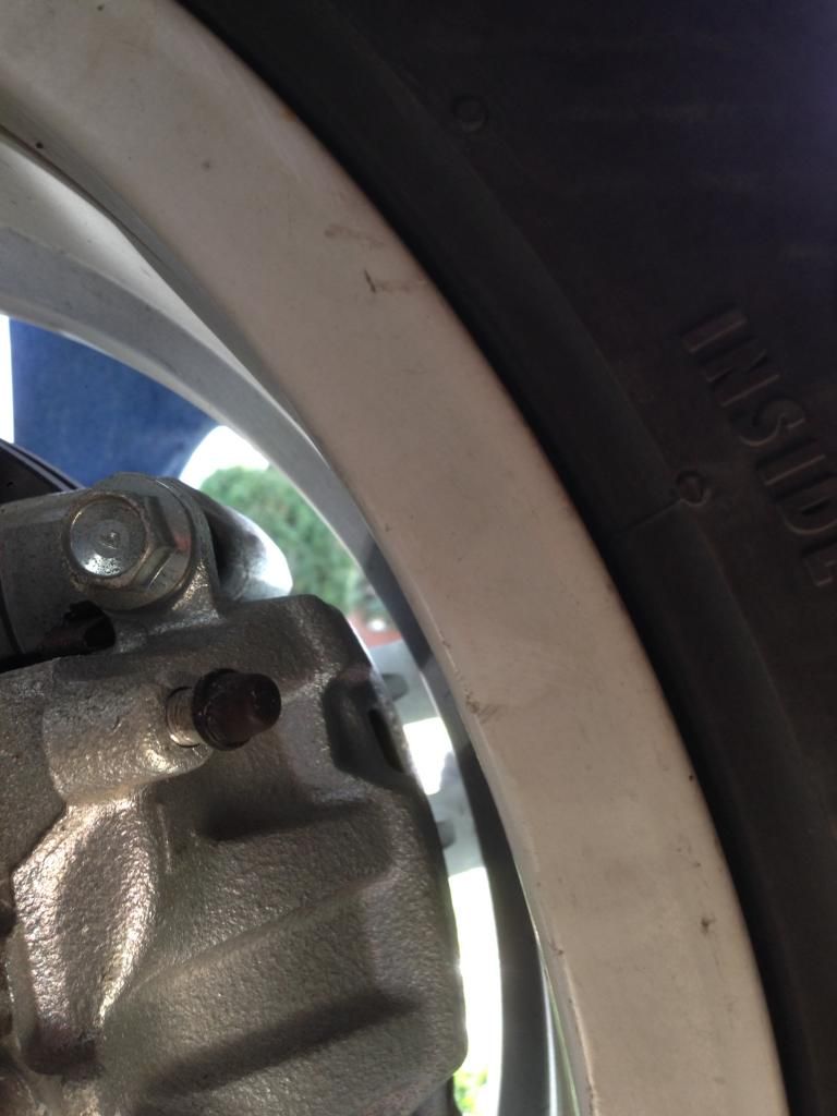

Gave a test fit of the Enkei RFS5 17x7.5 ET 50 wheels I have from my old 6. Going to eventually mount snow's to them I think. Also, great view of how rediculous our cars would look with 215/50R17's (lol2):
Clearance: (not much!)

Nice work, ours needs a bath and oil change too! I like your choice in oil too, we use Castrol Edge in the CX9 and 9-7x Aero. I use 5w30 in the Mazda though, even though it calls for 5w20.
I'm a big fan of WIX Filters, I use 51516 on our CX9.
Yeah, it's going to be brutal having a new car over the winter. I'll want to wash it every week!! That and I have to keep it looking nice for the family who hasn't seen it yet, lol.
I was pleasantly surprised how easy the oil change was. The dealer didn't have an 800lb gorilla install the filter and I was able to remove it by hand. I didn't even ramp it! Just did it on the ground :) A little tight, but I don't have ramps yet :) As for the oil, I like Castrol products for car engines. But really, it just came down to what was spec'd. Figured if anything goes wrong, I have proof I put "recommended Castrol" at the spec'd weight with a Ford filter. No one could find fault in that! LOL.

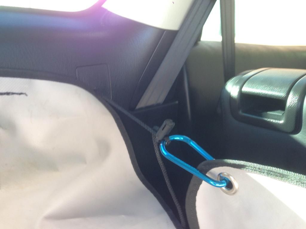

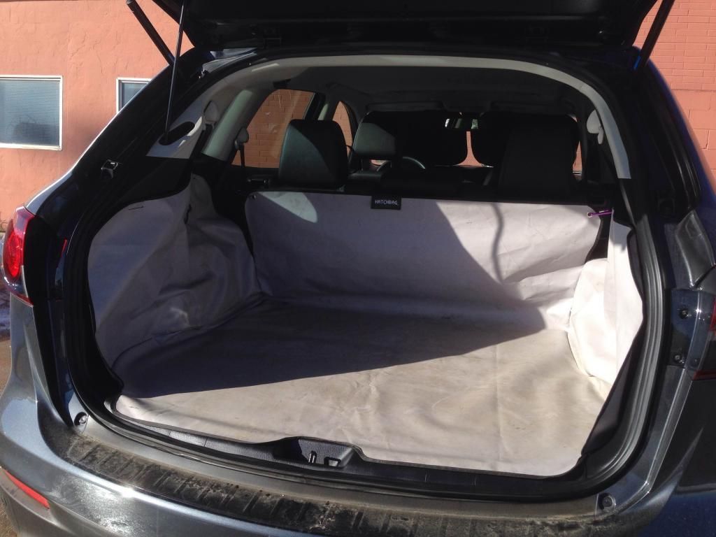

Fitted my HatchBag from my old 6 wagon into the 9. Not a perfect fit, but acceptable. Acceptable enough to avoid the $170 for a new one at least! :)

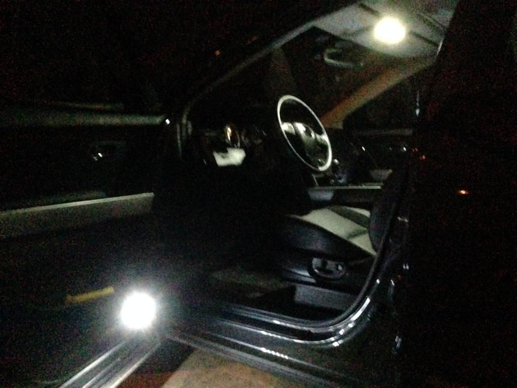

Also full LED 5k interior now, with LED puddle light mod for courtesy door lights
Blurry:

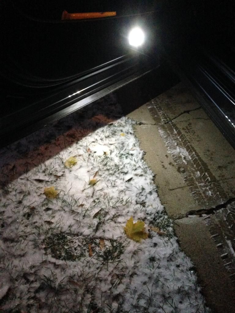

"Puddle" light with 5k 6-SMD strip light and high output 194:

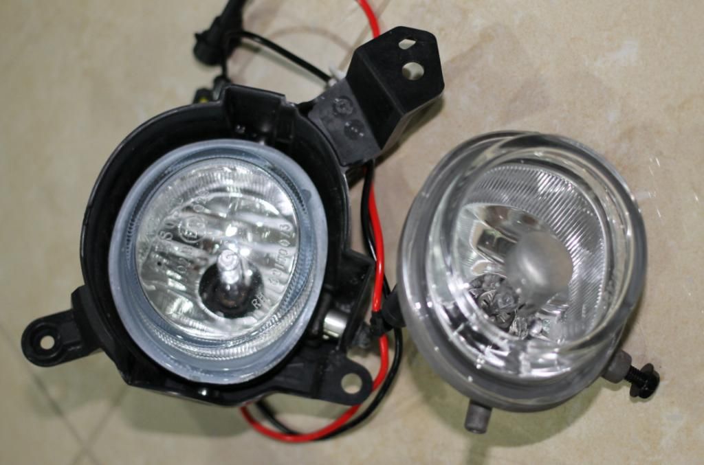

Voldsom,
I know exactly what you are referring to about that shroud inside the foglight, my long hid bulb hit it when I tried to install a HID bulb.
I had to take a screwdriver and bend it down a little bit to get the HID bulb in. Still the shroud was blocking some light.
I tried opening up the foglight to unscrew the shroud but the dang foglight seal would not budge at all, then I went this route
http://www.ebay.com/itm/MIT-OEM-MAZ...Parts_Accessories&hash=item1c355f4574&vxp=mtr
it is the SAME EXACT foglight as CX-9 WITHOUT the shroud, plug and play with existing CX-9 (fog bracket),
you won't need the Mazda2 bracket, just take out the foglight and install into CX-9 bracket.
here's a picture of the Mazda2 fogs without the shroud inside the CX-9 bracket shown in the left,
on the right is the OEM CX-9 with the shroud that gets in the way of long HID bulbs :
just an option for you if you can't get the CX-9 foglight opened to remove the shroud
honestly though, without the shroud, I didn't see any improvement in light output, just an insane amount of glare
(I still have the Mazda2 foglight that fits your CX-9, PM me if you're interested, used maybe less than a week)
just a caveat though, the purpose of the shroud is to reduce glare to oncoming traffic,
without it , there was way too much glare, so I went with the Hella 90mm projectors.
thanks for the tip @avidien!! That's a good point that it's there for glare. And the LED bulb is supposed to mimic the light output pattern of halogen (VLEDs designed it that way) so it may not be an issue. One difference is the bulb is really just an aluminum stick with an led on either side, so glare shouldn't be an issue because no light is actually shot forward, it's all shot into the reflector (I'll post pictures later on :)).
I'll definitely let you know if I'm interested in the Mazda 2 light, as that solves the issue of having the shroud.
