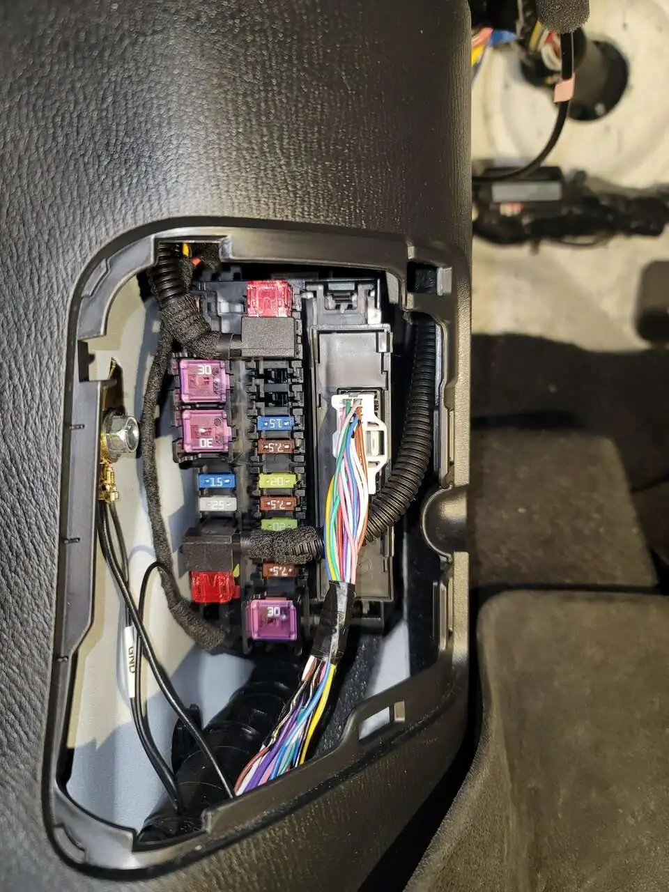

Ok all done.... got the hardwire kit and finalized the install of the dashcam.

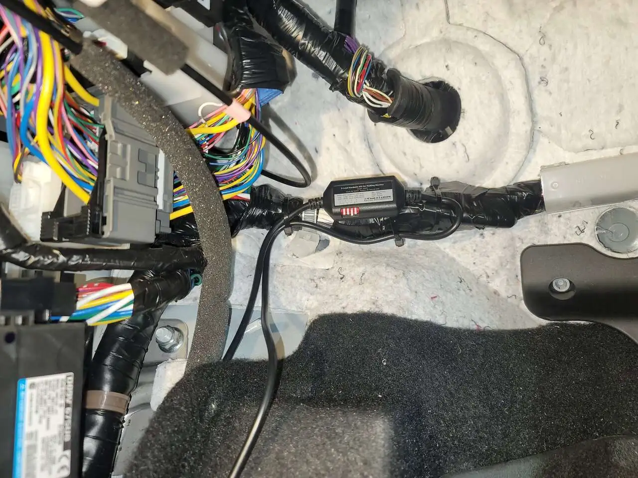

This is the battery saver. I kept it out and accessible so I can adjust the voltage if needed.
Here's the fuse box. I used #5 for the constant+ and #11 for the accessory+ (which was an empty slot).

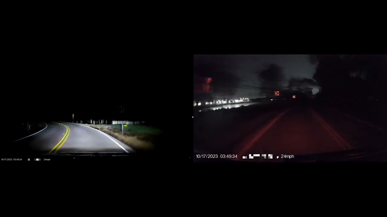

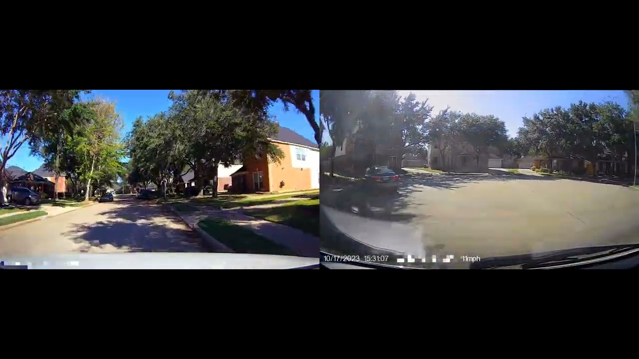

Here's a couple of sample (sped up) videos for the AZDome M300S. I need to get a filter to reduce the glare. I wonder if the filter for the U1000 work for this one.

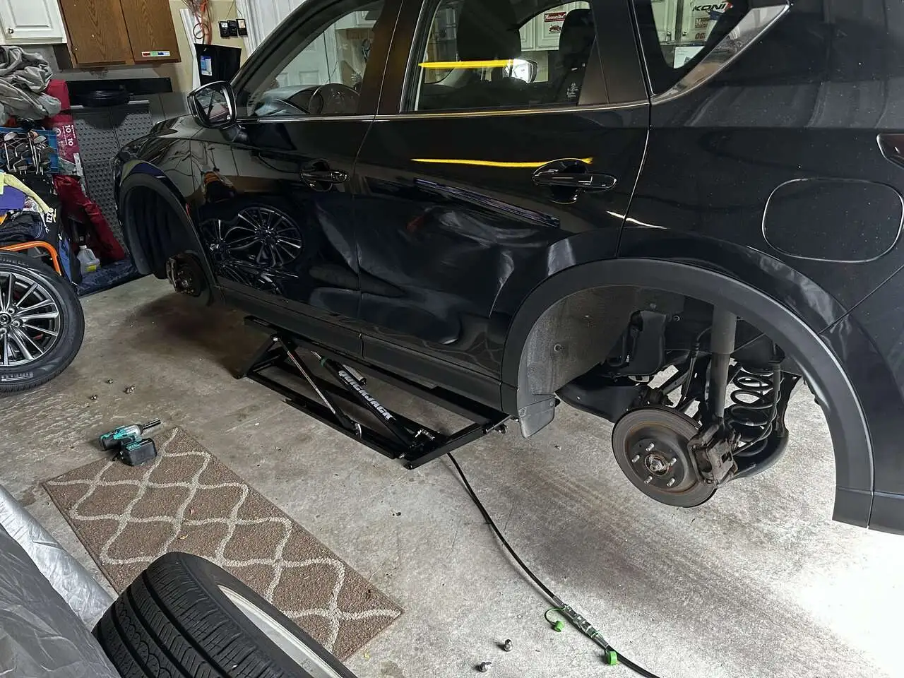

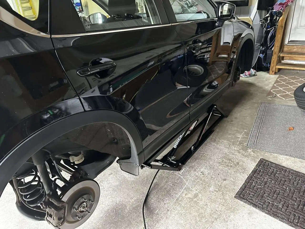

Oil/filter change, new wiper blades, waiting on a call to go pick up the wheels with the new tires. Went with General Altimax RT45 since they discontinued the RT43, hoping they are as good as the 43s have been.

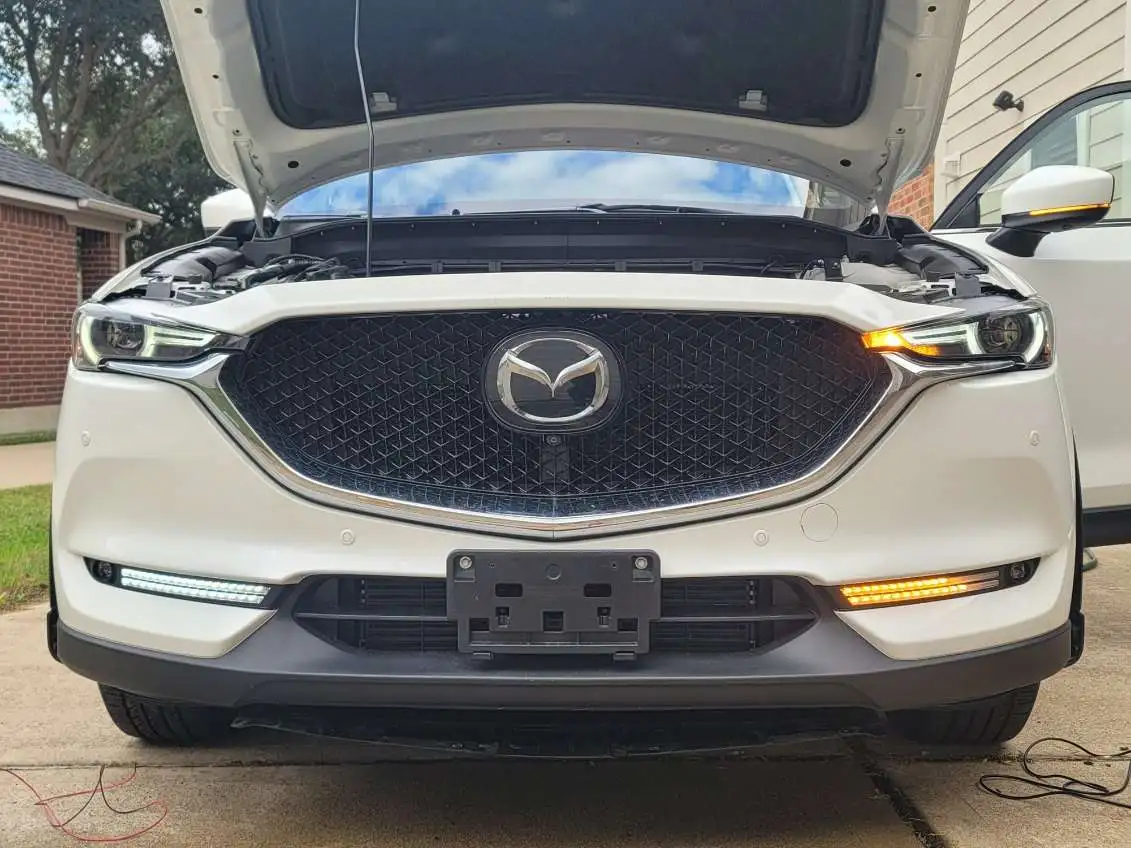

Just curious, anyone install this????
While on vacation, I purchased one locally. Can't wait to install it this weekend. I need to get the bumper off.

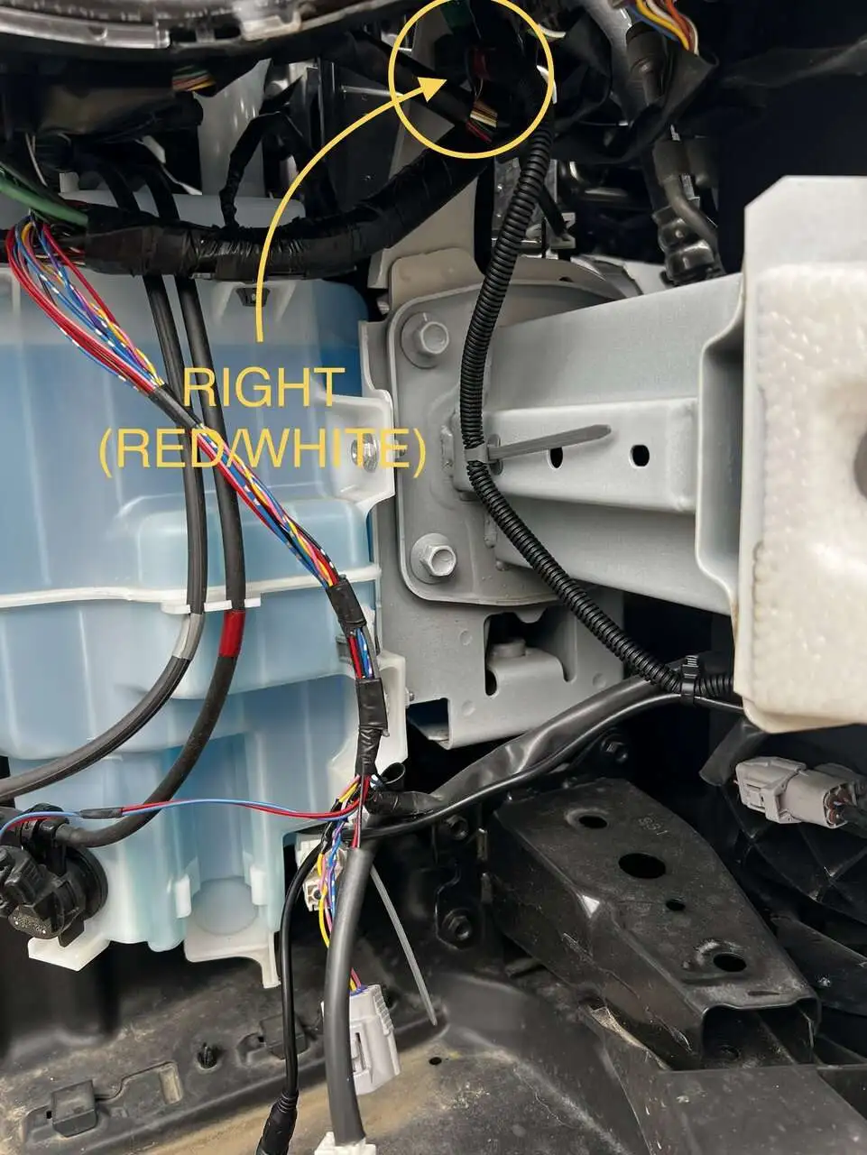

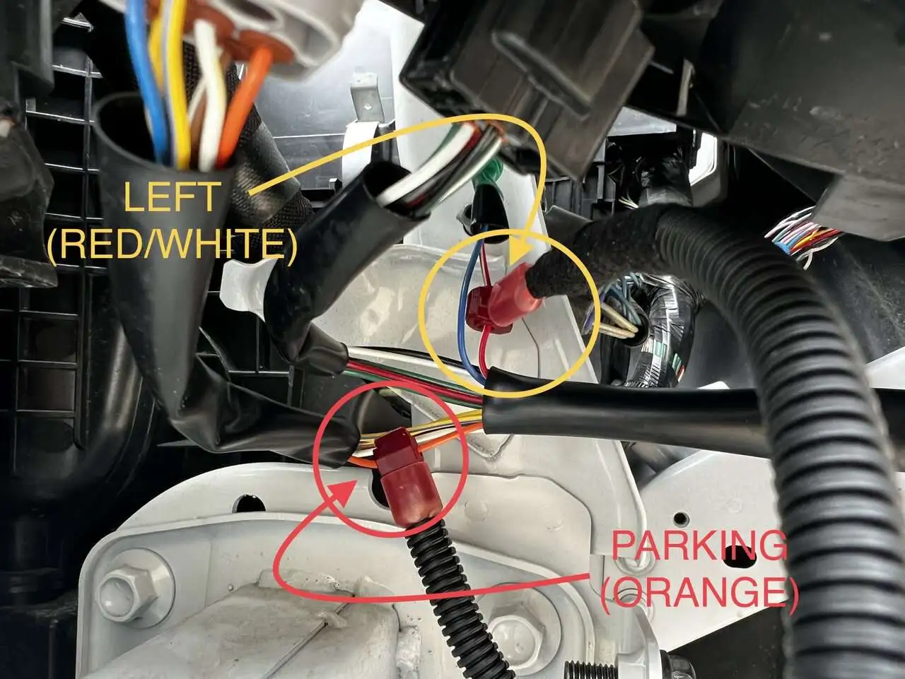

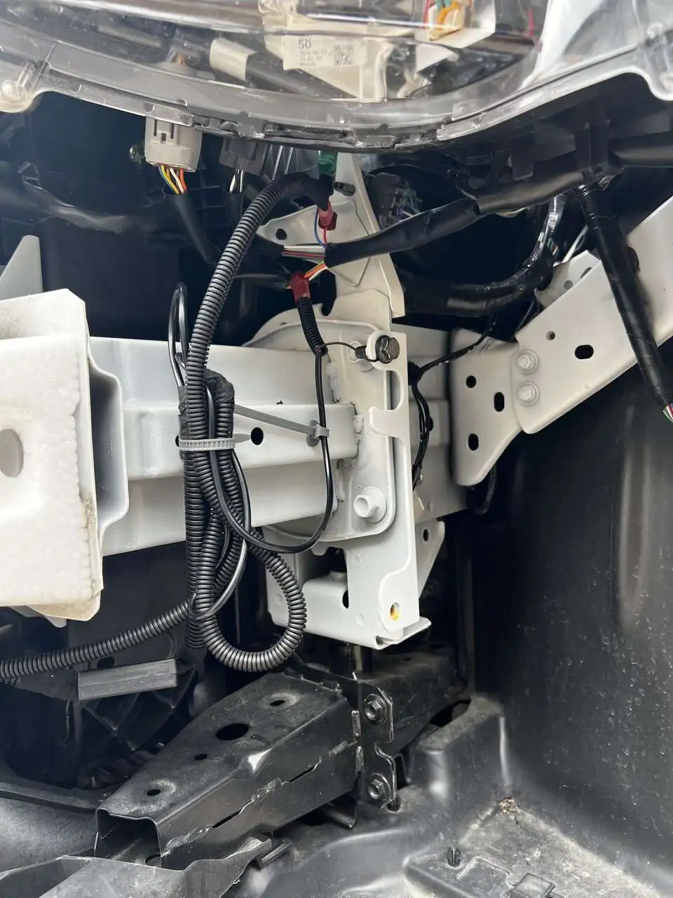

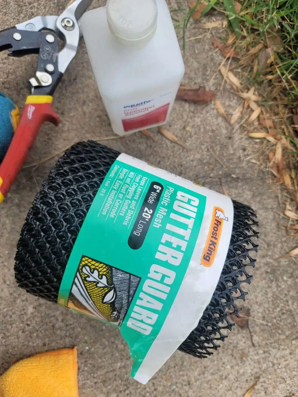

All done… taking out the bumper was not as bad as I thought.
Here’s a couple of pics of the work for those of you planning to do this.
I notched a small opening here so the wire does not get pinched.
I typically use posi-taps but I didn’t have any laying around so instead is used these.
I have these laying around, got them from Amazon. It’s the best way of securing the wires.
Here’s a pic of it installed
And since I had the bumper off, I installed this. It helps keep the bugs out in there.
