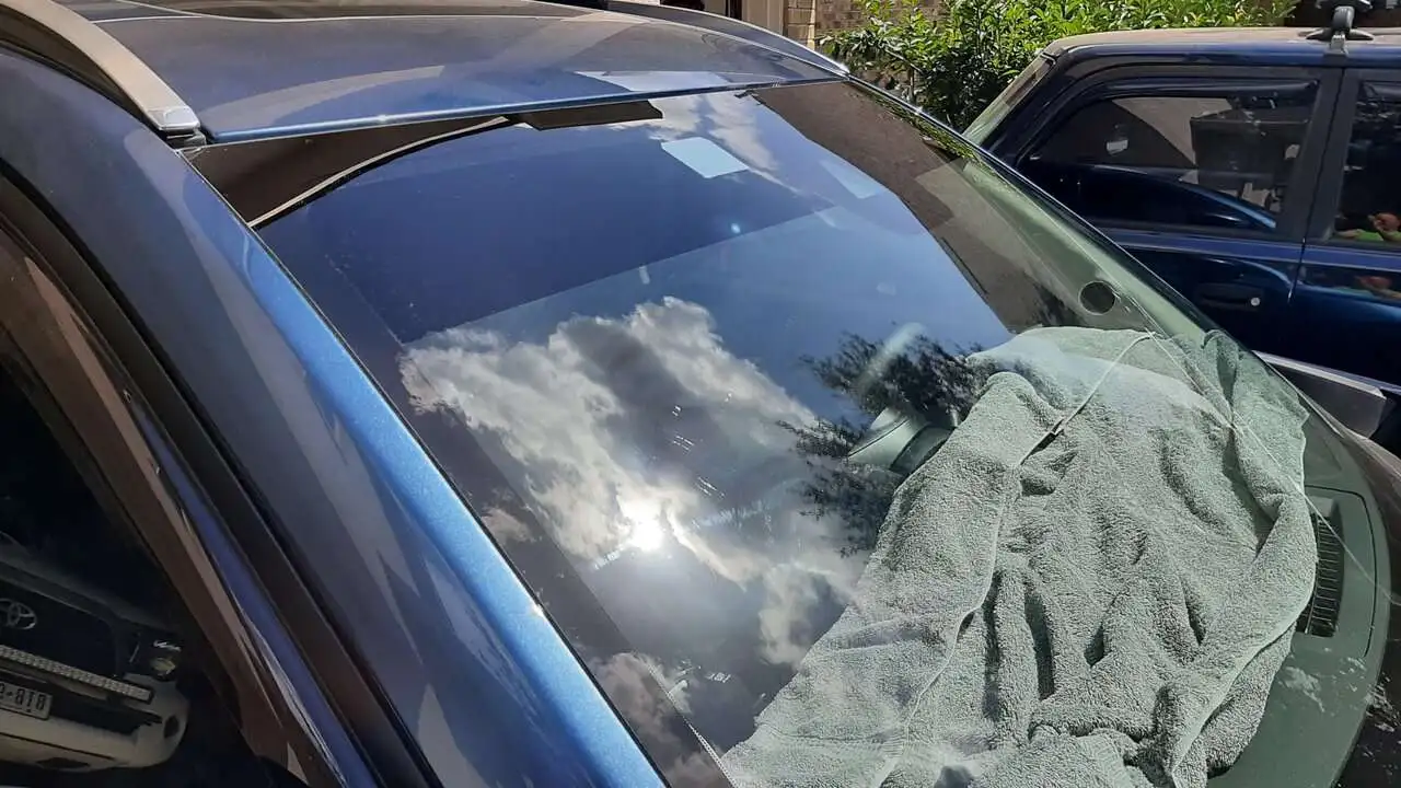

Windshield tint complete......

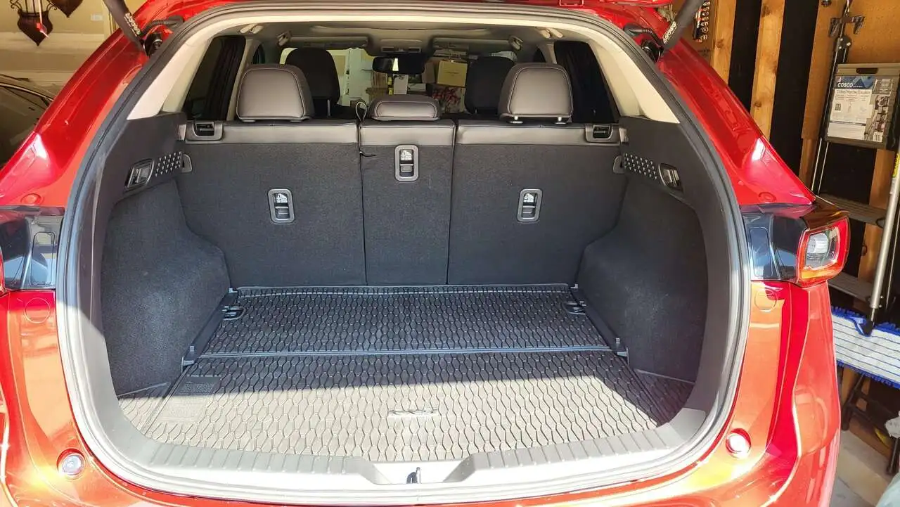

New member here, so it's my first post. The factory trunk liner I ordered arrived today.

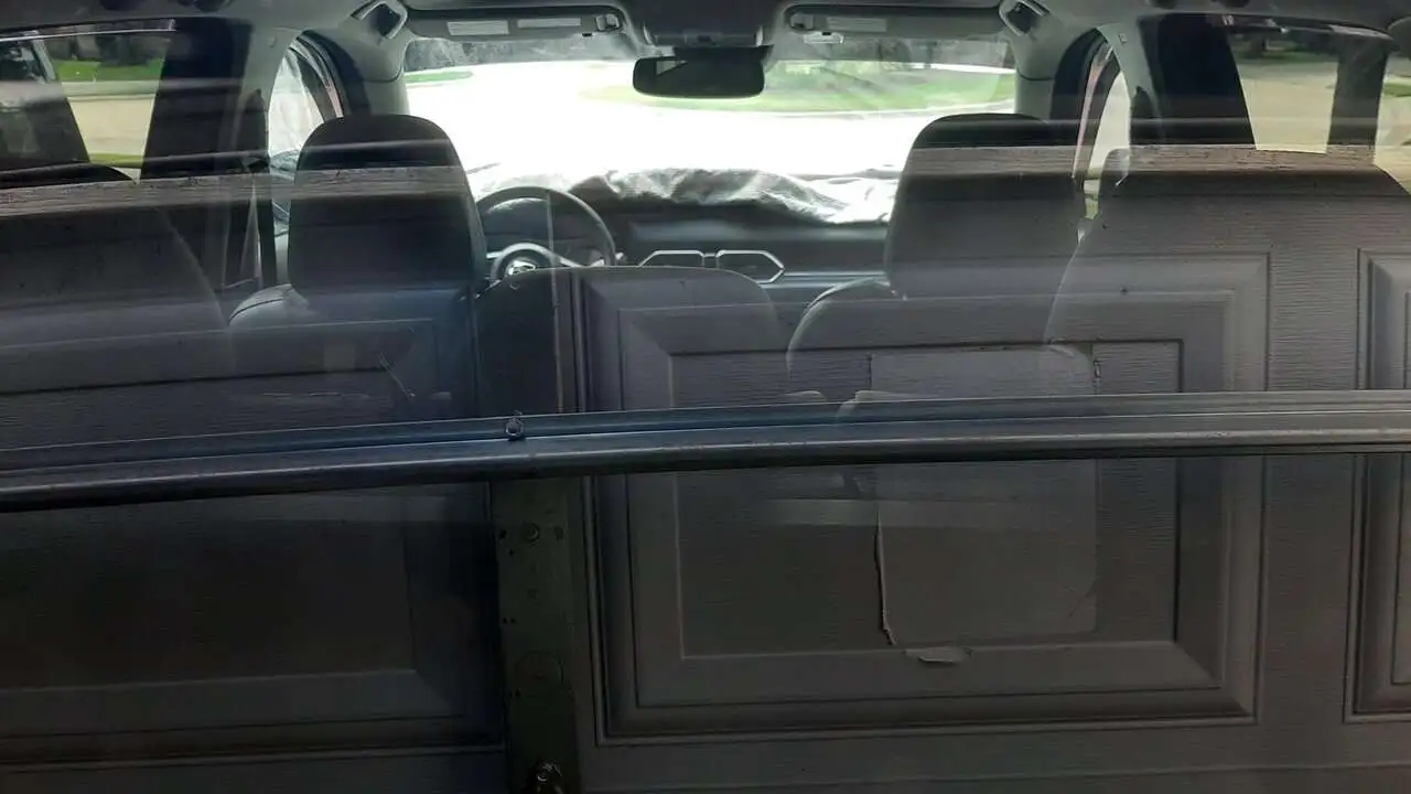

And I had the the front two windows tinted 25% ceramic tint, while the rest used Llumar clear air 80.

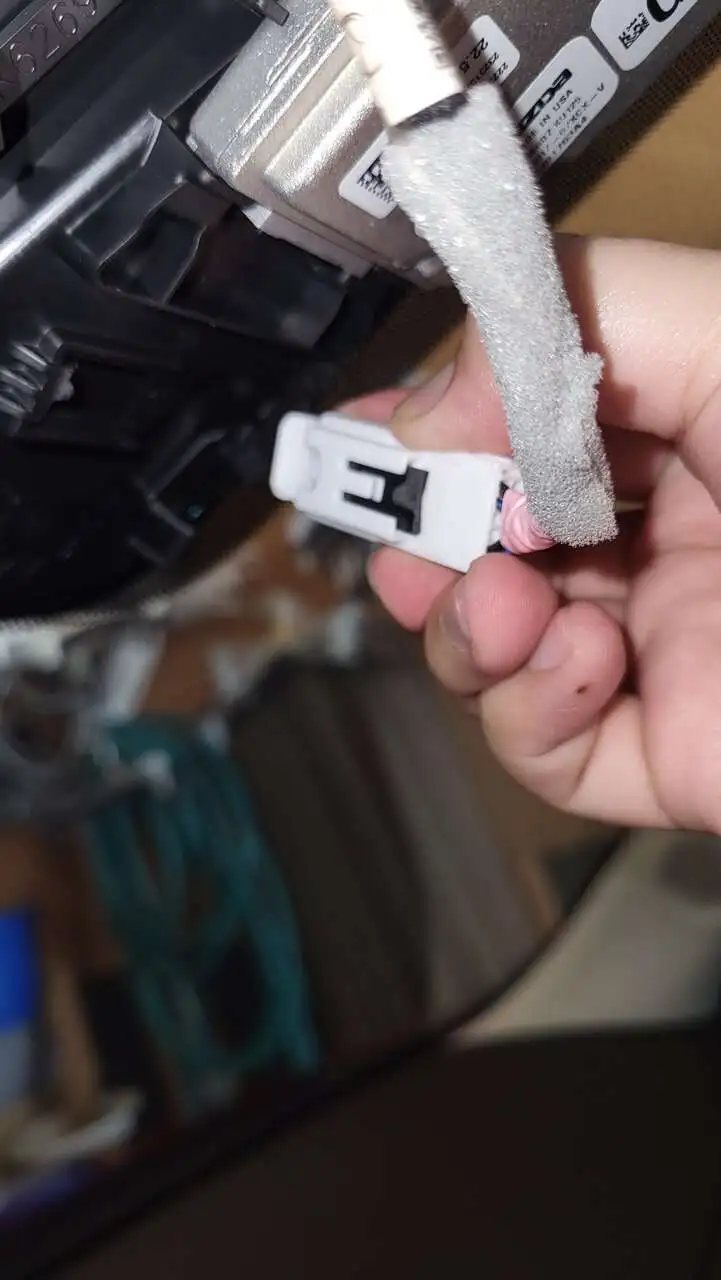

However, when the shop did the windshield, they removed the homelink mirror. And they failed to put back the torx screw, which caused the mirror to be loose. Not the end of the world. But when I rectified their mistake today, I noticed the holder for the female end of the homelink plug broken. I only have 250 miles on the CX-5...
View attachment 321627 View attachment 321628

What's really annoying, is the kind of vehicles the shop works on are higher end than my mid-level CX-5. I'm annoyed, but I can't really do much about it (other than complain). I can't see it with the cover on. And, mercifully it doesn't rattle. At least my mirror isn't loose.

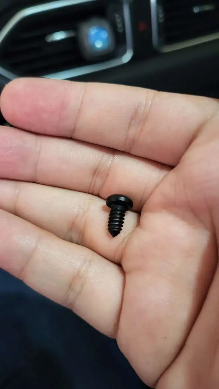

I changed my oil for the first time ever on a car. Was tired of my local dealer using low quality oil and Mazda value parts. Can’t say I was surprised to find the access panel missing its screws and barely hanging on while the drain plug was stripped too. They were clearly using a pliers or a vise grip to take it on and off based on all the markings. Happy I finally did it myself.
Well, my happiness was short-lived. The mirror vibrates while driving...
Looking at the instructions for the frameless mirror, it says the torx screw as to be torqued at 15 lb-in. Which means I'd have to wait a few days until my tint cures before tackling this project again. And I buy a set of torx bits for my ratchet.
Yes you really need that Torx T20 pointed-tip screw of your mirror will vibrate.
Actually this mirror screw is prone to get loose all the time. My mirror is loose again and I’d tightened it up 3 times. Be aware you don’t want to make it too tight, or you may crack the windshield. There’s a Service Alert for that, only 15 in•lbf (1.25 ft•lbs which is very light) recommended like you said.
Would a touch of blue thread lock help?
