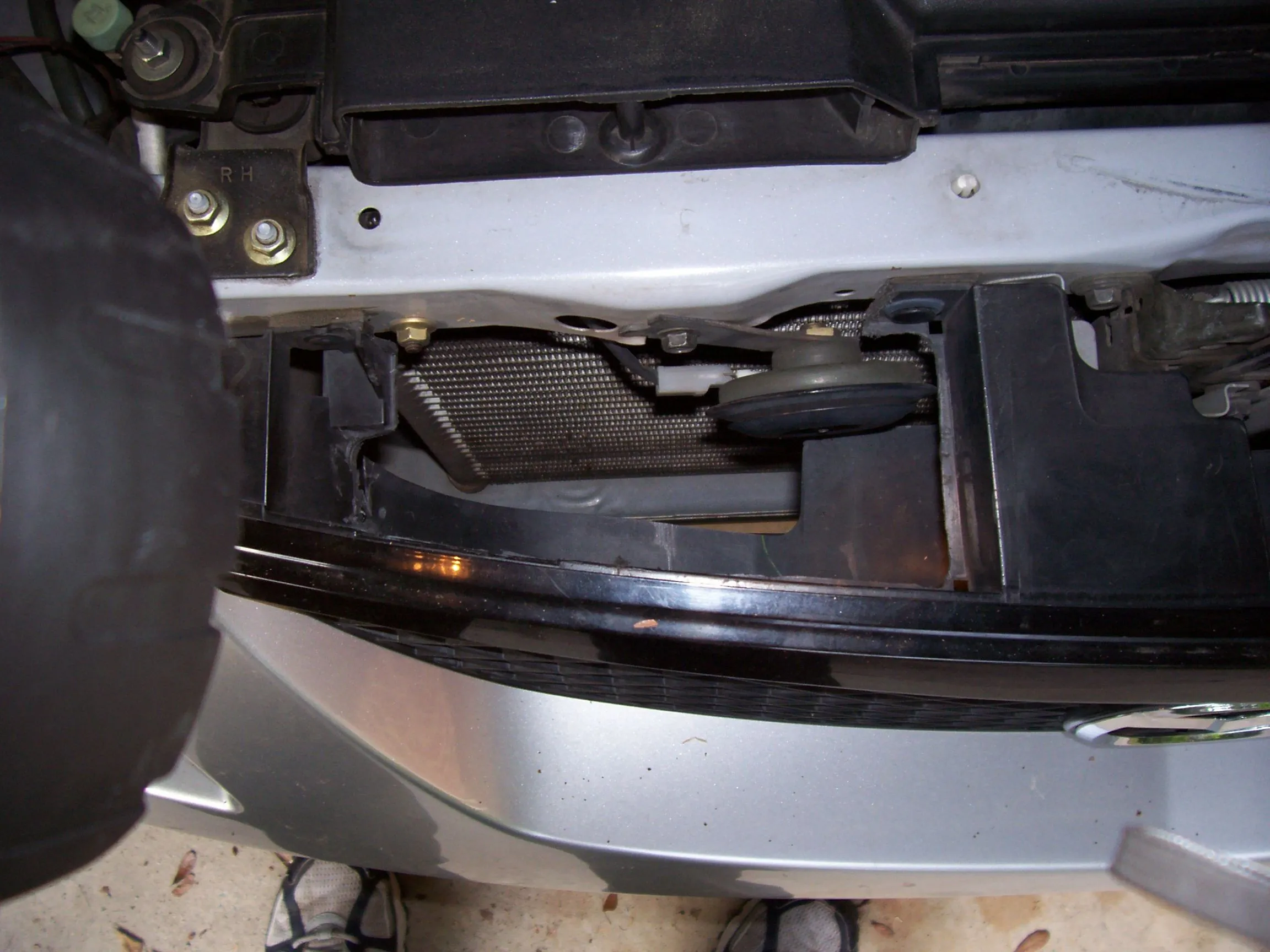

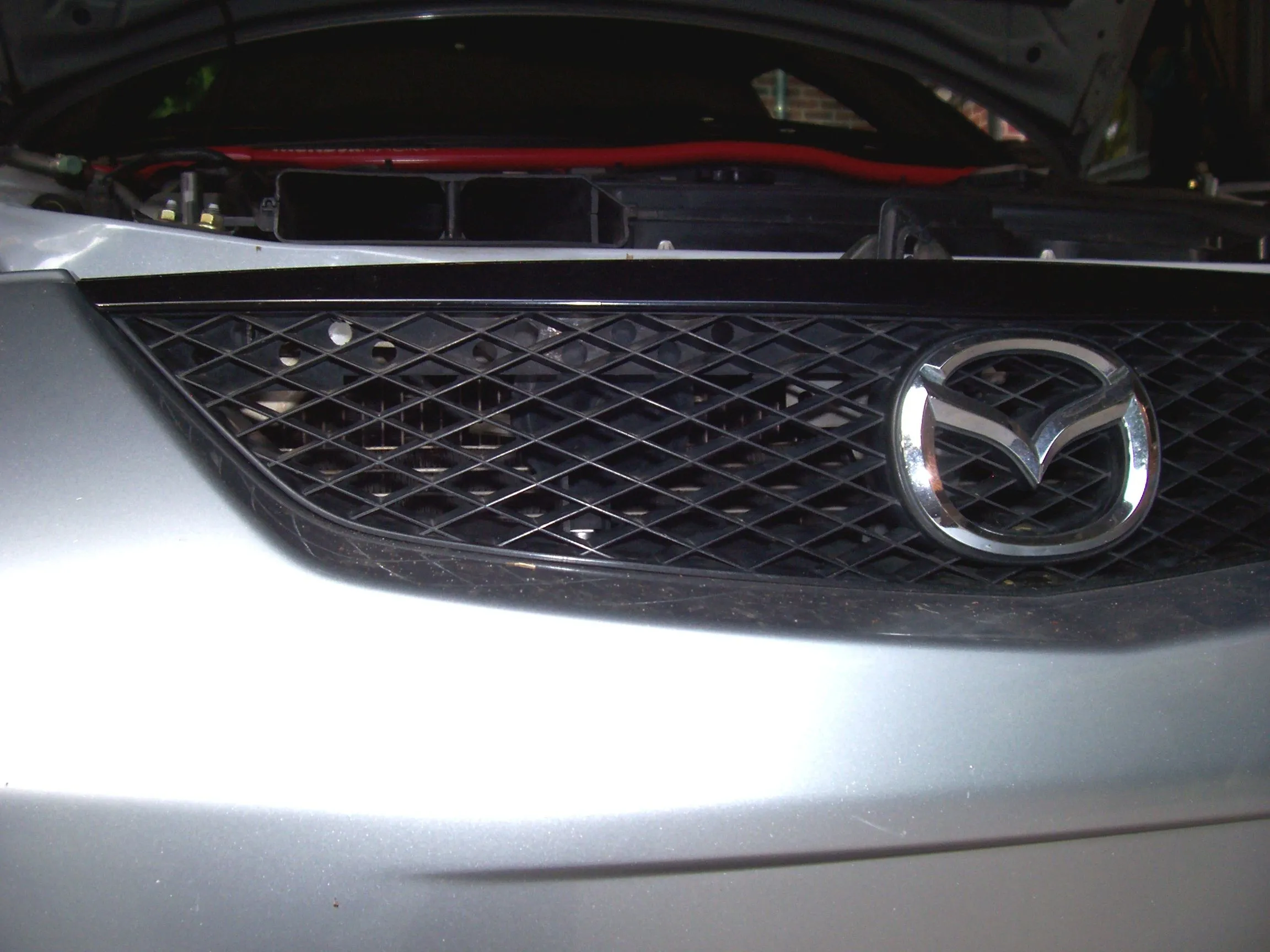

Read this post to see how I turned my factory box into a cold semi-ram air intake:http://www.mazdas247.com/forum/showpost.php?p=3844576&postcount=58
Here are pictures to go along with the description:
This how I cut out the plastic blocking the intake from cold air. Without this, it breathes hot under-hood air.
There are 11 holes to let more air up into the cut out area
I swear, this sounds better and outruns all the guys that use SRI and CAI.
