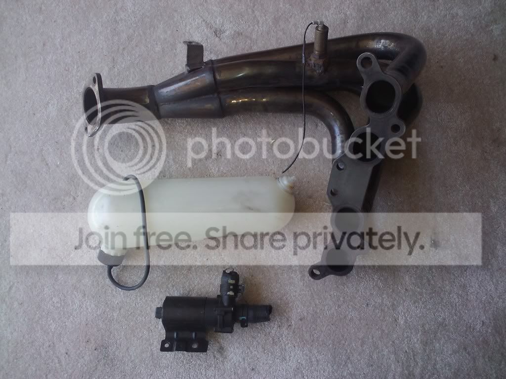

So finaly got around to testing my water pump and it didnt work so I went back to pick and pull and found a cadillac cls took that pump tested it there and it was fine..Walked around found a Water resevoir from a vw bug that would work good for the intercooler...then also found a JASMA manifold for a MR2 which will pay for the intercooler once i sell it all of this cost me 52.00..good day people..
