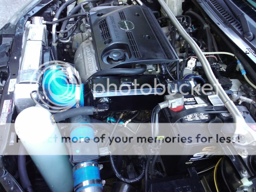

So far yes its early but ive had a total of 4 intercoolers ,stock ,audi 5000 smic,saab fmic, and now water. They where all good for there own reasons but im happy with the water.Also today driveing around the air temp was around 72 but my throttle temp was 86 and would drop once i got moveing around. I also parked the car for a while. Obviously the system heat soaked but never got above 96 and once i turned the pump on temps started dropping even while parked.I think next relocate the tank to the trunk that will help drop water temps as well. well made a small vid.
final note the car rpms dont dip hard where the car wants to die. pipes are so short that the car catches itself no problem so the fact the maf had to go back on the intake made no differnce.

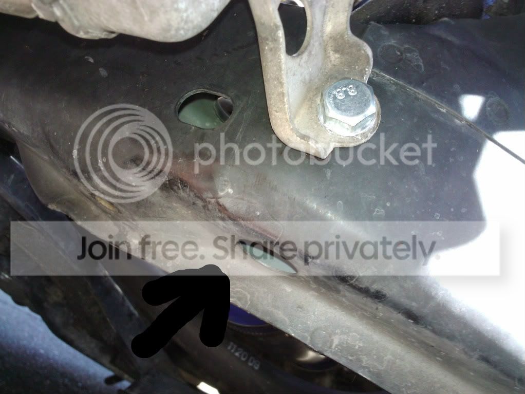

here are some more pics that I took of when I installed the heat exchanger. Helpful tip when you need to hold onto a nut in hard to reach spot electrical tape works great..
this is where the tape came handy

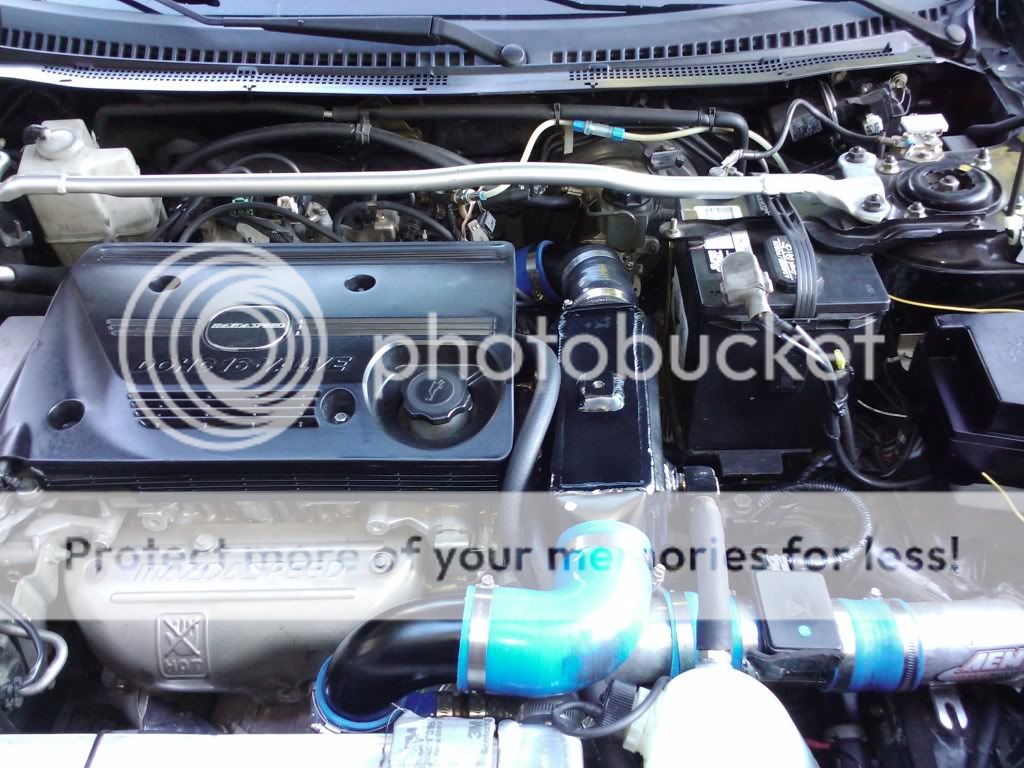

well cleaned things up some more. Ive been haveing fun with this system but ill be honest seems like more of a headache sometimes but you know that maybe the nature of the beast. My on switch has an issue of not turning on sometimes witch makes me want to hard wire it into something else but not sure what. I Have crazy throttle responce witch is fun but i have no tunning so then the car bogs down faster due to the rich mapping from mazda. That is what is driveing me the craziest is the lack of abality to tune I have boost guage, aem afr guage, then my phone shows me timeing graph, maf graph , water and air temps but nothing to tune with..I just want to take some fuel away..I know I should save forsomething but the next thing is a knock light..at that point i may start raising boost..

i filled the tank full of fluid and changed the pump over to the same one you got pushing way more fluid through the system took a test run boosted for a good 4 to 5 seconds with no real change in temp a good 77 degrees later dropped to 69 by the time i was done but that took a while since im cooling way more volume though.
