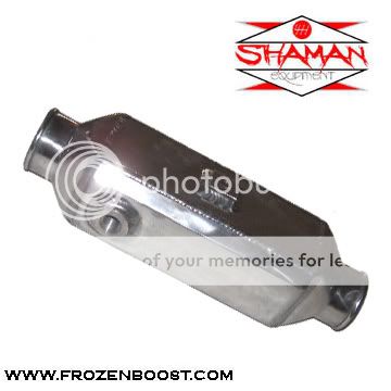

so cx raceing has let me down twice they where out of stock of both intercoolers, so I ordered from siliconeintakes, this is what I orderd
pipeing will be super short but there may be no room for the maf near the throttle..so hopefully this week it should comein ive been waiting fo shipment conformation i orderd on friday.

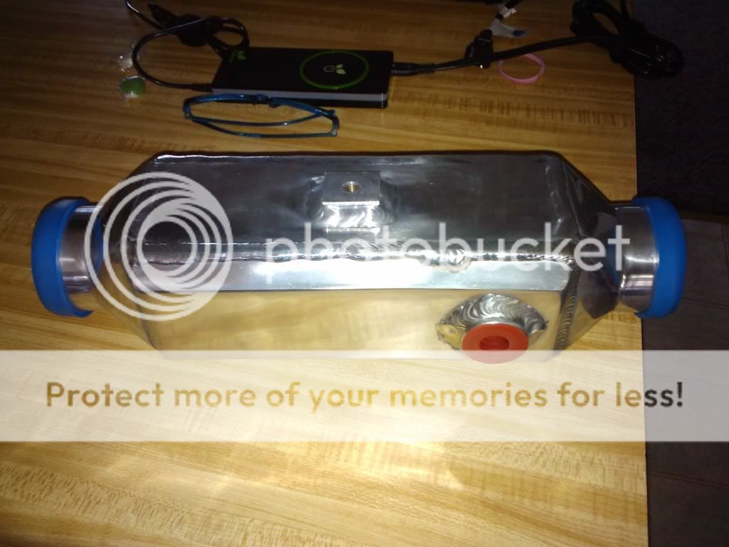

ill have it one tommorrow did not relize that hard ware was so pricey about another 50 in brass pieces

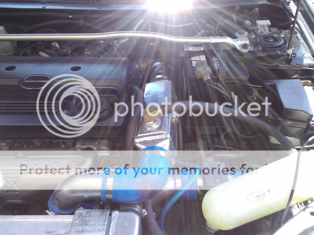

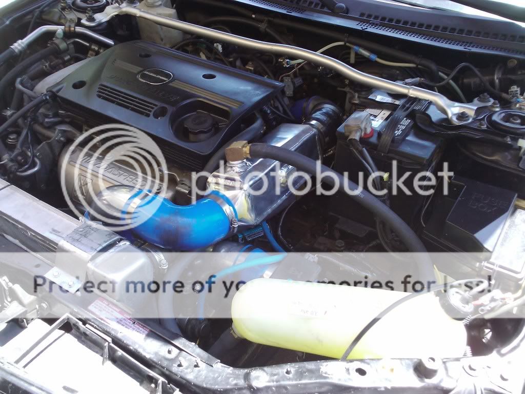

Nice short piping. Looks good!
For the coldside to throttle body coupler, you might want to see if you can get a 90* silicone coupler with long legs. That would give you a bit of a better transition there.
I take it you have a BPV or BOV mounted directly after your turbo, on the section of pipe hidden in your pics?
You are correct sir yes a 90 would be best but I wanted the ait on the coldside just to see how the air temp was being affected overal very happy the car responds great didn't get to drive much yet just got to get use to the low rpm drop after shifting to nuetral but I'm guessing most like,y a issue caused by the length of hose from bpv to intake.

Close to $300 bucks not cheap but I'm pretty happy I drove to work today and the car was supper smooth close to 70 on air temp +/- 3 degrees the whole time even under boost. Also the car seemed quiter didn't have the extra pipe rattling. Ill post more info ias I go along
