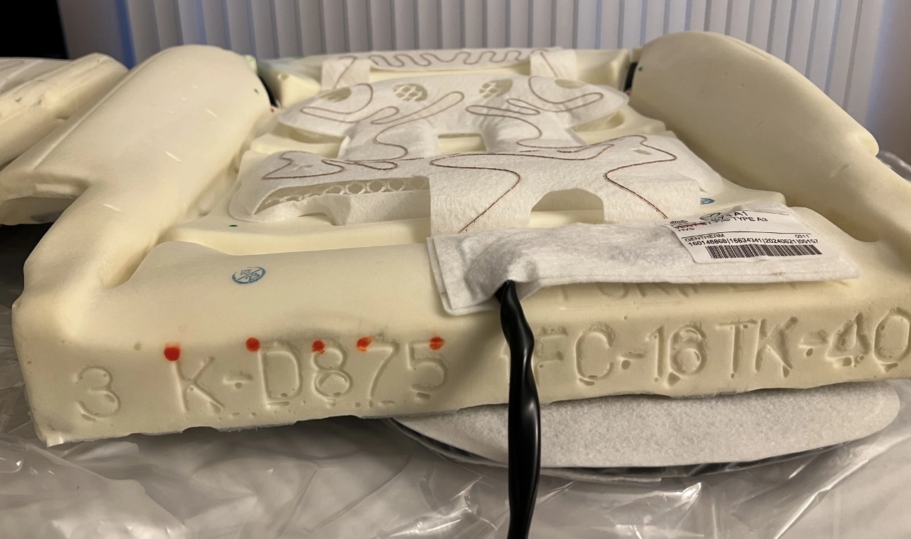

It bugged me for a while why my ventilated seats felt different in comparison to my other CX5 which has only heated. I went and disassembled the seat. Hope this is interesting.
Here is the driver side ventilated seat cushion. The whole area circled in red (below the heated elements) is one big baloon (plastic bubble) that is part of the exhaust vents system . So in reality we are directly seating on the plastic bubble and not on a foam. The foam is way underneath in a cavity carved to "host the bubble".

What i found is the plastic bubble is deformed after only few years and about 20k miles. Plus the cushion below flattened. Not great experience to sit in it. Its shame this happened so early.

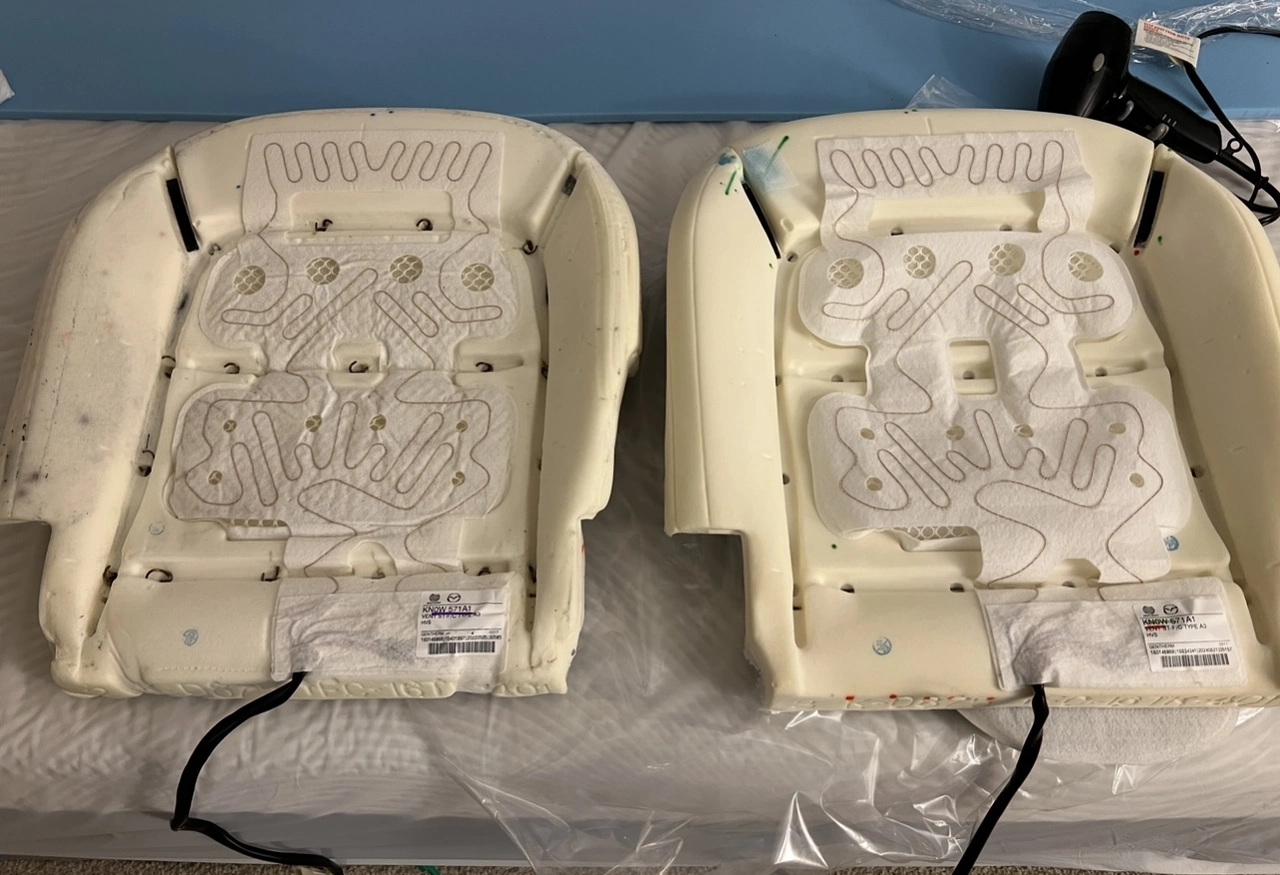

old vs new drivers side cushion
I noticed the left and right bolsters are different and one "sits" bit higher than the other.
This may contribute to the issue that some people have. If you cant fit right in the middle your bottom parts would always sit at an angle on top of the left and right bolsters. Not good ergonomy.

For those wondering- the driver side seat cushion is the same for all years. So no changes in 2019 vs 2023, etc.

Good point. updated the original text to note its the drivers side. The two cushions side by side are old and a brand new one. I changed the drivers cushion
