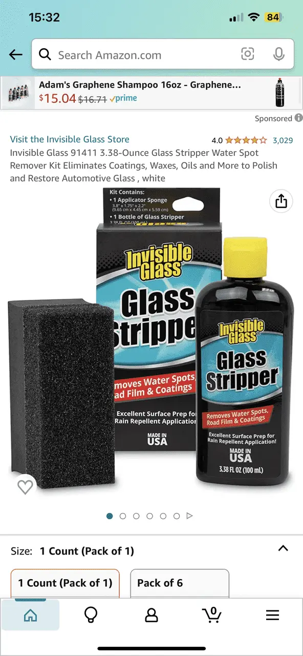

Would you recommend I use this product?

I think Invisible Glass is a good brand, and Glass Stripper will remove any coating that is on the glass. It's a low cost, easy way to be sure your glass is totally clean.
After the glass is clean try treating it with Rain-X. The first time you use it, you'll have to do it again in a week or two. After that, depending on weather, you can go a month or two before you need to do it again.
I've been using that stuff for over 20 years. Water beads up on the glass, and when it's freshly treated, you won't need your wipers.
