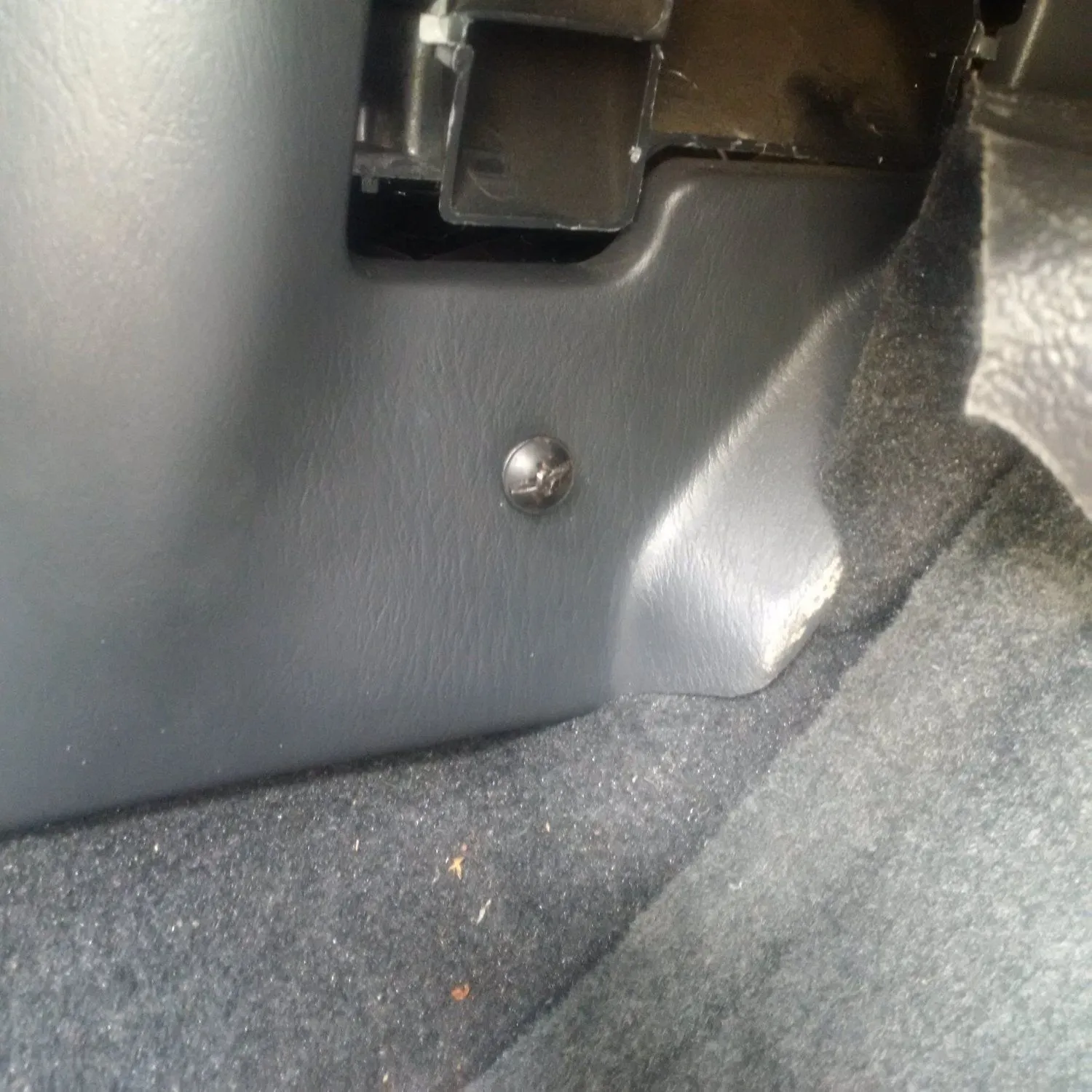

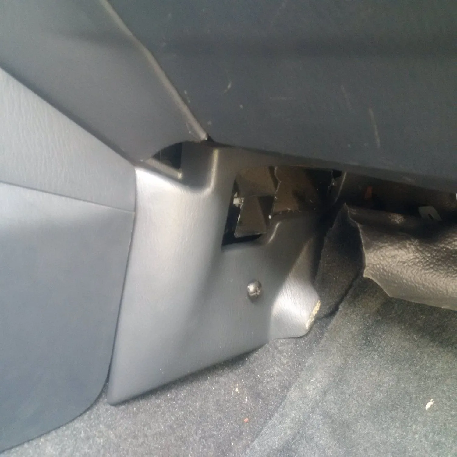

I think I may have this issue on my 2003 Protege5. I am struggling to remove this trim to get access to the drain. I loosened the screw, it is very loose on the left side but seems stuck in the top right corner. Any idea why?

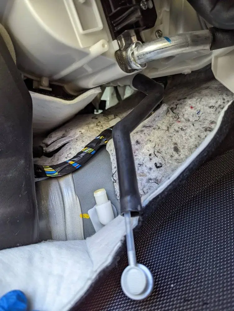

Hi, I searched and couldn't find a how to on this so I figured i do a write-up to help anyone in the same situation.....
First thing I did was check the CX-5 service guide for unclogging procedure,
there was none, but there was a diagram of where the drain hose was,
it's behind the panel by the passenger left shin: ⋯
