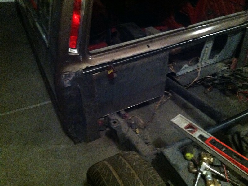

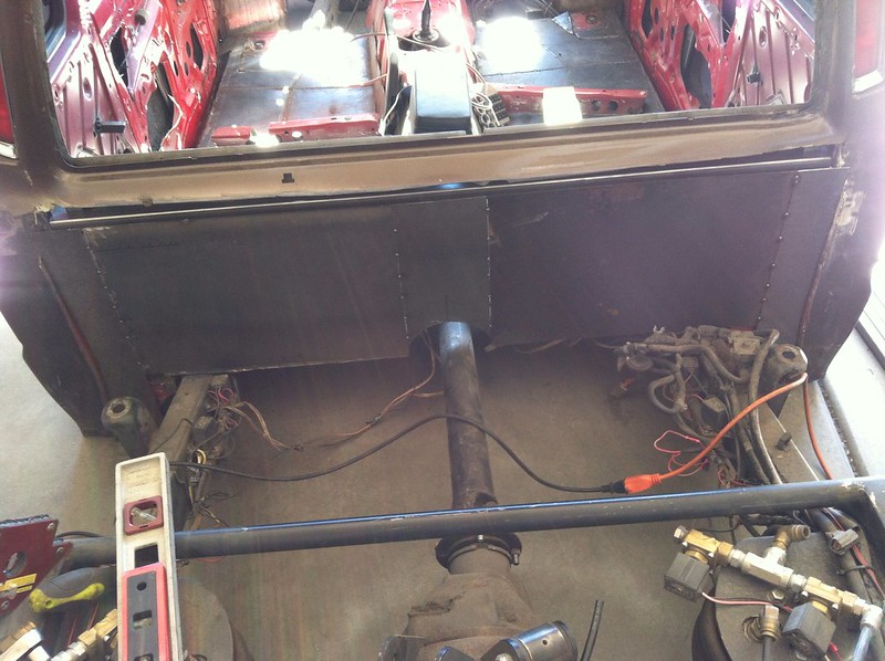

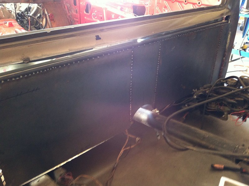

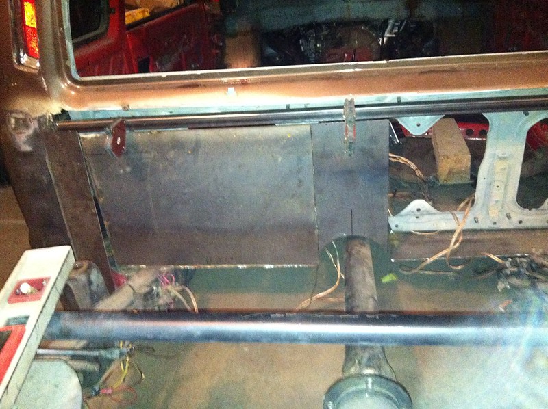

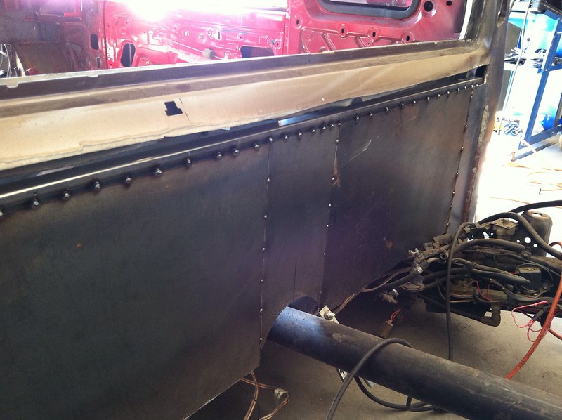

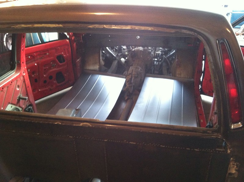

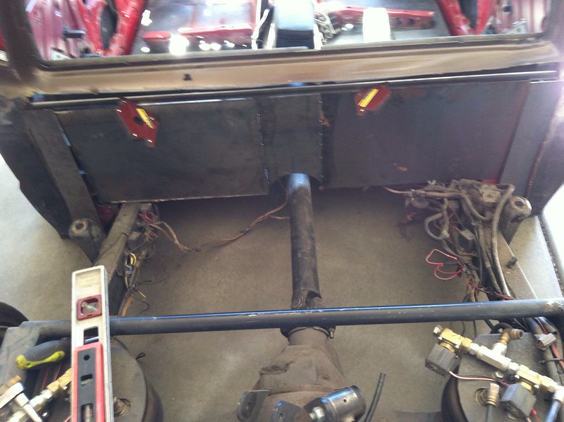

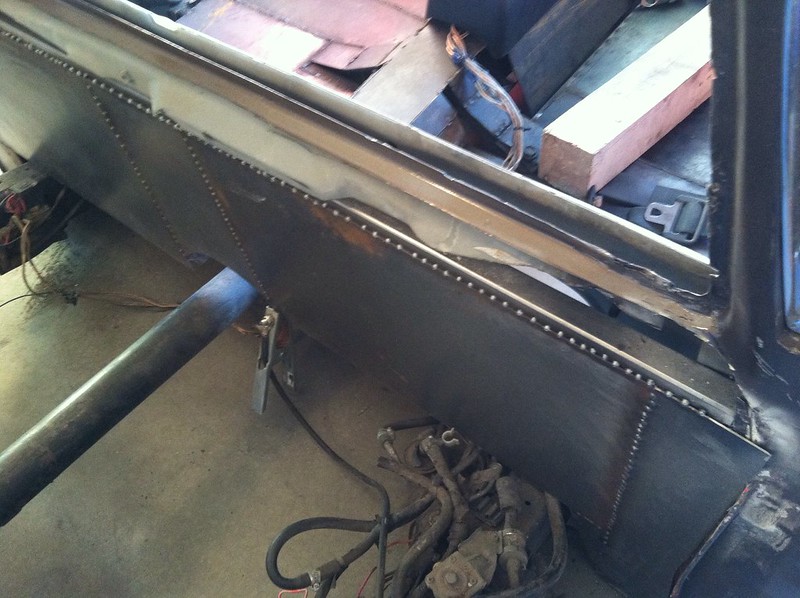

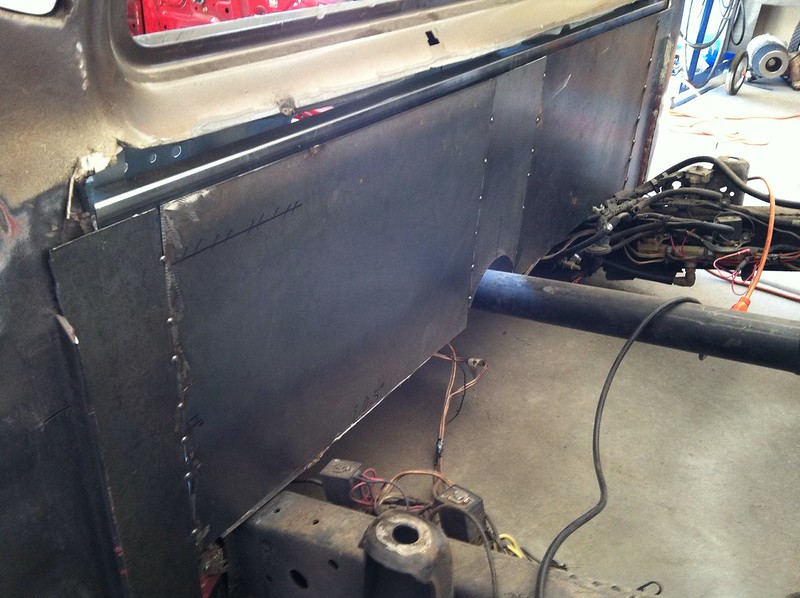

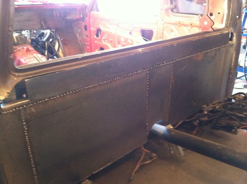

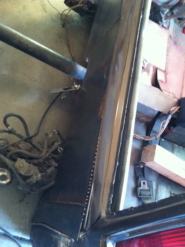

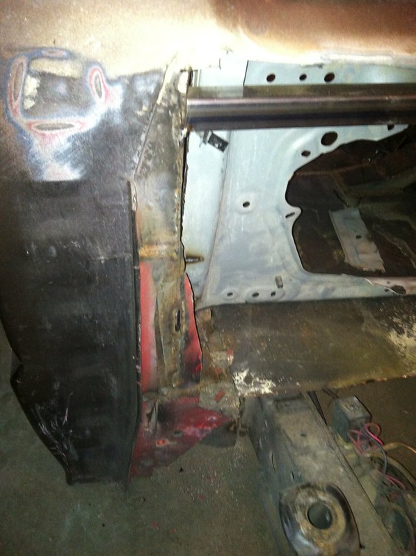

so i wasnt happy with the way the back cab wall was so i cut it back out and decided to start fresh.

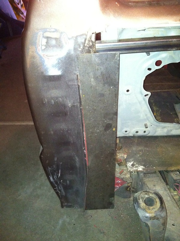

the 4runner rear hangs out over the back cab wall so it needed to be trimmed and pulled in to sit flush.
outside trimmed. need to trim the inside.
yep.

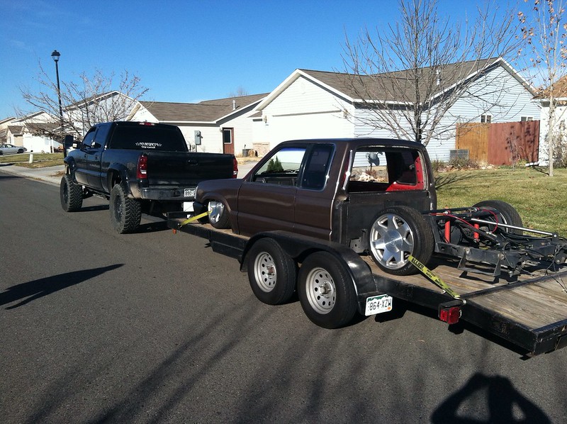

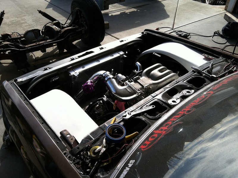

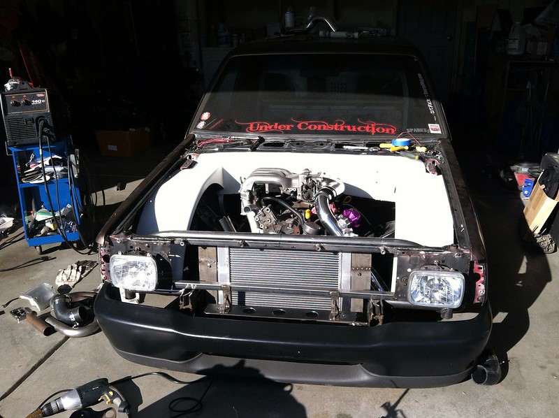

so i have been talking to a club called No Regrets for awhile now about petitioning to be a member and i had to take my truck to Denver so they could see it and i could get my logo so i decided i needed to get as much bare metal primered as possible since it would be on a trailer over the passes in the middle of winter.
made it about that far before ups showed up with my new packages.

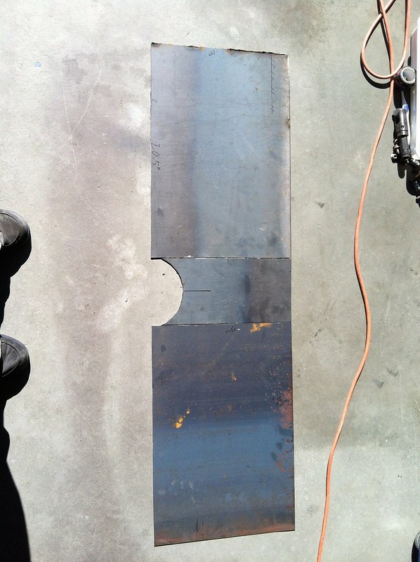

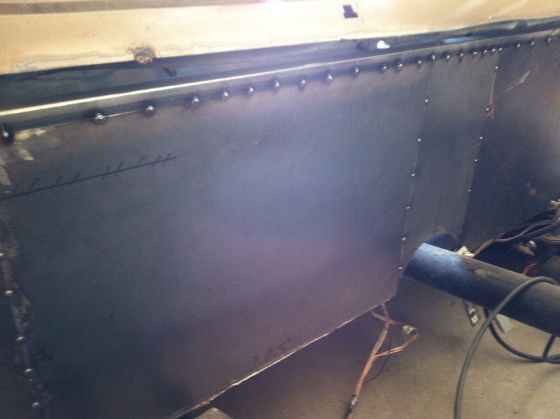

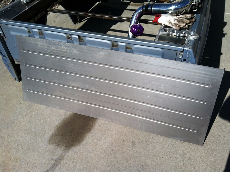

new bead rolled sheetmetal for my cab floor. i decided i want to redo it since i need more headroom.

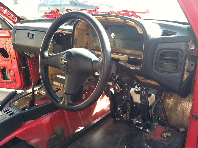

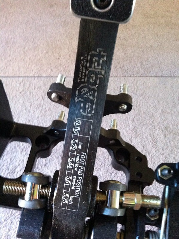

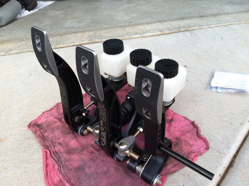

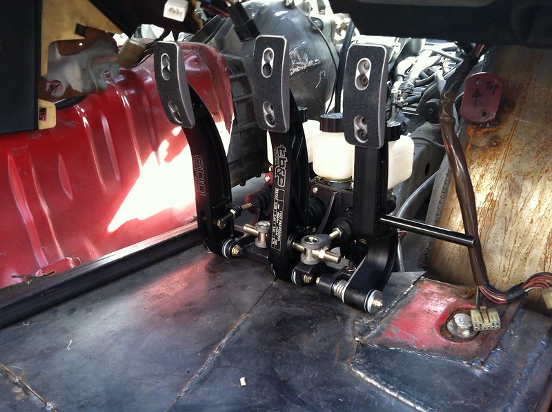

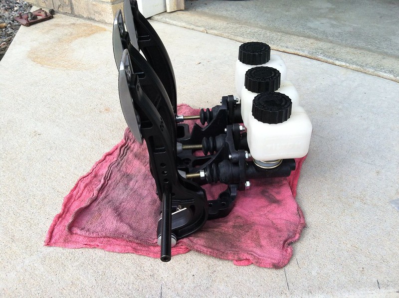

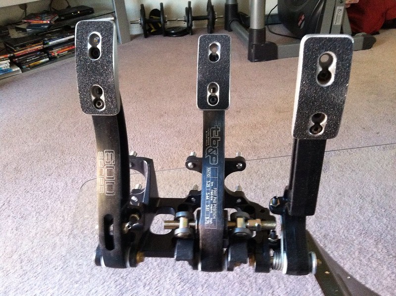

Tilton floor mount pedal setup.

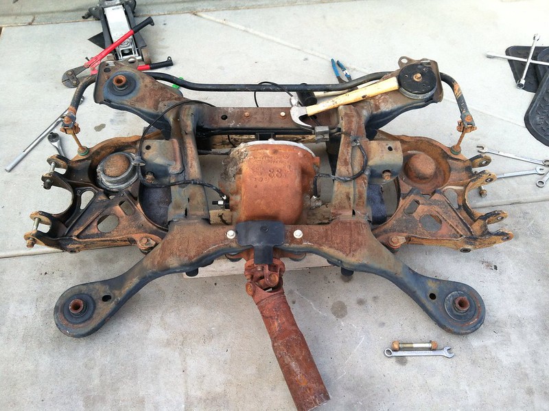

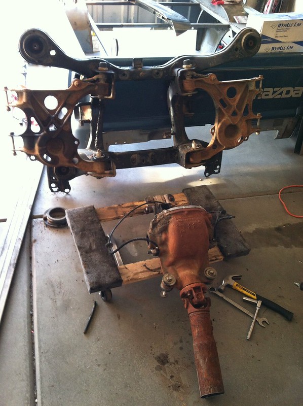

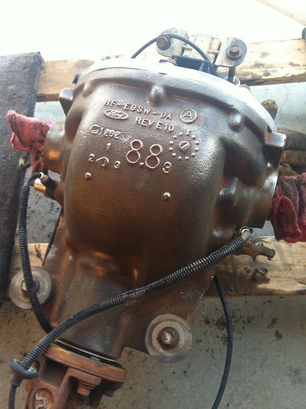

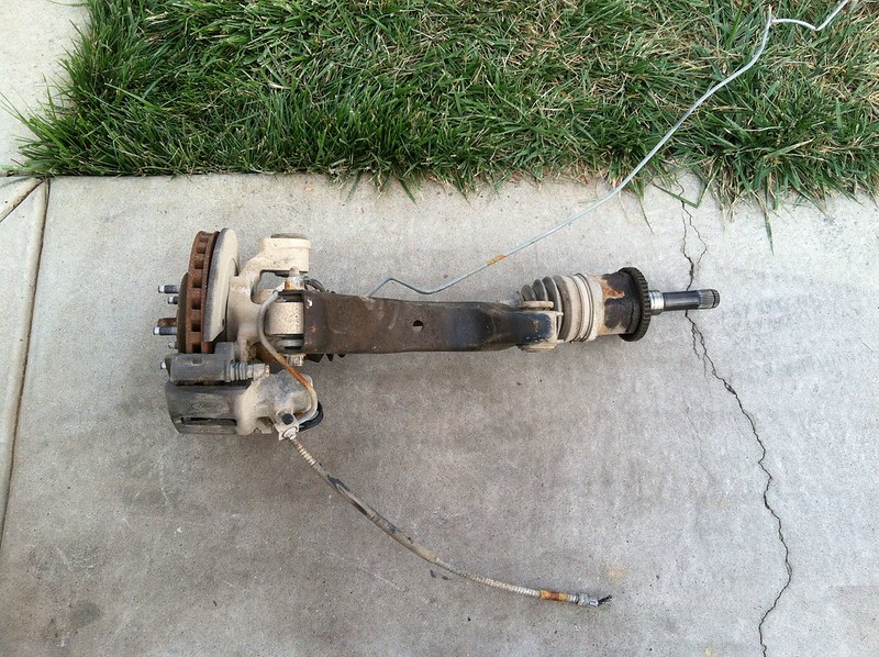

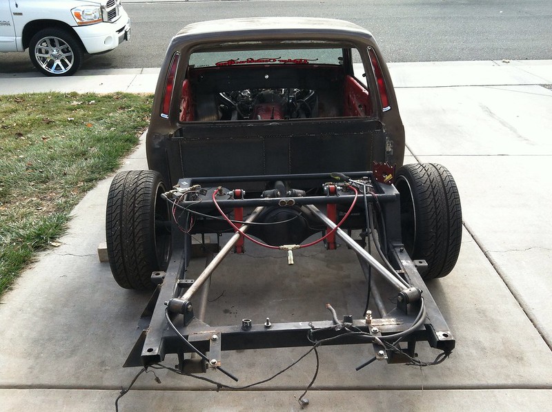

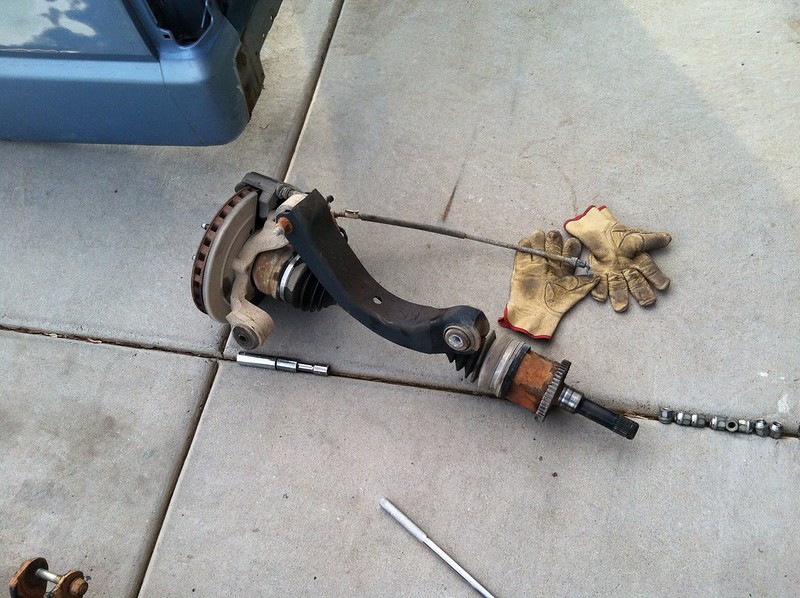

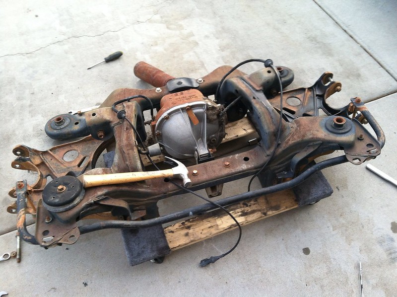

so im not sure if i posted up my independent rear suspension setup that i picked up for this truck or not.
5 lug irs from a Ford Tbird. 8.8 rear end should be good enough for what im doing...
pulled the axles and such because i have to take a total of 6" out of it to make it clear the bedsides...

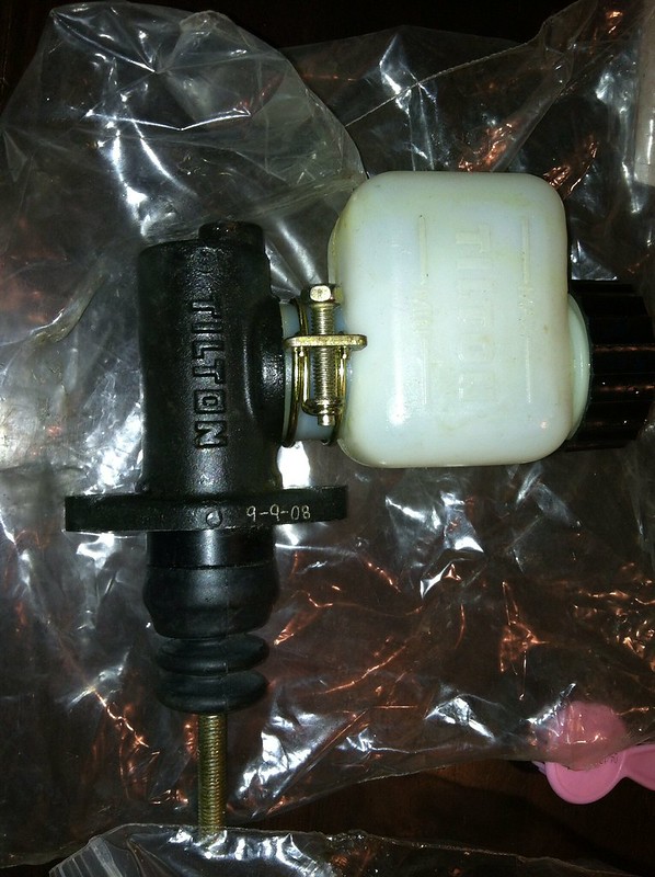

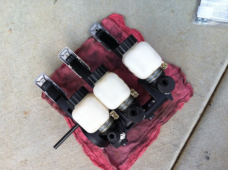

my tilton m/c's

m/c's on the pedal assembly

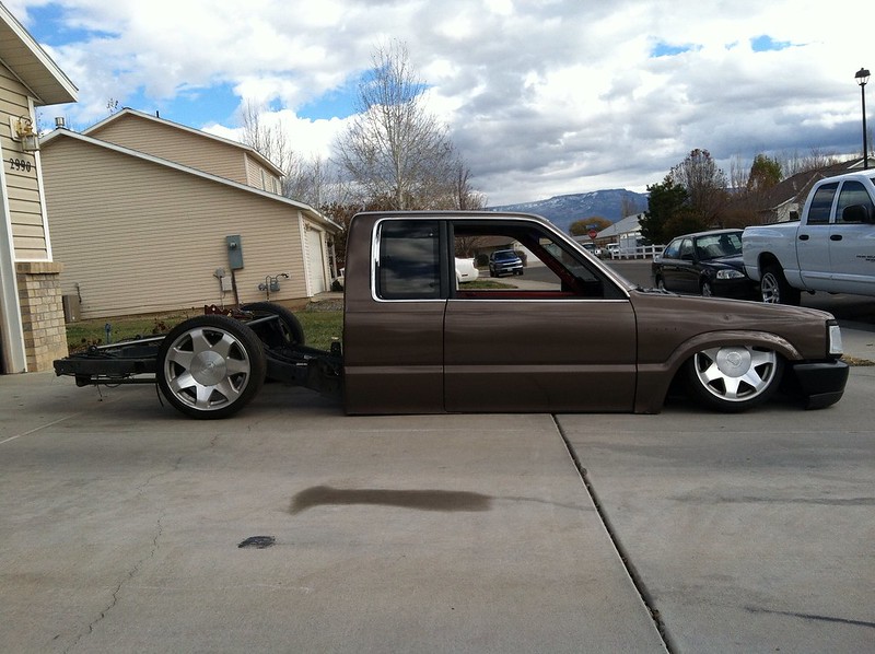

bad nighttime pic to show how low i am...

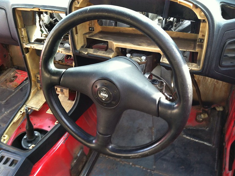

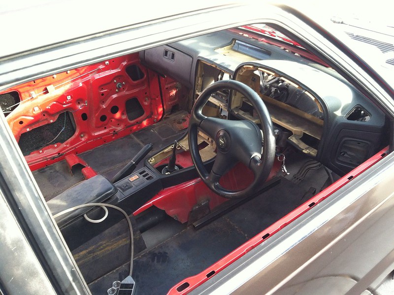

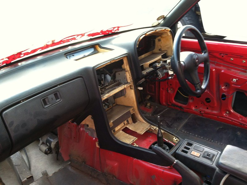

dash and steering back in. fully functional rhd steering for the first time with new balljoints!
jdm efini FD steering wheel.

headed to Denver

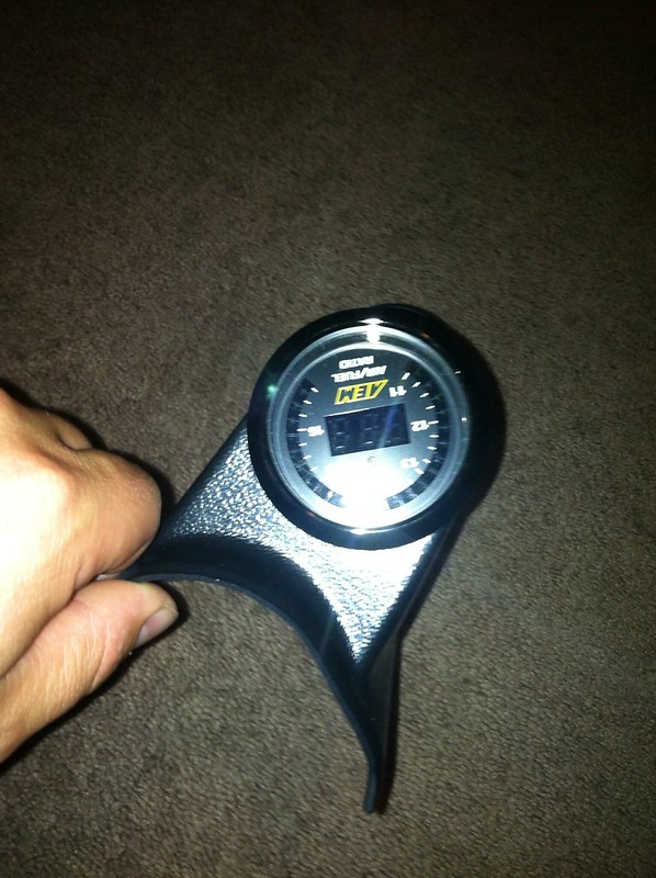

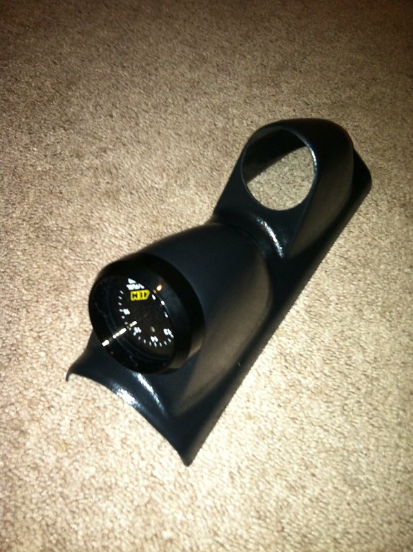

got my rhd gauge pod in and installed my aem uego gauge.

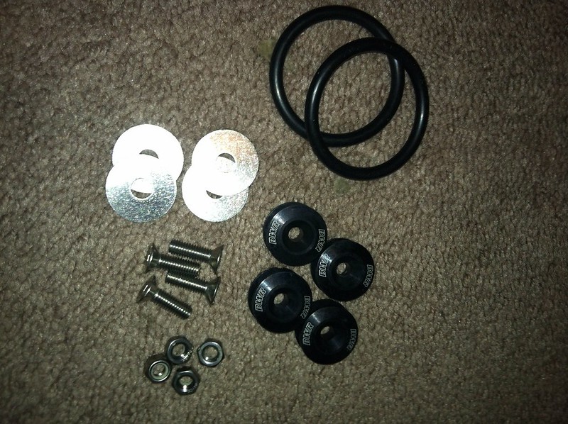

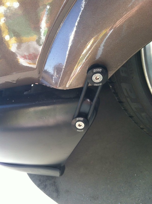

the corners of my ranger front bumper were sagging and i couldnt figure a good way to lift them up. then i decided i would just get the bumper quick release so i picked up these bwr ones. not a huge fan of bwr stuff, but i figured these would do the trick!
cool picture i took while in Denver of my buddies car and my truck in the background.
bumper quick disconnects installed.

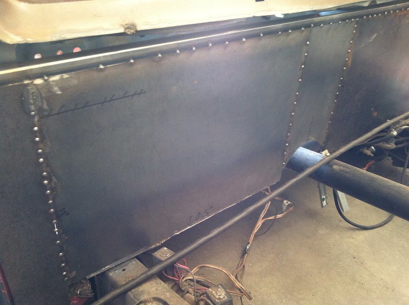

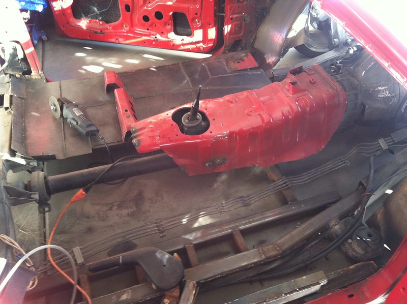

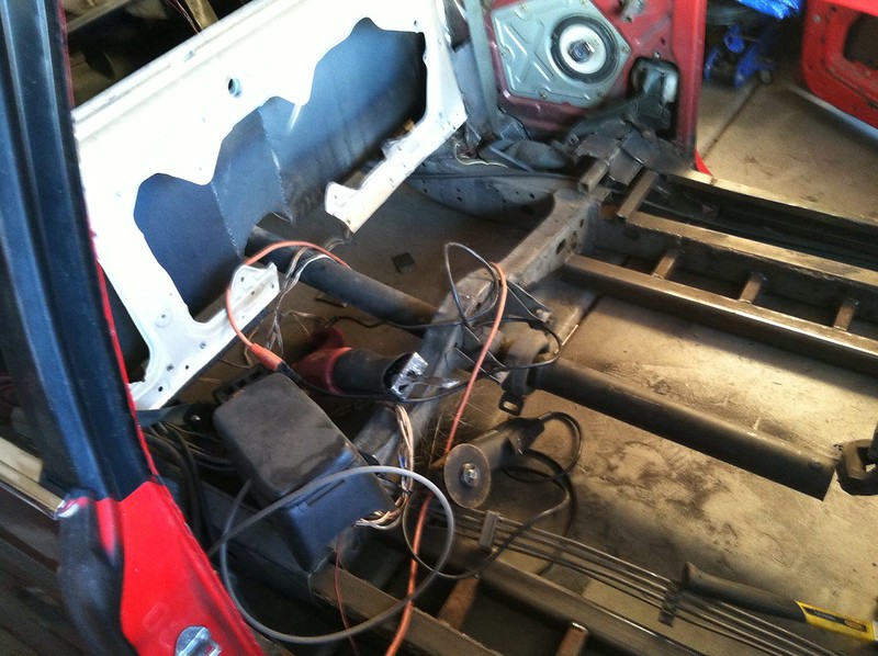

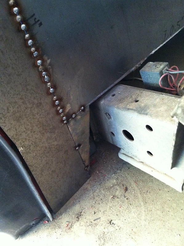

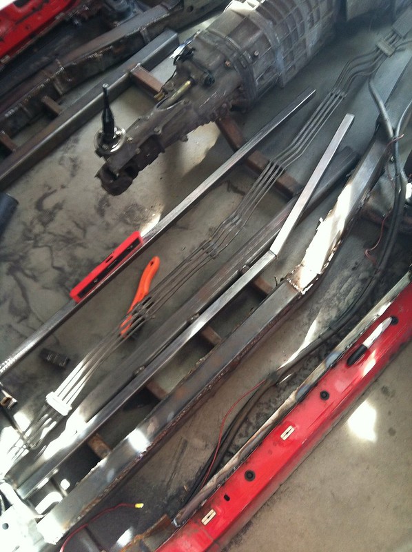

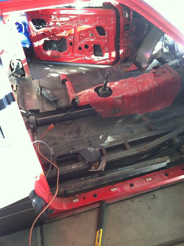

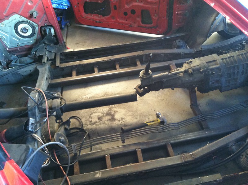

cutting the old floor out.

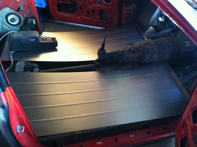

new floor layed in...

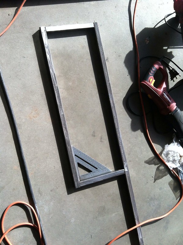

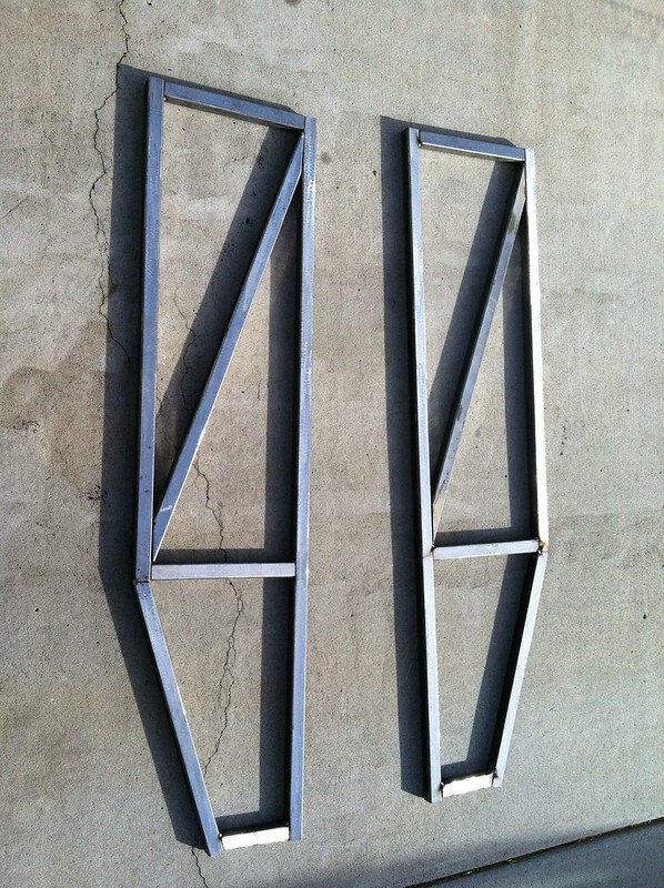

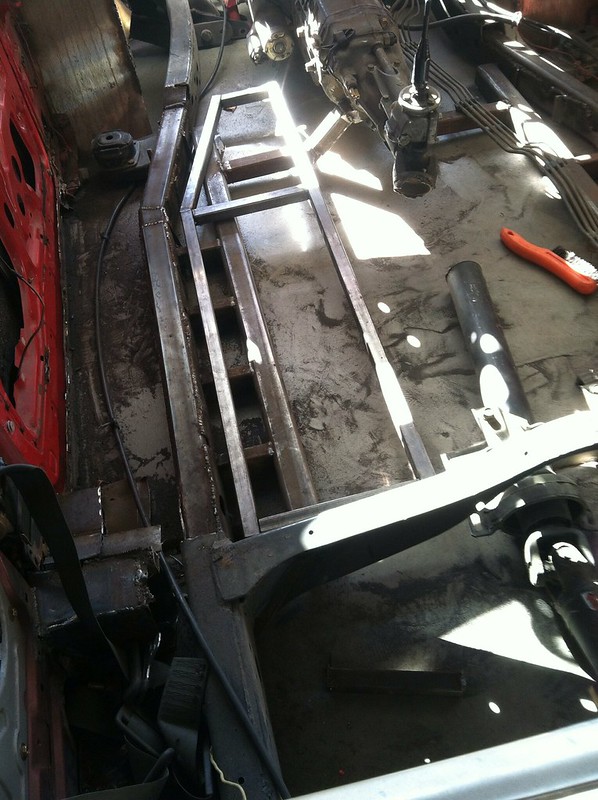

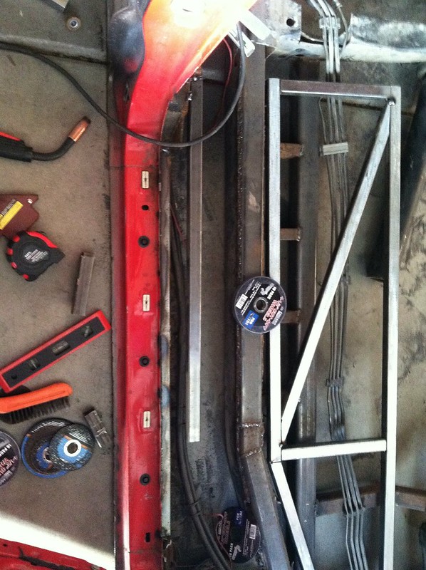

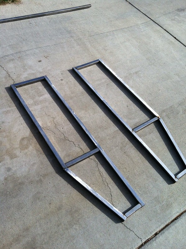

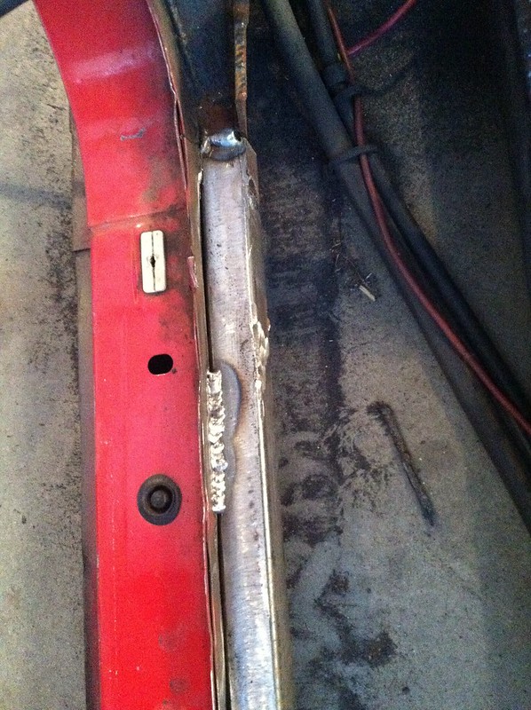

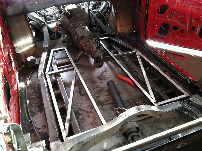

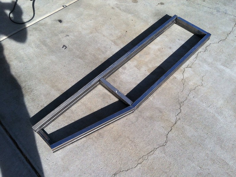

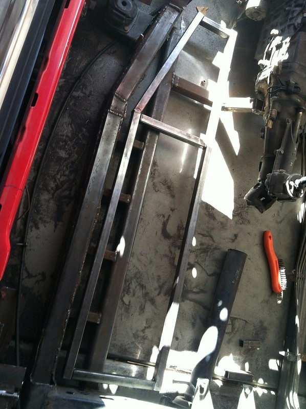

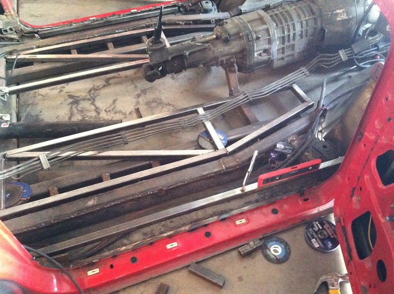

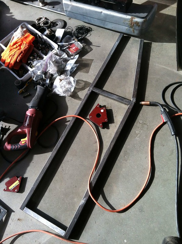

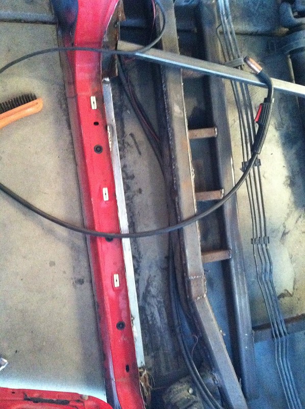

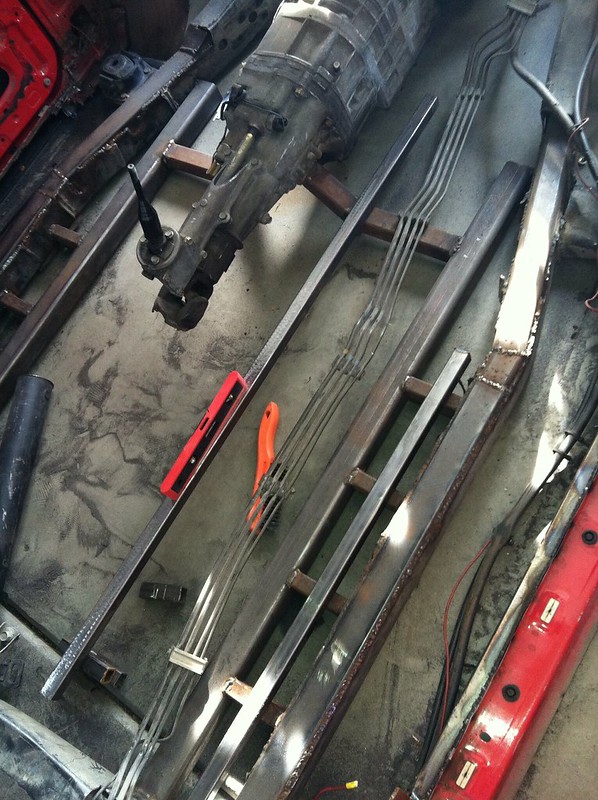

welding in the new bracing for the floor. the idea is to get back about 2 inches of headroom from the previous floor.

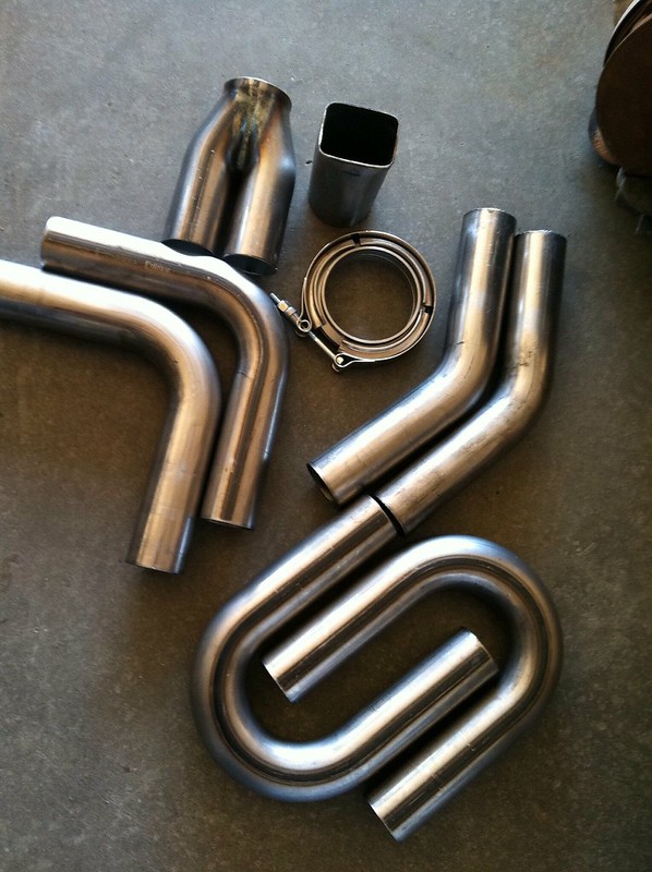

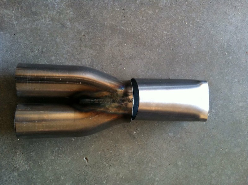

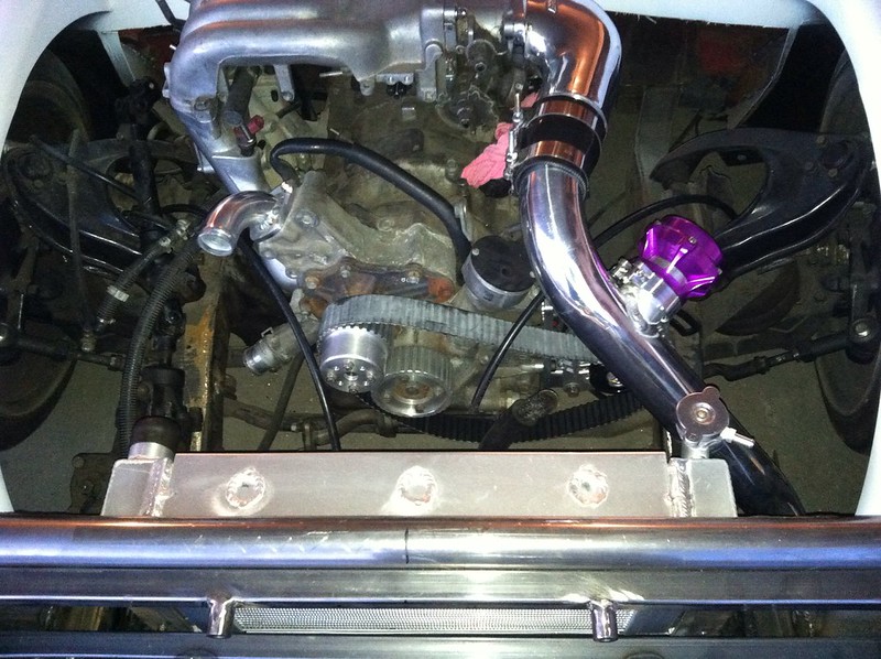

got in my stuff to redo my turbo manifold from Columbia River Madrel bending.
more progress on the floor bracing.
