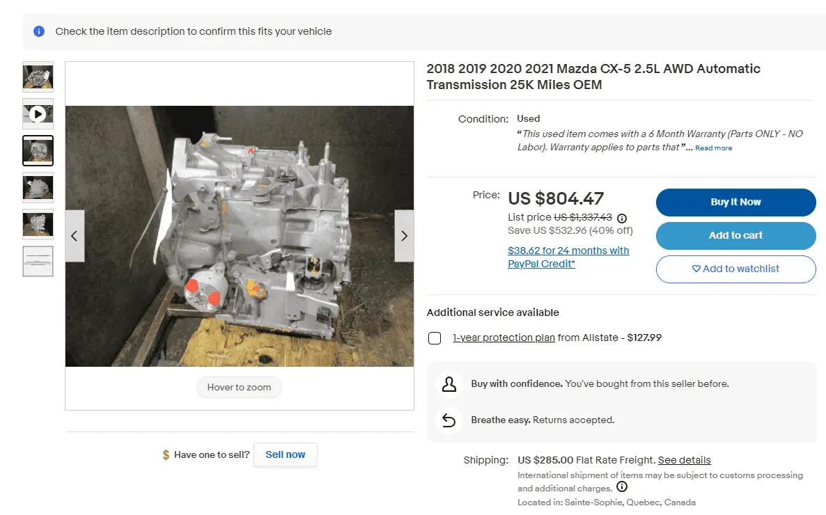

I am interested in replacing the transmission or getting a rebuild done. How much would it cost parts/labor for a new trans? And could I just order one from Ebay like the one below and have it installed for a few hundred bucks?
What would be the best option here?

I would imagine at least 4-10 hours of billed time to install any transmission. I frankly wouldn’t trust any transmission installation that cost only a couple hundred dollars.
I couldn’t imagine any shop willing to warranty as well for that amount.
Transmission are back ordered so don’t know cost but will be $3-4K or more
Bear in mind transmission shop is not going to warranty that $800 eBay unit either
