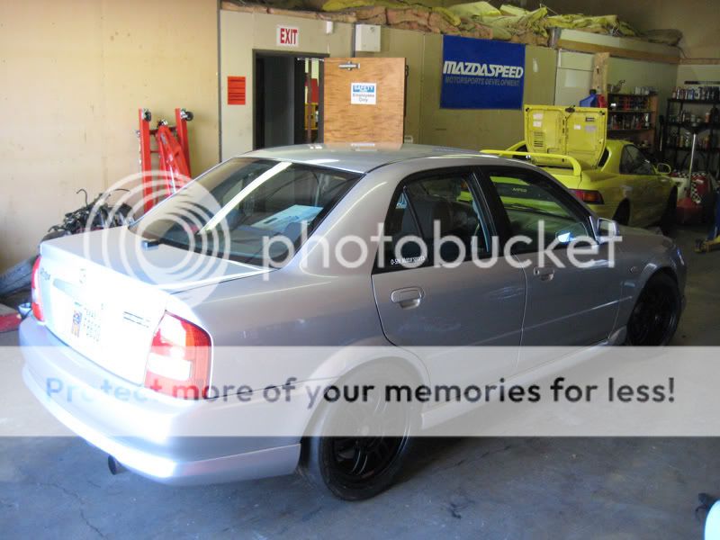

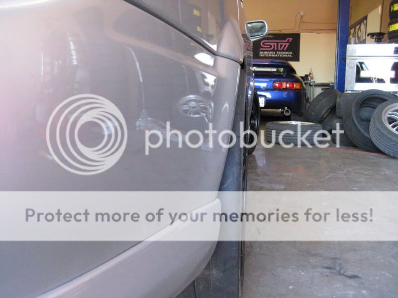

Also, mounted the tires onto the new wheels last week at my buddy's place. They fit ok, the rear fenders need a little more massaging. I may need to raise the car a bit before I go to the new/stiffer setup. Rear camber plates are a must now.
