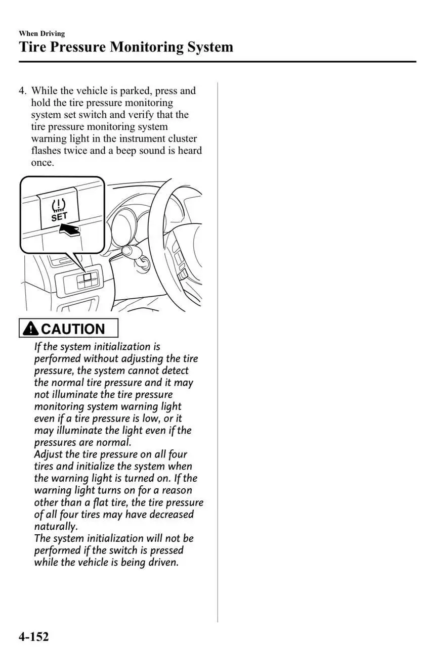

A 2016 uses the ABS system to sense a low tire rather than individual pressure transmitters inside the tires like 2017 and beyond.
For your system, adjust the tire pressure to your favorite PSI, then with the engine in "run" parking brake on, press and hold the TPMS button until the dash light flashes (I think there may be a tone as well)

You want to adjust the tire pressure to Mazda’s recommended 36 psi (19” tires) or 34 psi (17” tires) COLD, and after the tire rotation if you plan one soon, then do a proper TPMS reset stated in owner’s manual, or the system may not work properly. You don’t have to start the engine and just turn the ignition on. And the TPMS Warning Light will flash twice and a beep, when you press the TPMS Set button.
