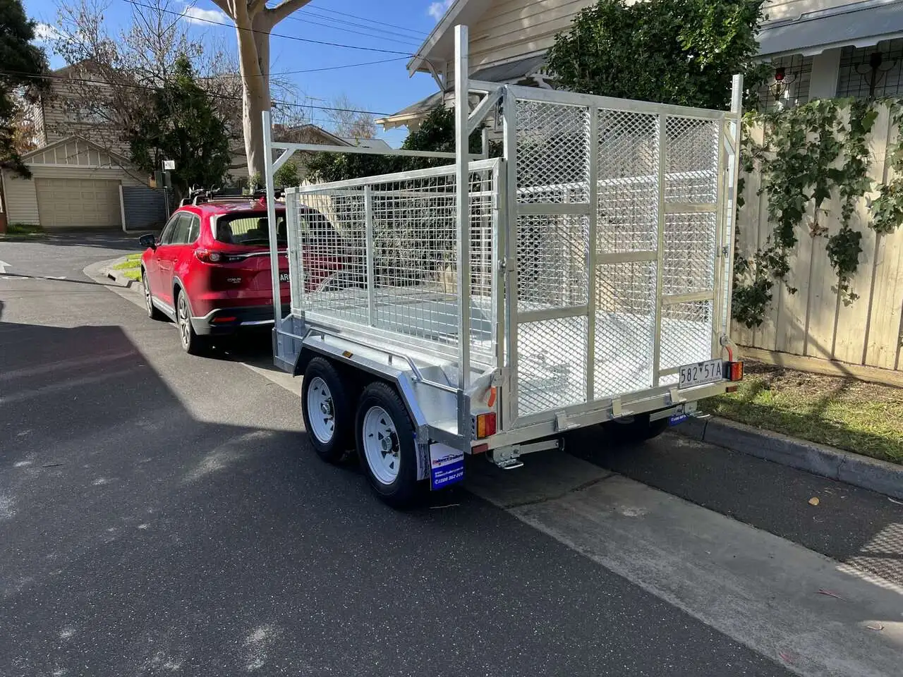

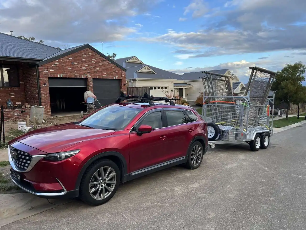

I ended up buying myself a new trailer, got one with electric brakes. Mazda Australia fitted an electric brake controller when I bought the car. Think it’s a red arc one. Overall, the set up works very well.
I still need to get the reverse light sorted out, as they are not wired up to the socket on the rear bumper.
