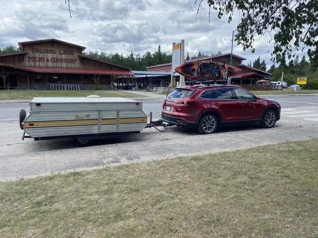

I have a 2019 CX9, and am planning on getting a camper for the upcoming summer. I am trying to decide between a tent trailer and a R-POD 172t.
When I was looking at some other vehicles, they had towing packages that included a transmission cooler. Has anyone installed one on their cx9?
The R-Pod will have greater wind resistance, and greater side windage in gusts, than the tent trailer. It is also over the car's max towing weight when loaded to the trailer's GVWR, 3760#. A weight distributing hitch as noted in post #26 above will level the car due to the trailer's relatively heavy tongue weight (think of a 376# guy sitting on the back of the open hatch). So...be prudent when loading it and when towing at high speeds or in cross winds. You will also need an electric brake controller for a trailer with electric brakes.
Trailer brake requirements vary by the state you're driving in. Some are as low as 1500#. In any case, I'd want trailer brakes if the combined car and trailer loaded weight is greater than the CX-9's gross vehicle weight rating, 5816#.
I haven't heard about an additional transmission cooler added to a CX-9. A small one might fit somewhere...good luck finding the spot. My preference is the Hayden 696, their smallest of this type. These are sold under a variety of labels. The tell-tale regardless of brand label is their "internal bypass" to prevent cold ATF from being cooled even more. The Hayden 401 might be even smaller, but without the internal bypass. The last cooler I added I put on a manual 3-way valve to shut off the additional cooling when not towing...ATF needs to be normally warm for best transmission operation. Hayden's catalog assistance number is 1-866-502-0068.
I am looking at one of the earlier models of 172 or 176. The early ones have a dry weight between 2,200 and 2,400 lbs, with a tongue weight around 250 lbs. I am certain that based on how I pack, I will stay below the maximum towing weight for the vehicle
I plan to use trailer brakes and a weight distributing hitch.
Am I headed for trouble with this plan?

I have a A-frame pop up, around 2800#. I have towed to Florida from NC and I have gone up and down the hills in NC and TN. I have not had any problems. I use a sway bar but not a weight distribution hitch.
I had planned to buy a bigger trailer this year, but I ended up being uncertain if campgrounds would even be open this year. By the time they opened, I decided to hold off, and instead did some repairs to my parents 1974 Trent trailer. CX9 did well, but this old trailer does not tow terribly well. In hindsight, I think the surge brakes were sticking occasionally.
