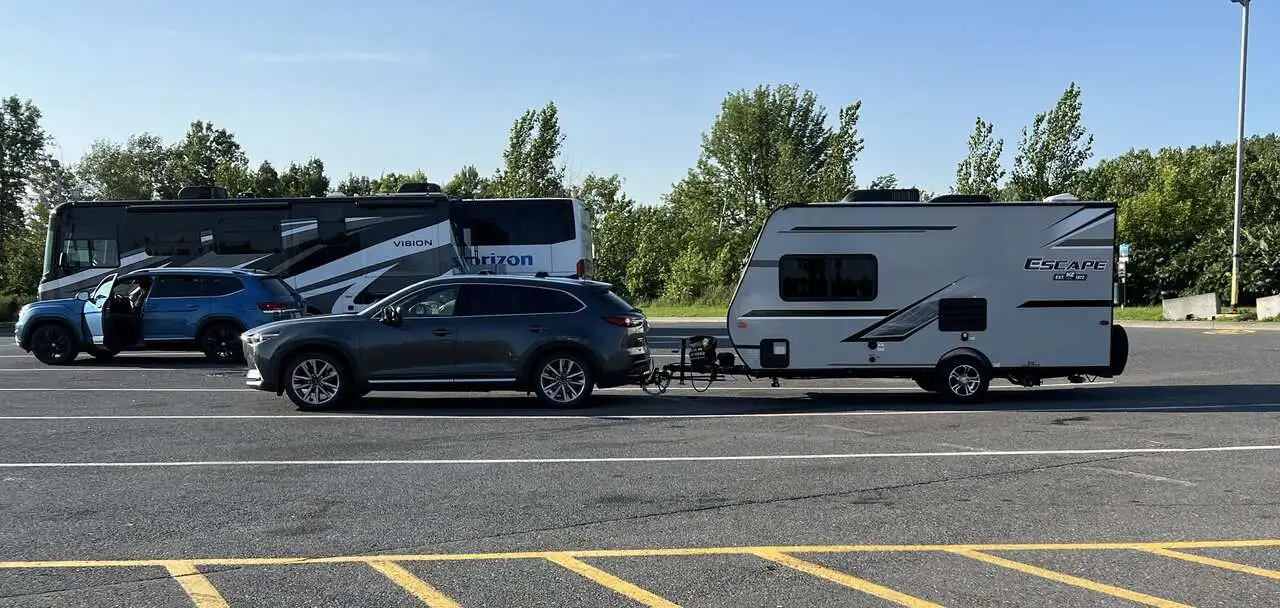

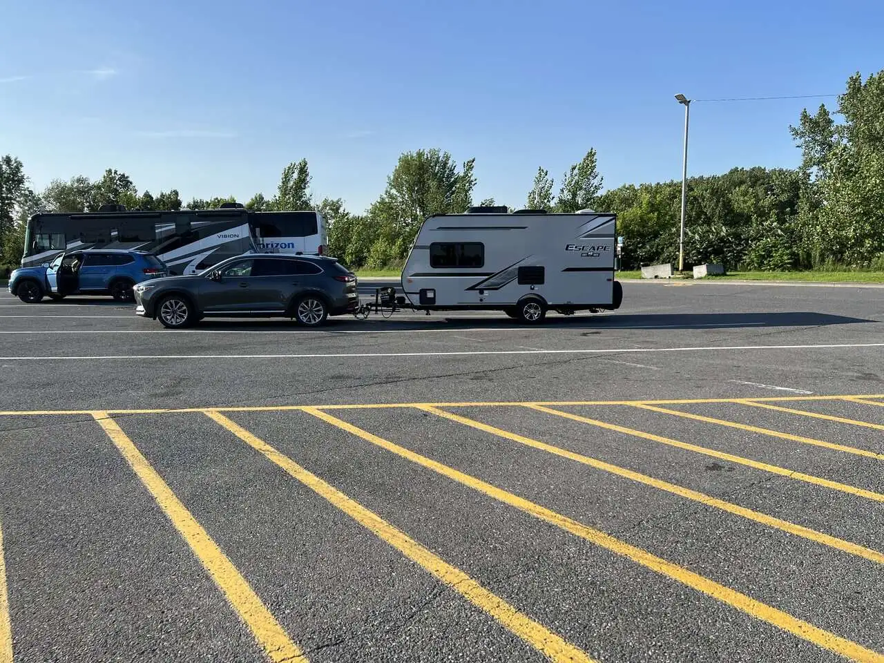

Towed this trailer over 500 km each way for summer vacation:
In hindsight it may have been slightly overweight with luggage and passengers, but i made sure the tanks were empty and i knew the road there was flat and straight.
The Cx-9 handled it fairly well. I could feel the trailer but the engine wasn’t struggling. The suspension felt a bit soft for it with a lot more up down motion than usual, but the trailer distribution hitch was rented and not perfectly adjusted.
I used 91/93 octane for the trip in case i needed the additional power, kept the speed at 100km/h with the occasional stint to 110 for passing. I also used 5th gear in manual mode for cruising to give the engine a slightly easier time, 4th gear for passing on the highway and automatic in sport mode in town. Cruise control seemed to struggle a bit so i drove it manually.
Were you using a Bluetooth Brake Controller by any chance?
The controller was a tekonsha prodigy RF brake controller. Similar to a Bluetooth controller in that it does not need a brake controller installed in the towing vehicle. But instead of using an app on the phone it uses a dongle connected in the cigarette lighter plug to adjust the brake setting and to brake manually in case of emergency.
I don’t know if Bluetooth is better or not, this one was provided with the trailer which is why i used it. I don’t have a brake controller installed in my CX-9.
