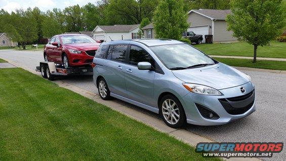

Actually, I never said I towed with the 5. I have been advocating never to tow with the 5 at all, lol. As for the hitch, Mazda themselves and local shops (like Burnaby Hitch) only have a tiny 1 1/4" hitch for the 5, which I would Never tow with, regardless of vehicle. I was saying I was fully loaded and "The 5 could not handle even a tiny 700lbs Boler trailer at that rate." comment was; could you imagine a light Boler at the same time? I had a 2" hitch on a previous CX-5 with my Thule Helium bike rack, the bikes never swayed. On the 5, there was a lot on flex on the 1 1/4" hitch with just 75lbs on it!
As for the trip we went on, just to be clear;
16cu ft roof box: 4 folding chairs, 4 sleeping bags, a 14x14 shelter, inflatable mattress = just under 70lbs.
2 adults = 300lbs
2 kids = 150lbs
gear behind the 2nd row; clothes, tent, 2 tarps, cooking gear, portable battery and misc = 300-350lbs
2 bikes + Thule helium, 25lbs each approx. = 75lbs
total approx 910lbs.

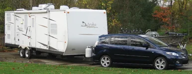

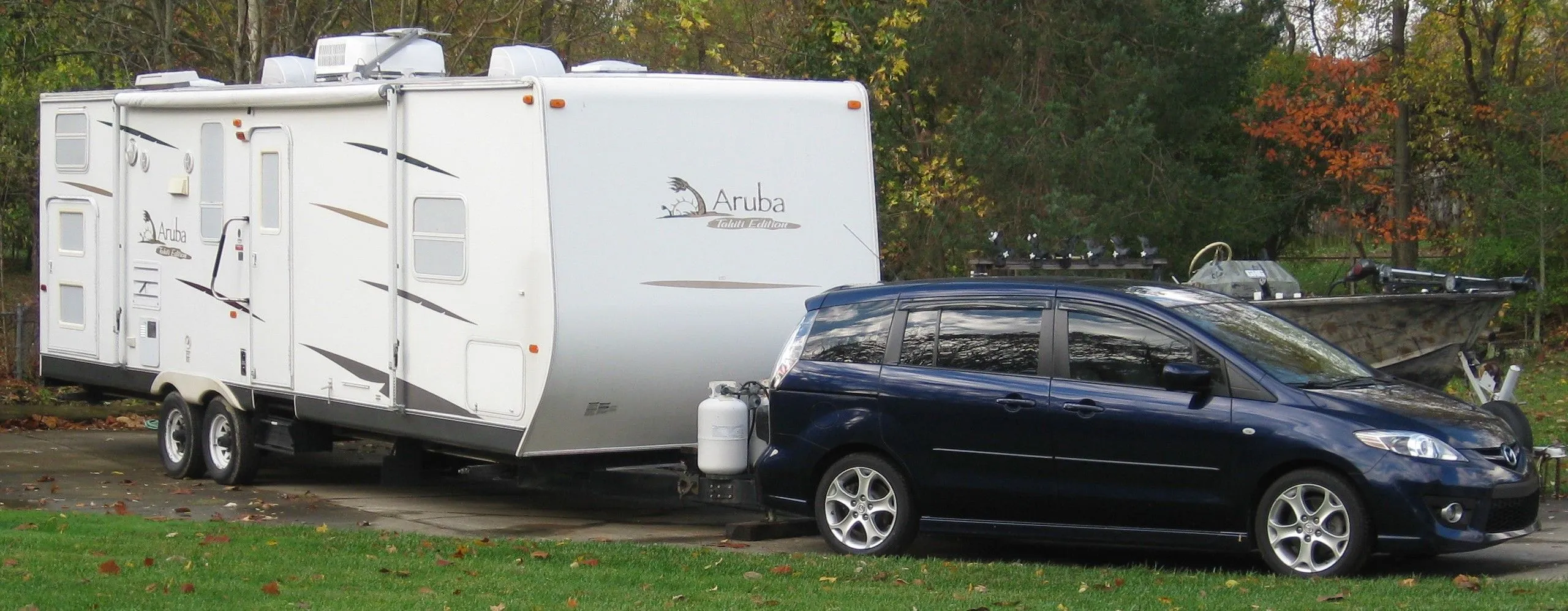

I really hope, for your safety and others on the road you get pulled over and told to drop your trailer. Saw a few instances of that on our 2 week road trip a few months ago, they don't tolerate it here. It would be a lesson but a good one.
Can't image, even if it was rated to do so, towing with a 5 around here. Our family of four 450lbs plus gear, what type of trailer would I tow? May as well keep on tenting. The mountain passes and hills around here would kill the 5. I had a CX-5 GT that could tow 2000lbs: just not enough to carry a trailer to sleep 4 people.
Saying this I have looked around a lot for a trailer for my Edge. Finally found one, Palomino Basecamp 8b (could have gone to the 10 series at 1900lbs but the extra 2 feet of floor space wasn't noticeable, the $6000 CDN difference was!), dry weight is 1631lbs and gear, food, water, etc, plus family of 4, even if that totals about 1100lbs we are still about 800lbs under total weight.
I just shake my head when people think they can get away with towing when the vehicle is clearly not capable of doing it properly and safely. I don't care what other counties do or say, I'm in this country which says the 5 can't tow.
People think because you can physically attach a tow hitch and produce enough power to pull it that it's OK and safe. On one hand I'm shaking my head in dismay, and on the other I realize it's a different era and people don't know any better. Shops installing tow hitches instead of telling people to go home and hug their children make matters worse.

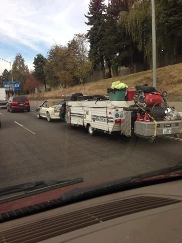

We enjoyed our trip out west so much using the 250lb motorcycle popup camper that we decided to make a trip to Maine to see the fall colors. We took something a little larger this time. Got to say that the 5 wasn't the fastest going up hills but coming down it could easily hit 100 mph. Lets talk about gas milage. I'm glad it's a auto. If it was a stick every 100 to 150 miles I would had to stop and take gas out. Only time I really had a problem was when the front wheels lost contact with the road because of the high tongue weight. I like it when the wheels would come off the ground going down hills. The front end raise up add acted like a wind brake to slow the 5 down. Just so happens that next week my sister-in-law is having her house relocated. We're going to move it with the 5. The house is only a two story so it shouldn't be much trouble. Why use a overrated semi when you have a 5.
That's a great photo and definitely not a 250 lb. pop up camper. :D
I like the bit about the front wheels coming up. I have to say the only time I've experienced that is in riding wheelies on motorcycles, never in a car. :D
