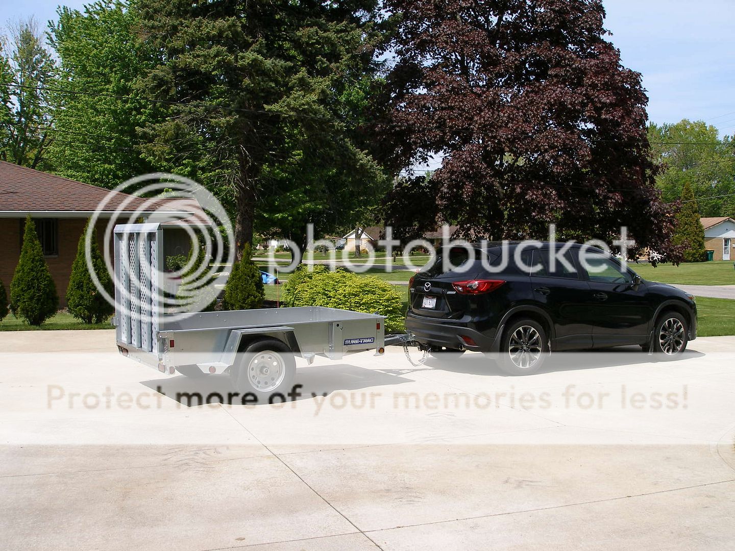

I have used trailers for 45 years. I have studied trailer design, and I have designed and built a few.
Probably the most important thing is to have 10% or slightly more of the traile weight on the hitch. This goes a long way to prevent trailer sway.
A long distance between the hitch and axel help, and it makes it much easer to back up the trailer. It is nice to have a tongue that is over half as long as the width of the car so you don't hit your own trailer when backing up.
Having the trailer level is irrelevant except to keep 10% of the weight on the hitch. Of corse it looks better and it is easer to secure the load if it is level.
Wheel size only effects tire life and how the trailer handles bumps. I often design a trailer with small wheels because I can get them under the trailer bed. This has some advantages for a utility trailer or any trailer that sees rough use. The fenders don't get beat up and the trailer don't have that wide spot that you need to look out for. If you are going to go London distances or at high speed on rough roads and you have room for big wheels they will be a bit better.
Summery, get 10% or more of the weight on the hitch, keep the running gear in good shape, the other stuff are details.

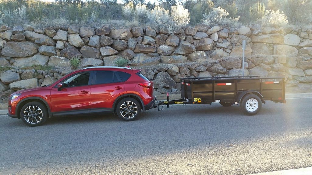

Did my first real towing yesterday with a load of mulch and a load of stone. Both were well under the maximum weight ratings and the Mazda did fine. That said I would hate to be carrying a load at or above the limit as I feel the brakes are not up to the task. They were fine for what I was using it for but I would hate to have 2500 pounds and have to brake hard on a long hill.
For my use the Mazda is a great tow vehicle but I am pulling 1500 pounds around town, not trying to pull 2500+ on vacation.
