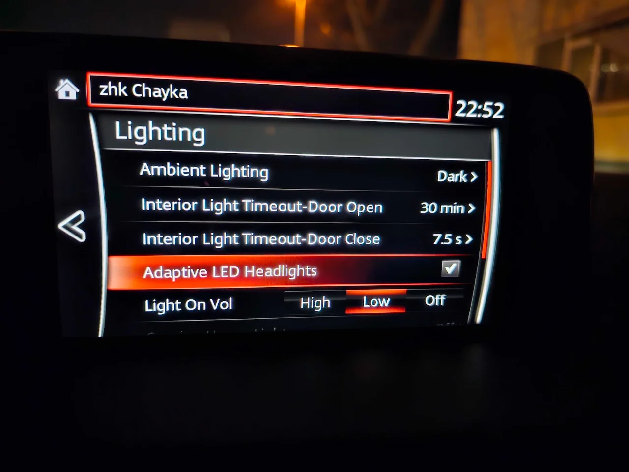

Hello everyone. I am facing an issue after I performed an update to the system. Little information and background:
I have a 2020 CX-5 Mazda, with a 7-inch infotainment system and matrix-led headlights, and I am from Europe. My vehicle was with 70.00.335 EU N and like many folks I requested the latest one. I got the file and successfully performed the update to the EU_74.00.324A. Did a factory reset after the update and I can say that it is a lot more responsive than it was before. However, one thing is not working as expected and it happened after the update - the Adaptive Led Headlights function does not turn off individual LEDs when I am driving on high beams anymore and what it does now is just switch to low beams instead of turning LEDs where the other vehicles are.
I have Adaptive LED headlights enabled, the camera is clean. I did another factory reset and still the vehicle does not want to turn off individual LEDs anymore.
Does anyone has experienced this, does anyone have any suggestions on how I can make this work again?

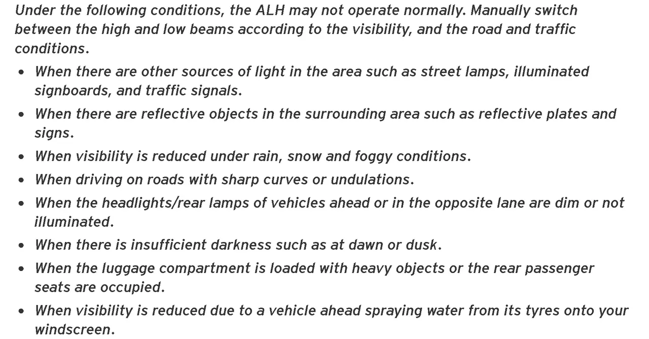

Yes, I read all this info in my manual as well. I think it is not operating normally because I am testing it on the same road and in the conditions in which it worked. It just suddenly stopped doing that. Thank you for posting that.
I have an update. After another unsuccessful test on the same conditions, I disconnected the negative terminal of the battery for about 10 minutes. The very same night I went out again on the same road, same hour, same weather conditions and settings and it was and still is working as it was before - the vehicle operates on high beams with turning off only individual LEDs where other vehicles are detected. I am not sure what is the connection here but I think this helped the system to start working again as expected.
