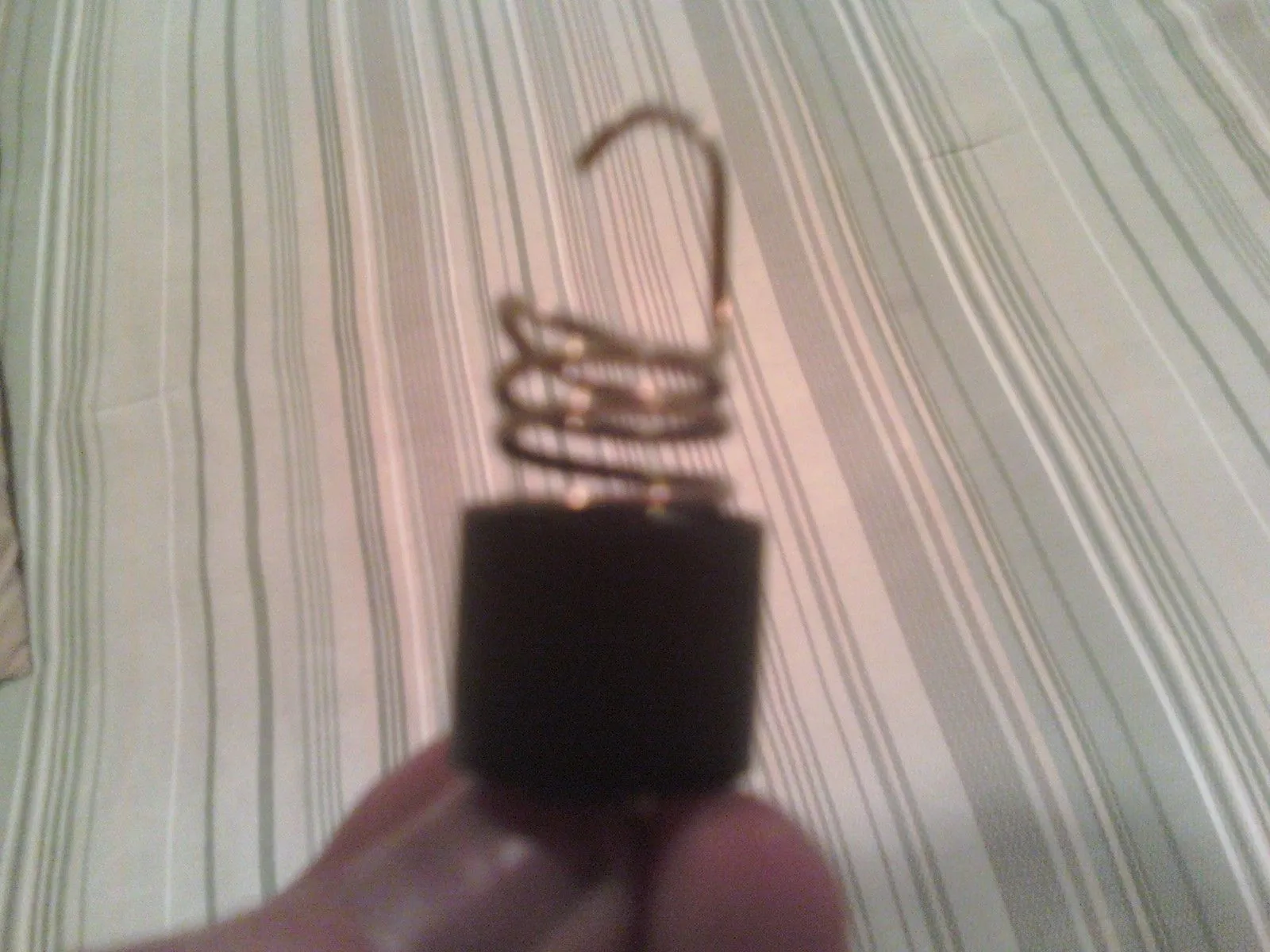

Here is a picture of the Tensioner and you should be able to clearly see an Allen key hole. That is where the Allen key goes in and is used to apply tension to the system when putting the spring on.
PS. It's probably more like a 4mm than a 6mm
