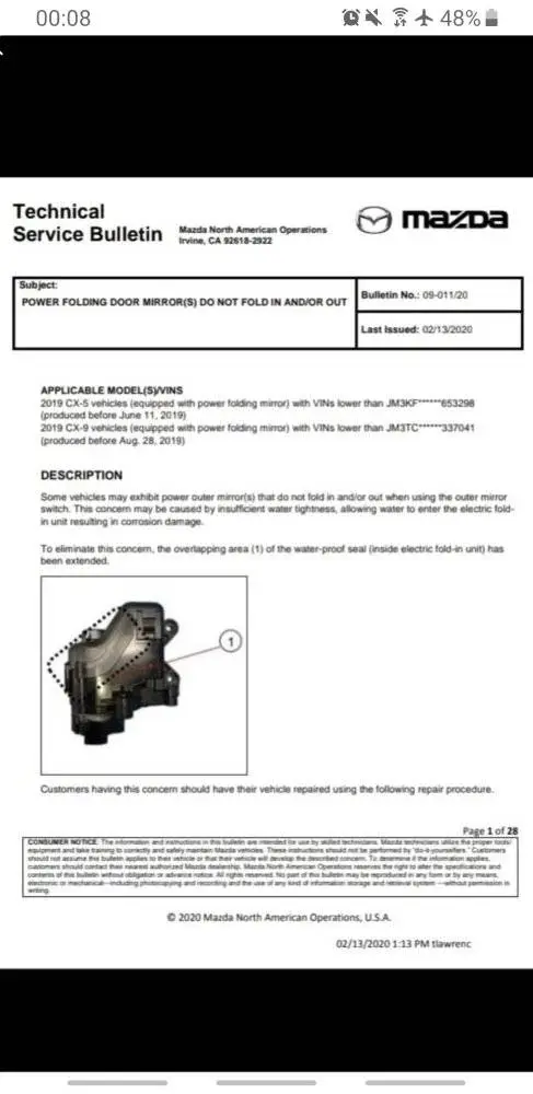

This is not cause to distrust turbos. Just be leery of first production years of anything. Mirror motors come to mind...
This is not cause to distrust turbos. Just be leery of first production years of anything. Mirror motors come to mind...View attachment 307056
Ha, power folding mirror failures ⋯
That problem has been going on for years even after many revisions and TSBs “world wide” since 2012 by Mazda on CX-5!
I suggest Mazda simply just get power folding mirrors from the same vender used by Lexus / Toyota may be for higher cost ⋯ ;)
