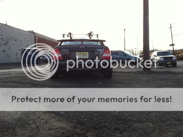

and i wont have the mexi-poke when i actually install. i am going to slot the struts like og did and get about 7* there then add in the rear camber plates and hopefully tuck enough to drop another 1/4-1/2" and then ill pull a collar in the front which should put me level... my ride height at the frame is 2.6 in the front and about 3 in the rear
honest opinion, is ~10* in the rear going to be too much on a protege?
your doing a pull... slotting your struts further than even manufacturers do... adding camber plates to get 10 degrees.... all to fit a 8 inch wide wheel.
dont you feel like your doing something wrong? im not saying what OG did isnt good looking, but dont you think with some different sized(offset) wheels it could look so much better, with less effort?
and yes 10 degrees is stupid.
I have -5 in my rear and no poke yay me :)
All I did was slotted a little and bought 2 camber bolt for each strut
im at about -5 or 6* according to my camber gauge. lol
but -10 is way too much and i dont think -10* is possible or needed. after about 5 or so *, you will need to bend or break off the brake line tab, like I did.
i would have to agree. while I'am enjoying what I've done, Im not sure I would do it again though. I get all kinds of compliments, but it was a ton of work to get where I'am and it still rubs, lol
Drives just fine, but the rubbing may be bit annoying for some. with that, I may be in for a new set of wheels when my return comes in. Might keep the 002's for fun. lol
he said after 5* lol thank god i picked the right size.. even if i don't get adjustable camber struts and can still slot enought to be good :)
I'm at -5 and I didn't have to break anything
