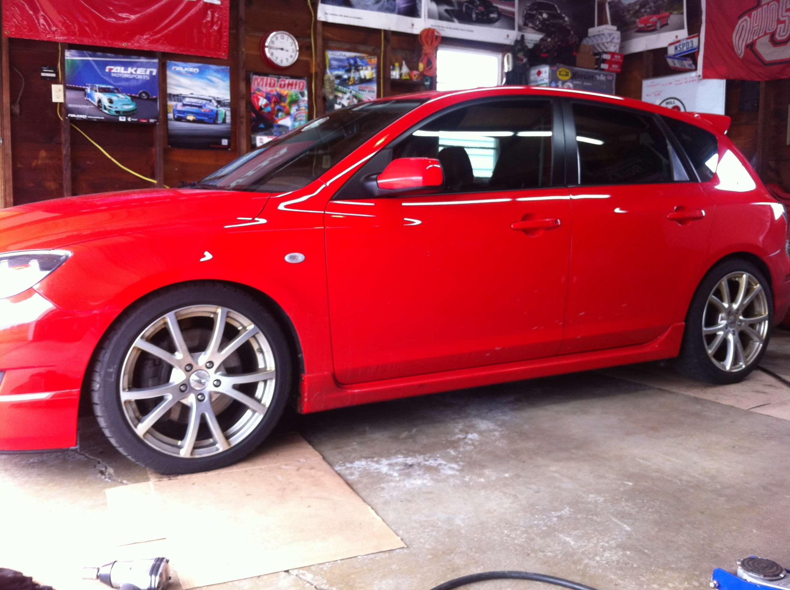

And the final product on the side that isn't broken:
