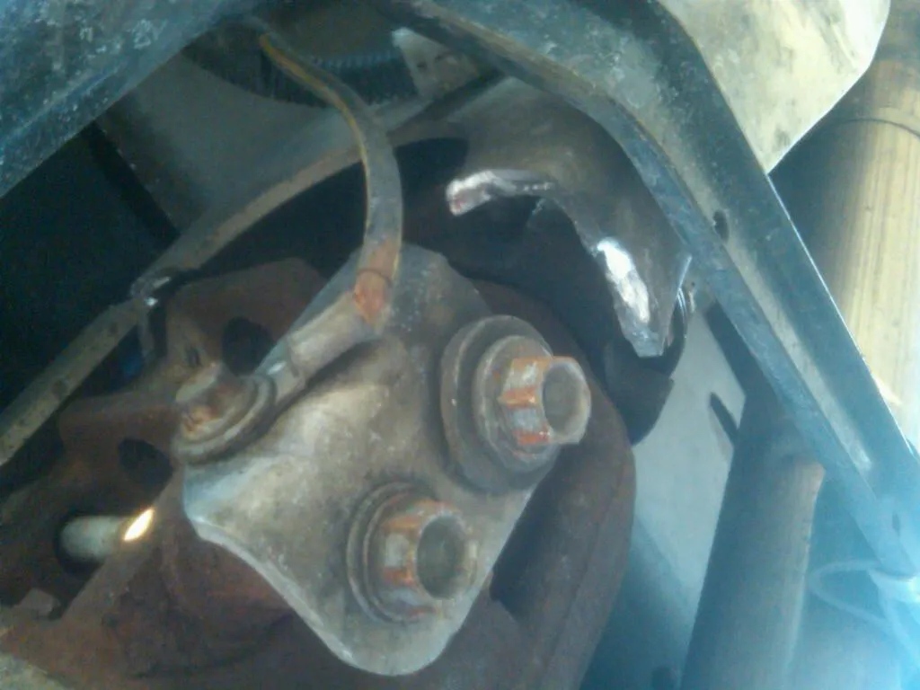

Yeah... PowerPlant Frame (PPF) is what snapped. Dad said it had a crack in it when they did the transmission swap. For all I know, it's been cracked this entire time. Like I said, I wanted to drive it now to try to figure out why I was hearing the sounds, and why it felt like the transmission was moving under acceleration and deceleration.
Good: It broke now and not on a road trip.
Good: Jess has one around the corner but it's hard to catch up to her. I found one online for $30.
Good: Relatively easy fix once the parts are here.
Bad: Dad couldn't get the bolts out of the diff when they did the transmission for me. Said it's going to take a torch and a big impact to get them out.
Bad: I was hoping to drive it this weekend to Pittsburgh.
Bad: My springs just came in today.

For reference, I'll show you what broke, and what it's supposed to look like...
See attached for mine broken.

Umm... not really. Boosted cars tend to break them from time to time... but usually when around 300+ whp.
I can only assume from the amount of crap people give you about the power of your car this will not happen again. Good thing right?
I'm not going to say yes to that because it probably will happen again eventually. Hopefully Jason can develop a quality piece.
So it is pretty common? Judging by the looks of the bare chassis pic it could have an adverse affect on alignment as well. That is if you can't replace it as a simple bolt in. Know what I mean?
Only common if you're making way more power than you need. Mine shouldn't have broken the way it did with my power level. Naturally aspirated cars won't break these unless something goes really wrong. The way my clutch is, I'm sure it didn't help matters much. I get a lot of clutch chatter and wheel hop.
your heavy foot doesn't help either
