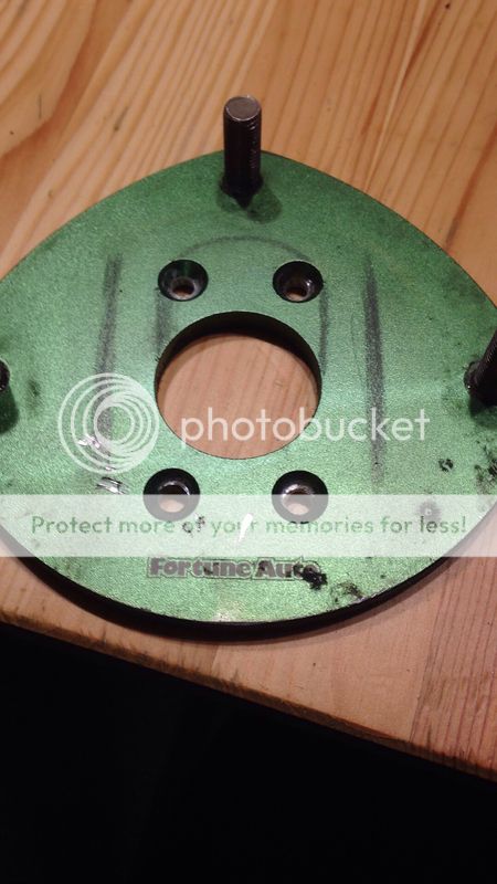

Well since my car is just sitting on jackstands in the garage, I figured I would get to work with all the mods I need to do to get the wheels to fit, one of which is rear camber plates.
Since I have Fortune Auto coilovers, the Ksport rear camber plates that most people run wouldnt be a 100% guaranteed fit (nobody has tried yet)
So Im giving it a go at making my own. Here are some pics of the rear setup and rough draft of what I plan on doing
What I plan on doing. Already have 4 bolts just going to rotate the pillowball 90 degrees and slot the center to accommodate
They were pretty corroded and I had to drill all 4 bolts out to get the pillowball mount separated from the top strut mount
Left/top is just off the car, right is after I soaked it in vinegar over night and scrubbed it down
Basically brand new, just need to get that pillowball to swivel now so I can put it on the car correctly and everything should go to plan. Hoping for -4 to -5 degrees max, if I need that much but I dont think I will. Wheels are going to be 17x9.5 +26

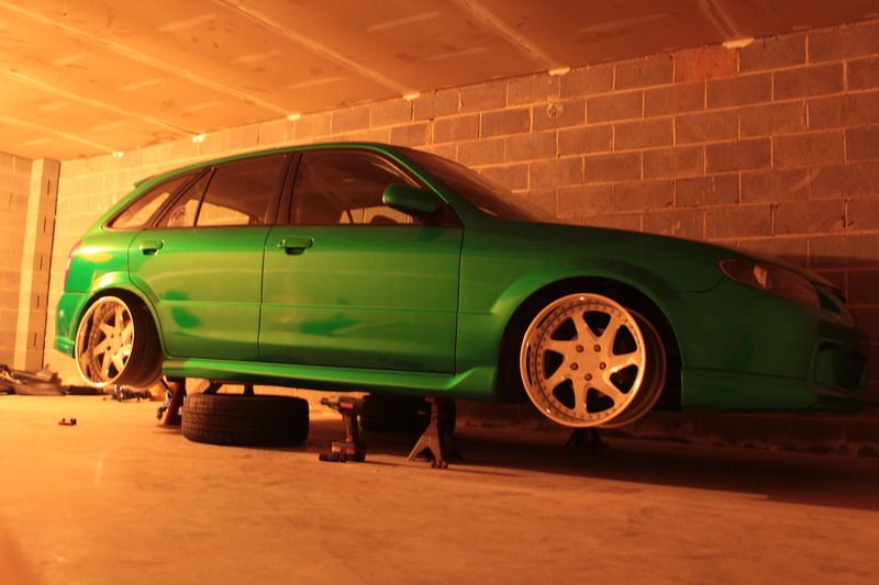

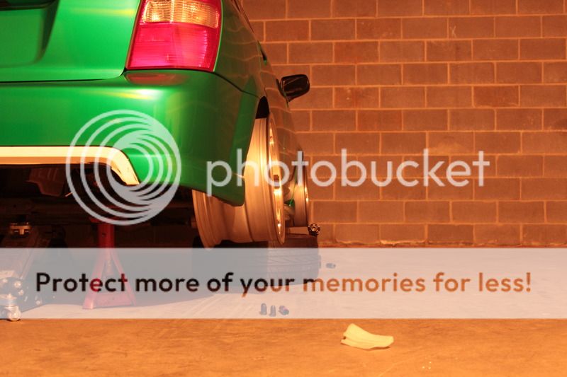

I did however finally get my wheels in. They should have been here in October of last year, but do to some delay in sourcing the barrels, they just now showed up.
Some might not like them because of how they fit, but I think they are perfect. Did a few measurements and double checked all my clearances before ordering. Size is perfect.
Ignore the white on the bumper, it was plastidipped. I pealed it off and am re-wrapping it to match the roof when I redo it as well.
17x9.5 +26 with a 3.5" lip.
