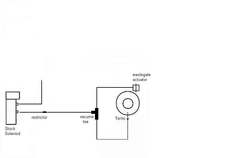

The standback controls boost via the stock silenoid. You can't hook up a Garrett turbo/wastegate to the stock control system because our stock control uses one extra vacuum line that the garrett doesn't have. If the standback came with it's own silenoid, it could control any type of turbo, like an ebc.
You can still use the stock boost control setup with the ATP turbo.
The restrictor should be close to the same size as the boost reference output of the stock turbo, but you'll probably have to play around with the sizing to get it perfect.
i wouldnt want to use stock boost control. It hasnt been pushed to the maz and it spikes. My mbc will do just fun until i get the e-boost
It doesn't spike at all with the standback. Why would you use a passive controller when the standback actively monitors the boost and corrects for changes in realtime~especially when you already have the standback.
