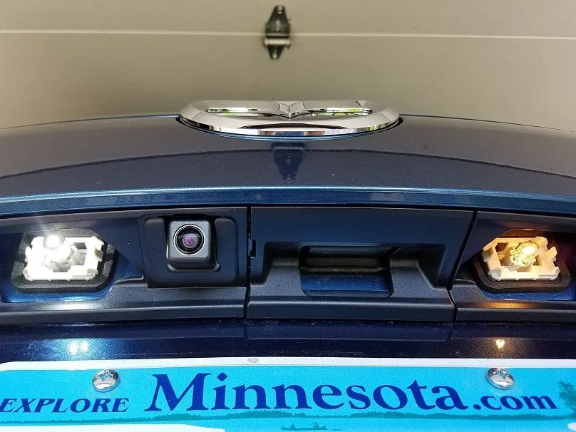

I can't seem to open my 2019 CX5 license plate lights. Can someone explain how I could open them? It looks like it doesn't have any slot on either side of the clear plastic housing as 2017 CX5 as someone mentioned on this thread.
Owners book for 2019 says they're LED makes be believe they're not made for opening up.

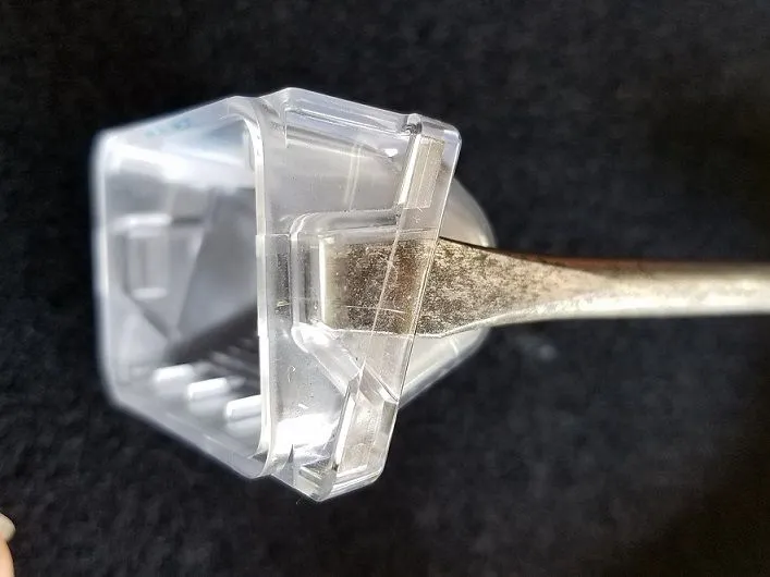

Ok, mystery solved. For the 2nd gen CX-5, the trick is to use a wide enough flat blade screwdriver - I used one with a 9/32" wide tip. Insert it into the slot on either side of the clear plastic housing and adjust the vertical angle until it's seated fully into the socket. Gently pry toward the center so that the blade expands the base away and it should let go.
attachment.php

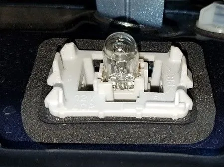

Notice the base has 2 retaining posts with a significant wedge-shaped key. I guess Mazda wanted to make sure they wouldn't fall off on their own.
attachment.php
I took a comparison shot with the stock W5W bulb against a VLEDS 194 6K bulb which I believe is this one.
attachment.php
I had retrofitted my 2015 with RED VLEDS 194 bulbs on the rear side marker and the small rear light on the cargo door and I'm sure these LEDs were a bit brighter and more saturated ruby red than the stock Mazda LED tail lights on the 2017. It may be that my license plate bulbs might be a bit too bright and overwhelm the factory red LED combo tail/stop lights. If so, then I may look at getting the longer life (and a bit dimmer) 194 bulbs from VLEDS.
IMPORTANT! When installing LED bulbs, be sure to TEST it before reassembling everything. If the bulb does not light, reinsert it the other way and it should work.
EDIT: I am clueless why my attachments aren't showing inline or my public album-linked photos don't show up. I used to be able to display .jpg attachments as a picture within the post...
It was a hell of a lot easier when I used 2 flat head screw drivers for the License Plate Light Cover, and yes, I realize I'm replying to a 2 year old post and don't expect any reply.

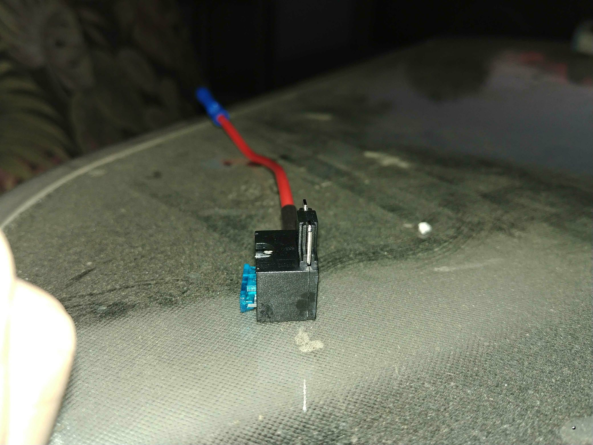

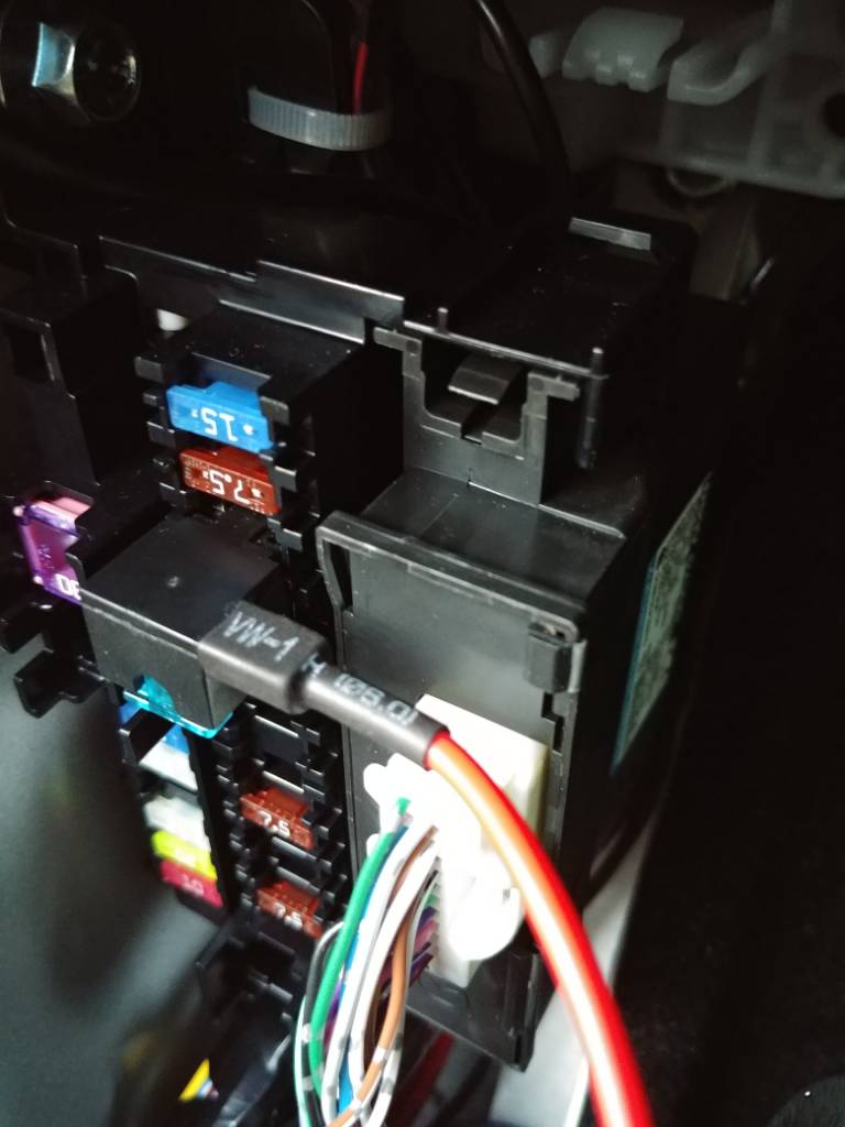

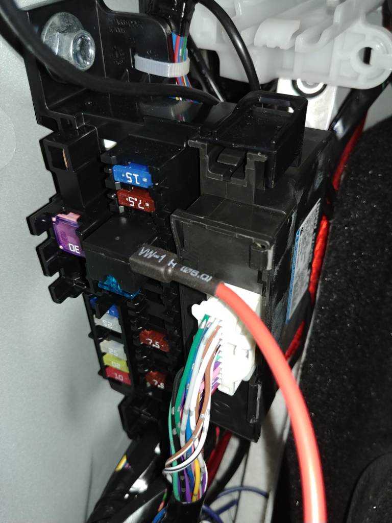

Trying to wire in some leds to the rear socket in fuse box. Using a fuse sharer. Did not work. And idk why. The adapter seemed to big.
Sent from my VS988 using Tapatalk
I had the same issue, up until recently I didn't realize there are two different types of Mini Fuses, one with elongated prongs, one with flush prongs.
