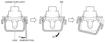

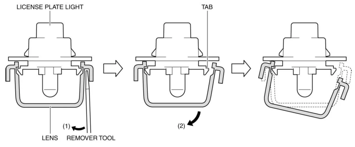

Just changed the number plate light to LED T10 and it certainly improves rear visibility at night while reversing with the back camera. Removing the plastic cover on the light was a pain in the ---. Finally got it out after seeing this diagram that was posted in the CX-9 forum.
